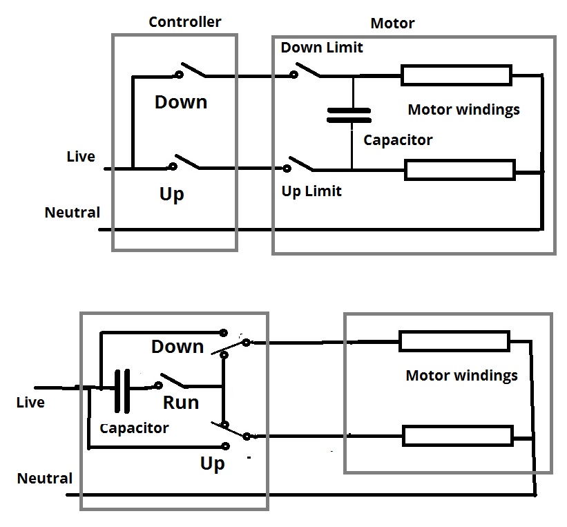

Hi there this is on private land and i will.be the only one using the gates
I have wired in the 4 cables black brown blue and earth to the terminals that the roller shutter ran to but when i activate the board all i get is a hum from the mortor and alot of heat...
Do you think this is a fault from the mortor or that the roller shutter board is no good to power the mortor
I checked what the power was that was being gave out from the board and it was 230v which is what the mortor is

They probably need start up capacitors ( normally in the controller) ....what make are the motors ?

Hi mate they are ditec motors i presume i would need i total diffrent board as the board for the roller shutter has no way of setting any limits as the limit setting on the roller shutter is done on the mortor its self
I am not putting these on large steel.gate there going on very thin wood panel gates it just to close off a area of land there is no way anyone is gonna get crushed and killed by this setup.... and i have never said that im.not gonna fit any sort of safty setup ive just ask why are the motors not powering up just humming
Probably because ( if I read you right ) you are trying to power a motor in an under ground gate operator from a controller designed to drive a roller shutter motor.
Roller shutter motors are very different both mechanically and electrically from the motors used in under ground gate operators. Hence the controller for a roller shutter motor cannot be used to control the motor in an under ground gate operator.
Ok thats fair enough i just though if the control unit was giving out 230v then it would at the least make the motor turn but i suspect the underground mortors need the
capacitors that the roller shutter control but does not have
The motors will have at least two windings. One winding has to be out of phase with the other to create a rotating magnetic field to cause the rotor to rotate. Putting a capacitor in series with one winding while the other winding is connected directly to the supply will create that phase difference and hence the necessary rotating magnetic field.
The capacitor can be in the motor or on the control board.
When the capacitor is in the motor there will be three wires, Neutral, Live for UP and Live for Down. To move the notor Neutral and only ONE of the Lives are needed. Connect both Lives at the same time to Live and the motor will not rotate. Provided there are limit switches in the motor this is the simplest method as the controller is little more than two switches
When the limit switches have to be external and not built into the motor then the capacitor will be on the controller with more complex switching. Again three wires from the motor to the controller. One wire is Neutral. The other two are Live direct and Live via capacitor. Direction of rotation is set by which is Live Direct and which is Live via capacitor.
The effective circuit of two windings and one capacitor is the same for both methods.
