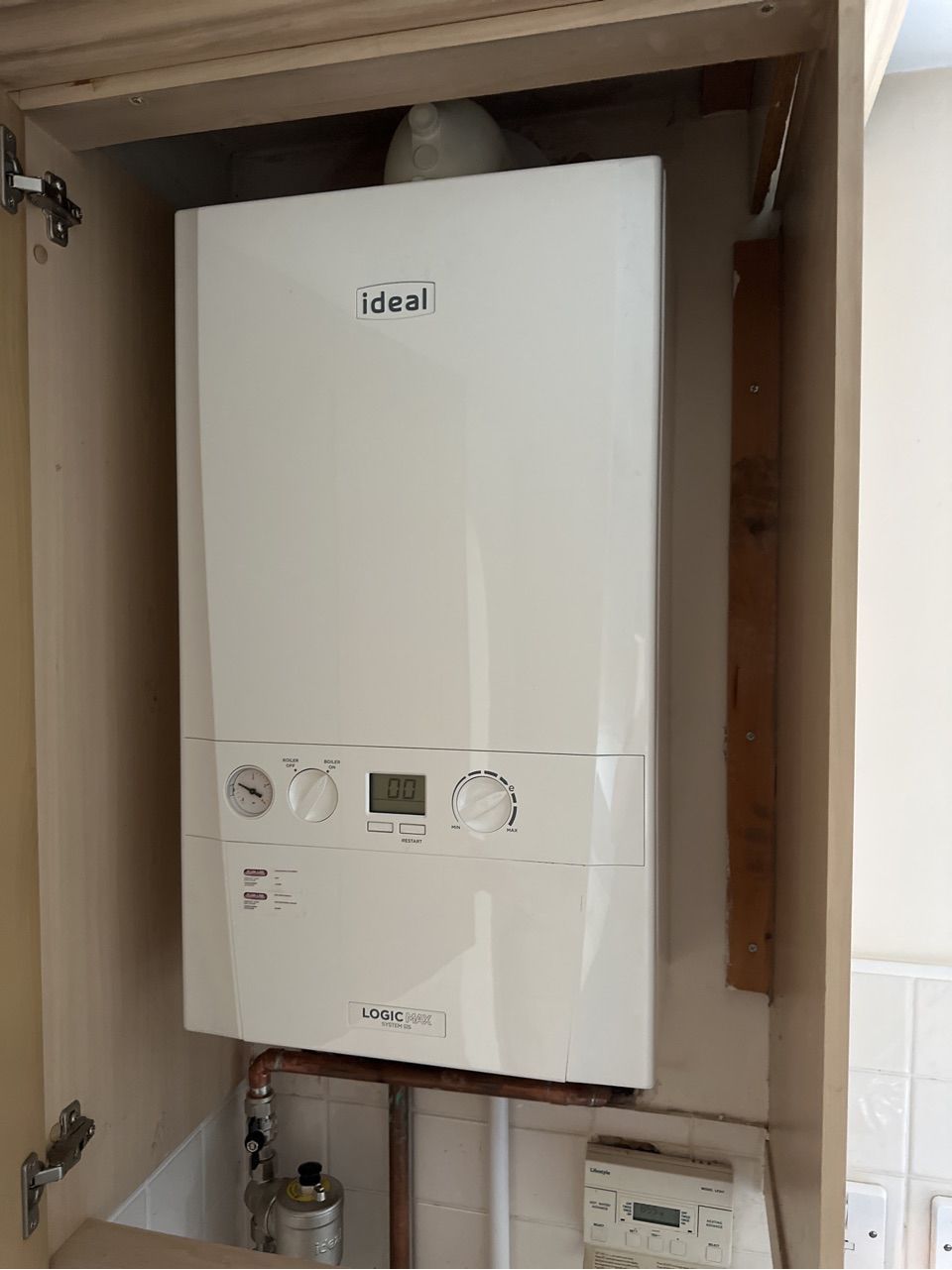

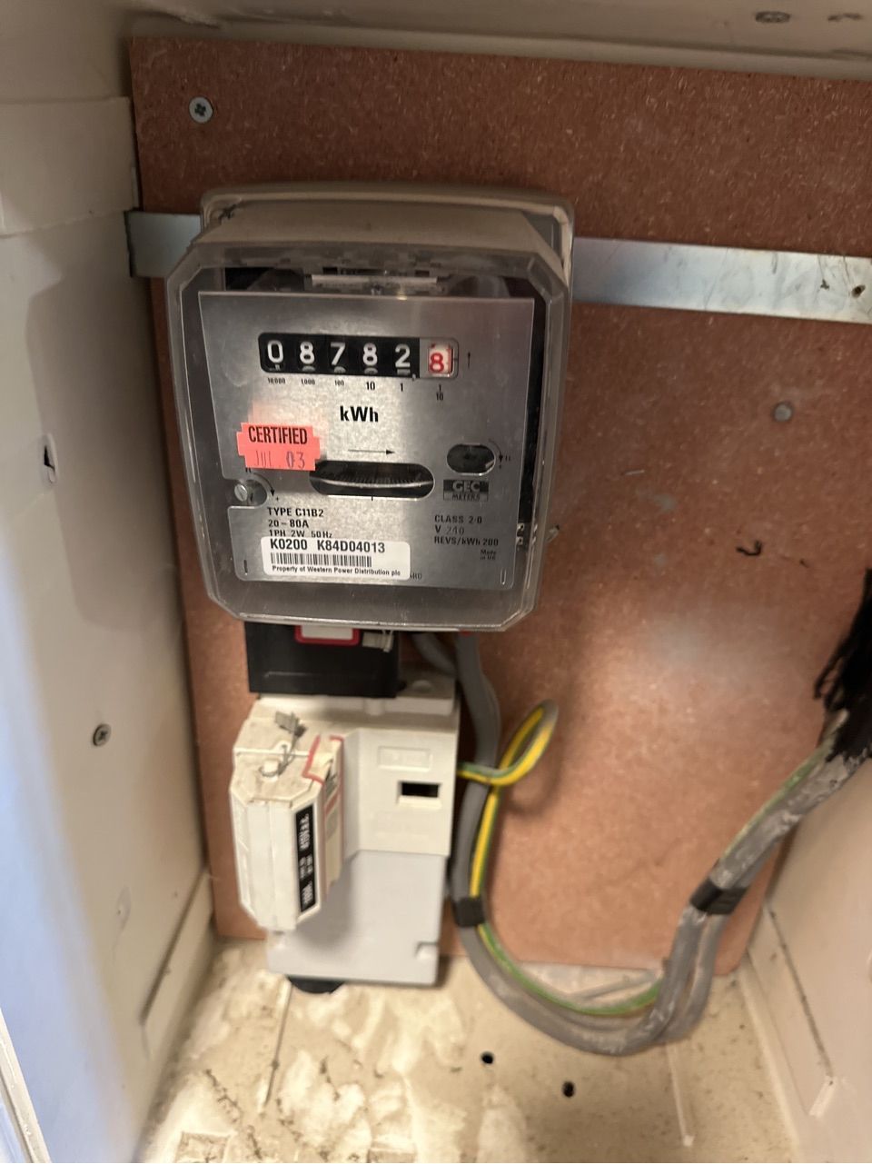

Hi,
First of all apologies for having zero knowledge about any of this… But our energy bill was through the roof this month.

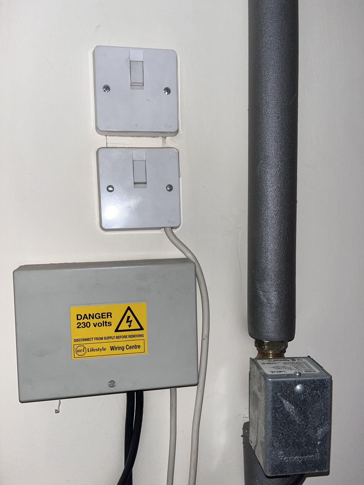

Both these switches by the main boiler in cupboard were on. Then there’s this other one in the kitchen. I just need some understanding of how this set up operates.
First photo - Electric meter

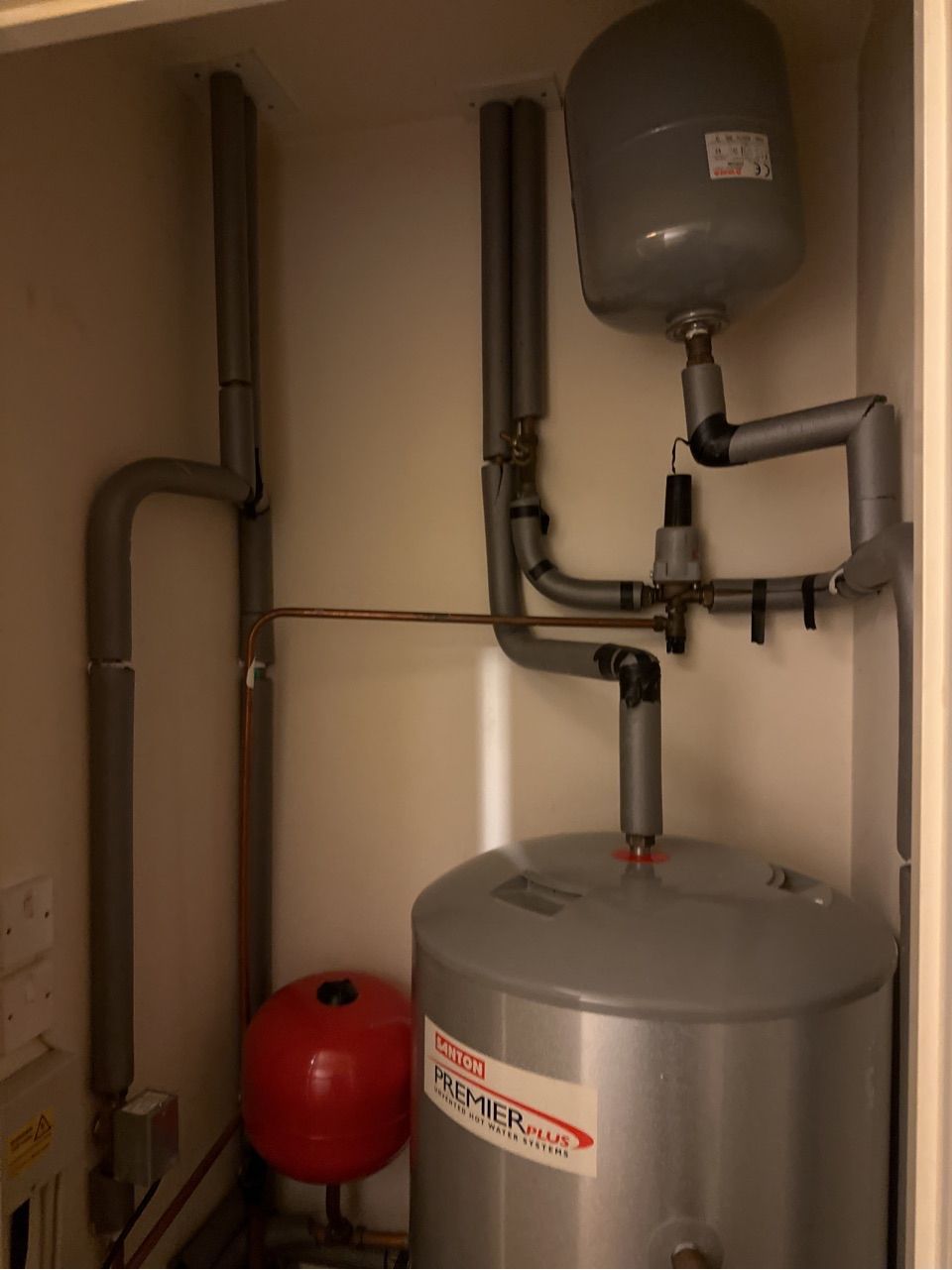

Second and third - heater in hallway cupboard

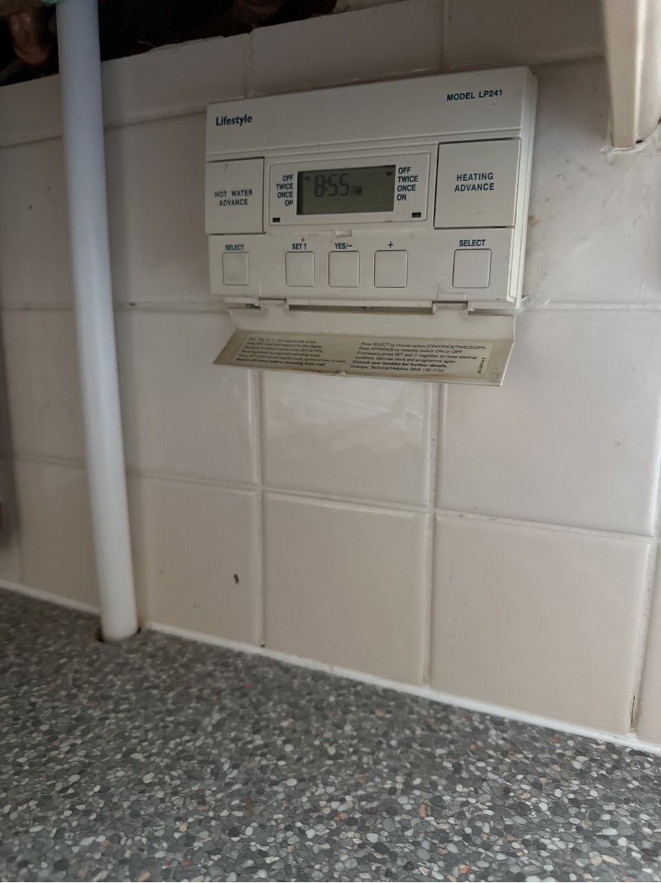

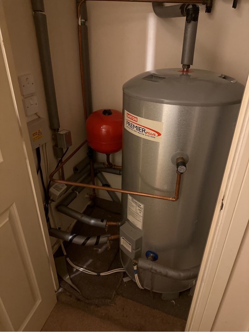

Fourth and fifth - unit in kitchen

As for the switches, do you suspect these are for a immersion heater?
If so, check them out.
Sorry maybe you misunderstood. I’m wanting to know in detail how my set up functions. I’ve seen stuff about economy 7 but clearly I’m not on that.
Is it your electricity bill that's high ?
Your hot water cylinder has 2 electric immersion heaters, expensive to run, and are controlled by the 2 switches on the wall. In your pics 2&3 ,just above the yellow labelled box. One of the switches appears to be on.
Electric was £105, gas was £90. This is for two of us in a two bed flat. I was told gas is cheaper since we lived before in an all electric flat, which was much cheaper each month.
Shall I turn both those switches completely off?
Actually ,not too sure if there are 2 immersion heaters,possibly only one.
Is the bill estimated ? Is it your first bill ? If so ,did you take meter reading when you moved in ?
Heating the domestic hot water by using the gas boiler is cheaper than electric immersion heater.

It’s not estimated. Second bill. Took readings when moved in, first months was fairly high too… So we can turn off the immersion? We have two bathrooms so will the gas boiler in kitchen do everything? Sorry for so many questions

Make sure your immersion heater is off unless you need a boost, or, the boiler is heat only in which case being careful with the times is all you can do.
As the poster above says, you have usually two electric heaters in an immersion system. One at the top, one at the bottom.
The top one is for sinks, the bottom one for baths.
Select as required.

Yeah this was my question, I can just turn off both switches seen on left in picture #2?
No electricity alone isn’t that of course…

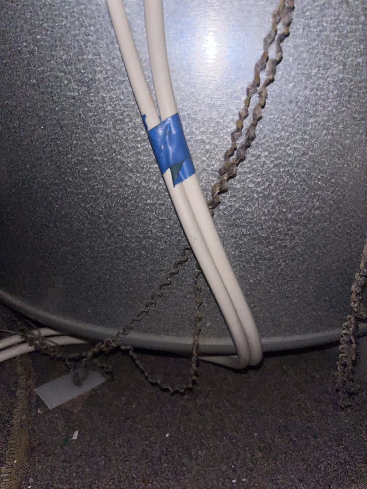

Show us a pic in focus of the two switches ,and the 2 white cables dropping from their vicinity ,one comes from one of the switches ,where does the second wire come from ?
Thanks ,only one immersion. Not sure what the second switch does ,maybe nothing, would need to see the wiring connected to it.
Do you know how your set up works now ,or need it explaining ?
