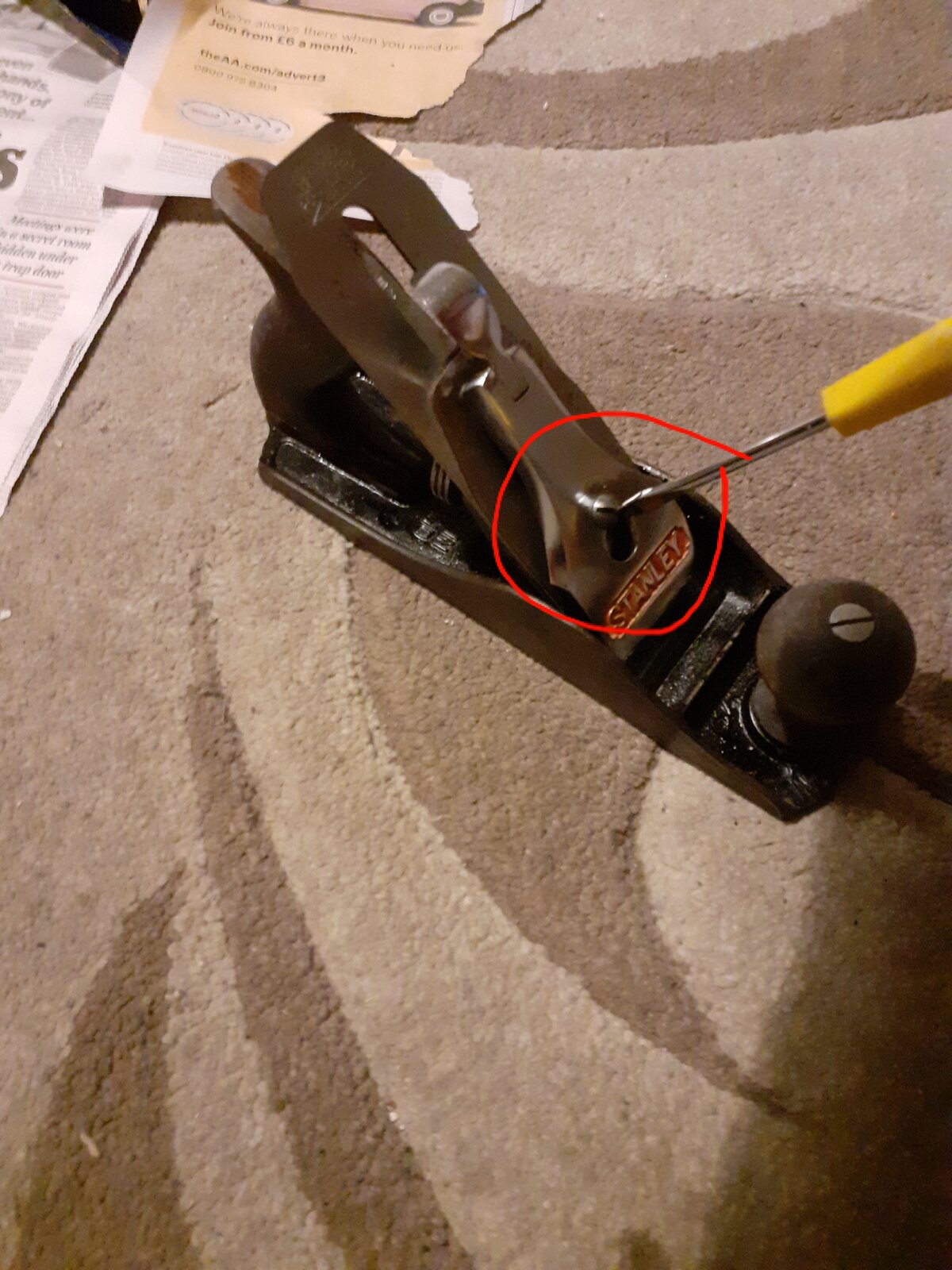

Read through this thread again and I'm ok with my block plane (great advice on that) but got a question about my smoothing plane.
Is it the case unlike the block plane that when moving the blade out from the sole there's NO need to slackened the nut (circled in picture) then when protruded enough NO need to then tighten nut (circled in pix)? I know this is what you do with block plane.
No, once the screw is set (which means it shouldnt be lose or tight) it should allow the blade to move smoothly without keep tightening and slacking that screw of.
It should allow the blade to work but not so slack that you get marks from the blade vibrating
