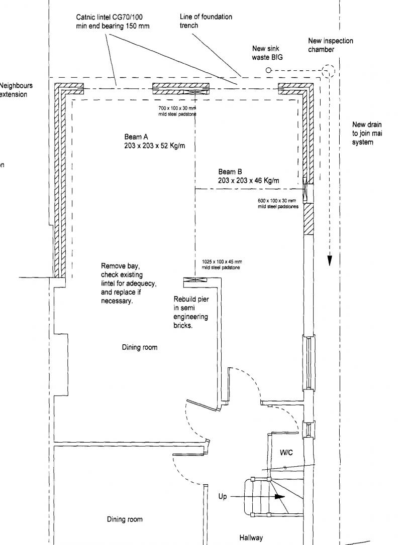

There are 2 RSJ's fitted in a T shape - a 4.9m (203x203x52 UC) supporting the length of the back bedroom and a 2.65m (203x203x46 UC) supporting the width of the back bedroom. The smaller one should have been bolted into the middle of the big one.
Having had other problems with the builders who fitted it, I called LABC who said they never received the Calcs and therefore the Inspector didnt inspect the RSJ's! I'm therefore a bit worried that the RSJ's may not have been fitted correctly.
For example, I know that the end of the 4.9m resting on the external extension wall is not on padstones, but on engineering bricks, and could be the same with the other ends of the RSJ's. I also have no idea if they were bolted correctly, although as far as I can tell there is no cracking in the upstairs bedroom.

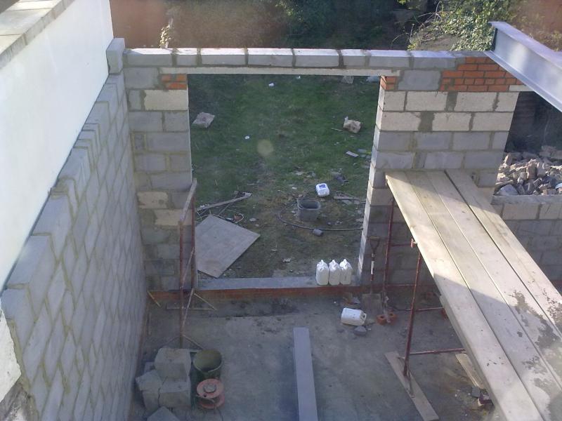

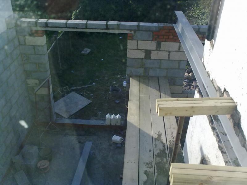

Also that steel really doesnt look like a 203x203UC52 looks more like a 203x102 or something.. this would mean you would have alot more deflection in the beam.. seriously think you need to get a structural engineer out to look at it, preferably the one who designed the steels..
Also get the building control involved they are there to help.. may need to open up ceiling to see connection between the two steels..
The perspective of the images seems to be making things look out of proportion
The outer wall blocks look like solid 9" not cavity as per drawing, and the beam looks like a deep 305x165 or 356x171
You're right. The contractor disregarded the plans. I confronted him recently about this and he just said that the builders had license to disregard the plans as and when they went about their job and that they were just general plans (or some other rubbish like that).
I'm getting suspicious now that the builders may have disregarded the Engineers Calcs in the same way as they disregarded the plans. Seeing as LABC didnt inspect the RSJs, I have no way of knowing what size beams are actually there! (let alone the issue of the padstones etc)
What would be the least intrusive method of exposing the RSJs for inspection? Coming from the kitchen upwards would require cutting the plaster and plasterboard, removing Kingspan insulation.... or from bedroom upstairs, lifting carpet and skirting - would that work?

Looking at those images your so called builder is either a gardner or a diy'er and has probably never heard of 'building control'.
That job looks self-built to me.
Who is talking to Building Control, you or the builder? A builder can start and finish a job and get paid without them even knowing the job has started.
They normally only come out when you call them.
Transpires he subbed it out to a very experienced builder with a very crap reputation. His work is atrocious - I need no convincing.
