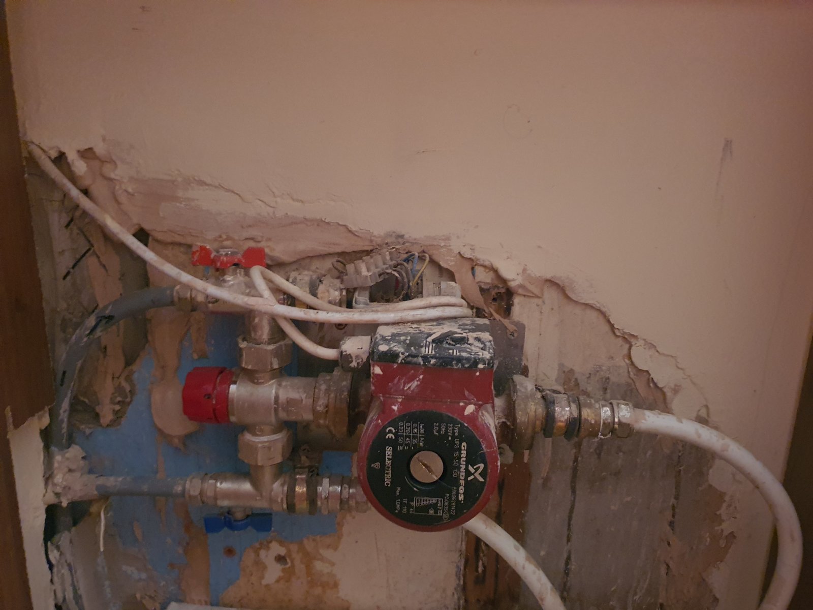

One room was renovated and was fitted with underfloor heating. The company connected the underfloor heating pipe which is a 100m 15mm to the existing radiator and installed a pump on this. Everytime the pump is turned to its maximum setting this room warms up, but the rest of the house is deprived with heat.

The UFH install sounds like a massive lashup as well- take it there's a single loop, no manifold, no bypass? If you isolate the UFH entirely (are there valves after the thing is teed off the rad) does the rest of the house heat up properly?

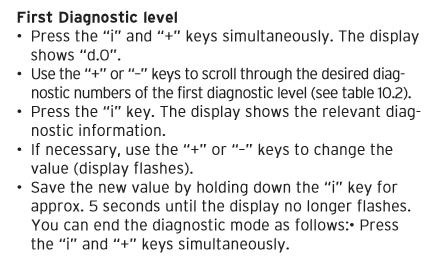

Try this... get the instruction manual for your boiler and find out how to get in to the D codes, when you have go to D0 and reduce the output to 24 and see if your rads heat any better, chances are that you will have to upgrade the pump regardless.

I have not got the manual to look up the codes.

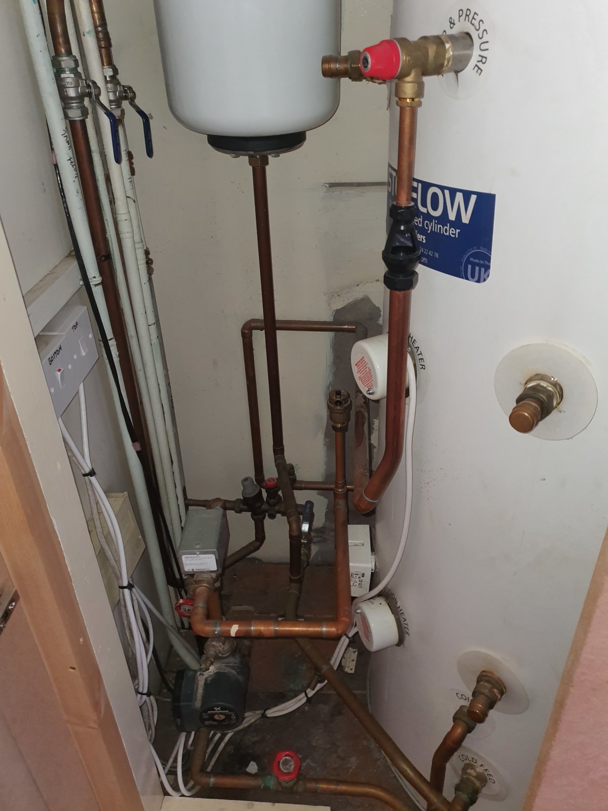

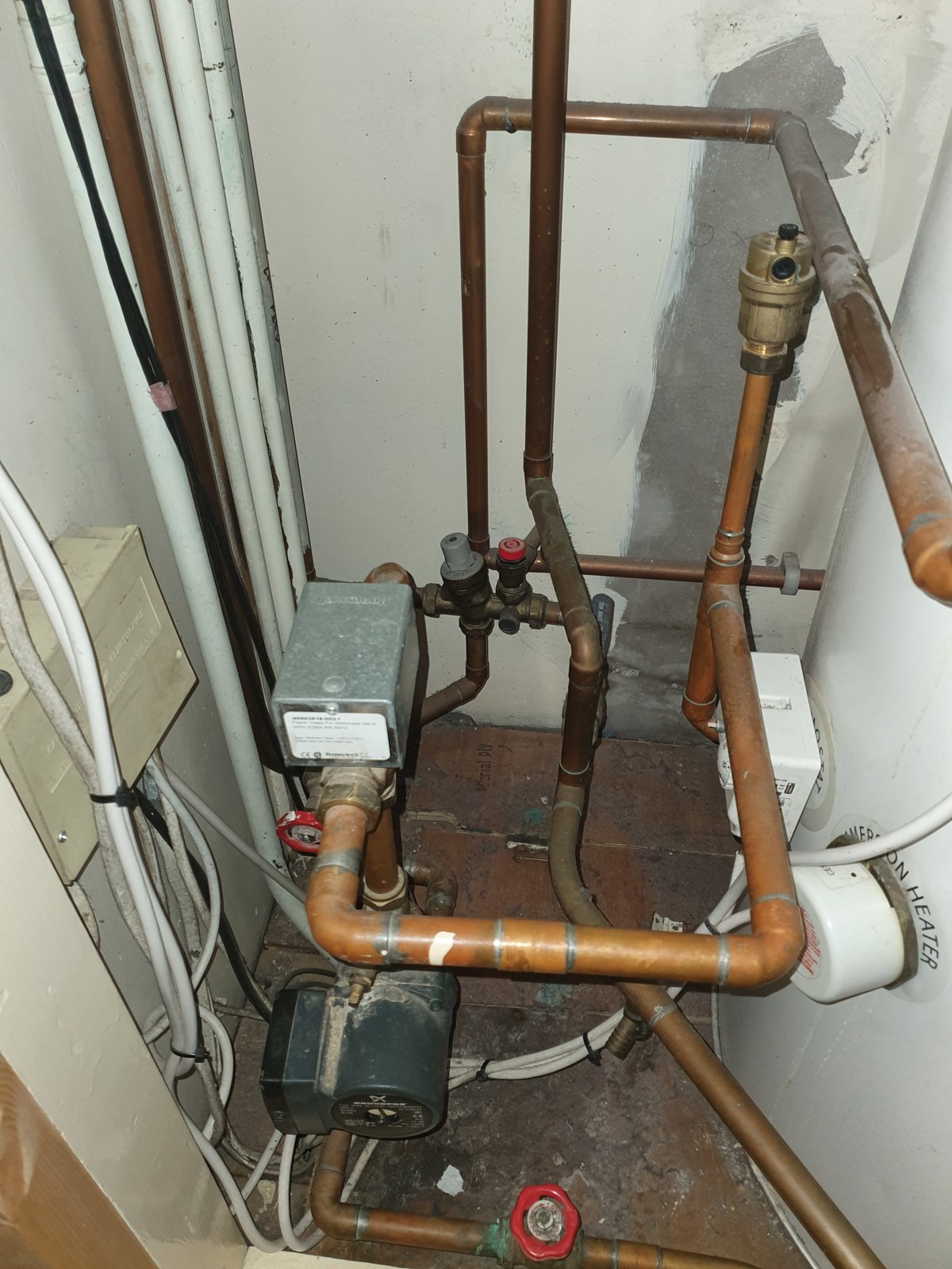

I have attached some photos of the pump and the cyclinder.

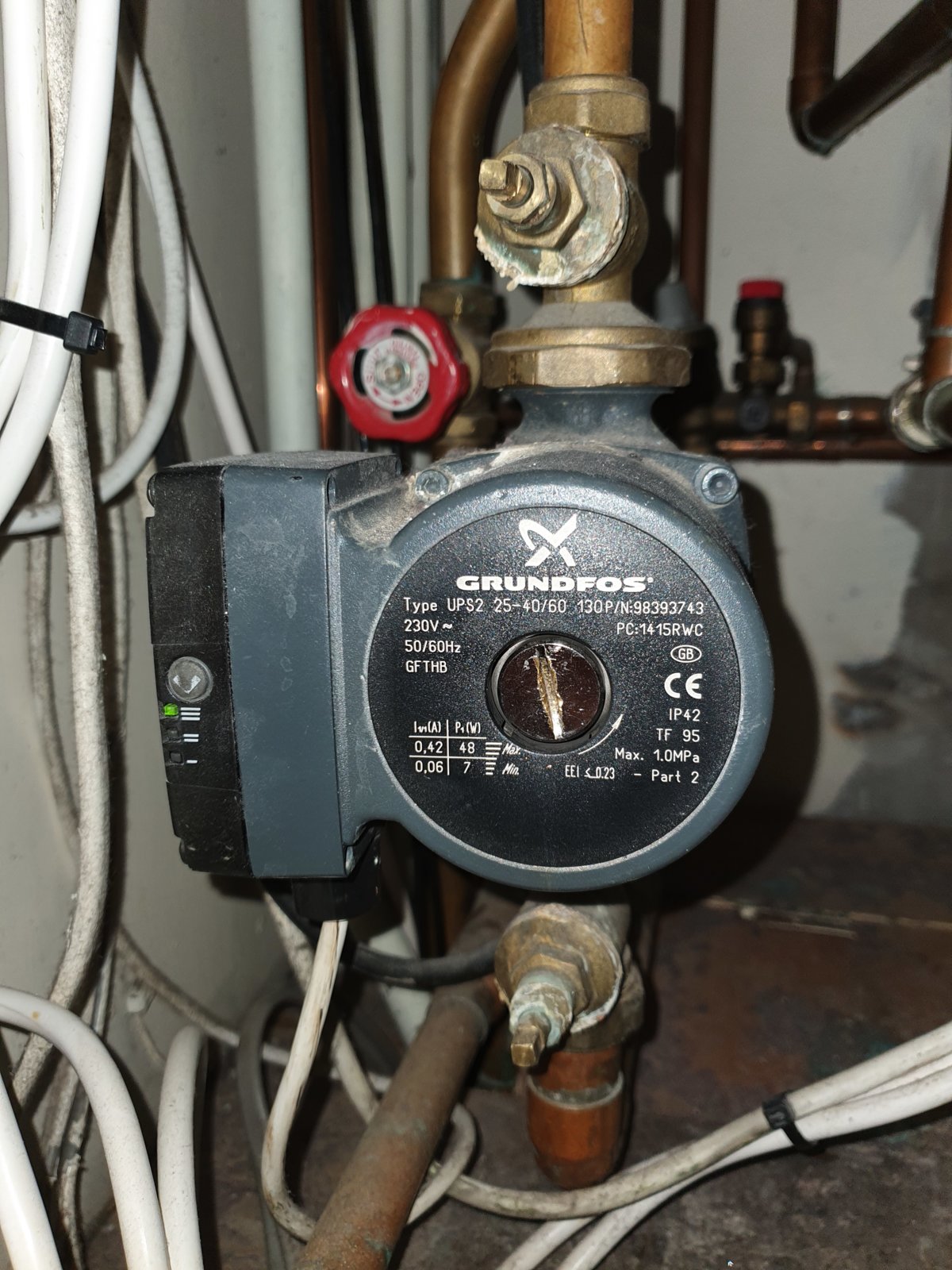

Can you post a pic of the front of the blue pump ? does this help ?
Hi yes it does help, I will try that and let you know of the outcome

Yea pumps not man enough for your system, once its overcome the resistance of the boiler heat exchanger there is not enough oomph to push the water against the pipework resistance, as I said earlier close coupled tees or a low loss header,
