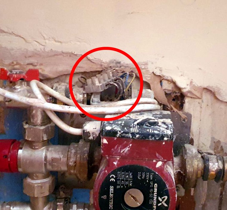

The UFH install sounds like a massive lashup as well- take it there's a single loop, no manifold, no bypass?
Where would I install the manifold and thermostat to this now? Next to the boiler or in the UFH room?
Its not really a diy project, get your self an experienced heating engineer that has installed llh before.
This mess needs to be sorted as a priority.
Live electrical connections exposed.

No one suggested changing the boiler, was the blue pump changed ?
The blue-grey pump would have been supplied with the UFH, and the red one that's connected to the UFH is the original system pump (manufacturing date 2008). Looks like they realised there was a problem when they installed it and swapped them over to try to mask it. Good to hear it's all sorted
Blue pump was not changed. Red pump got taken off and re installed with venting bottles.
