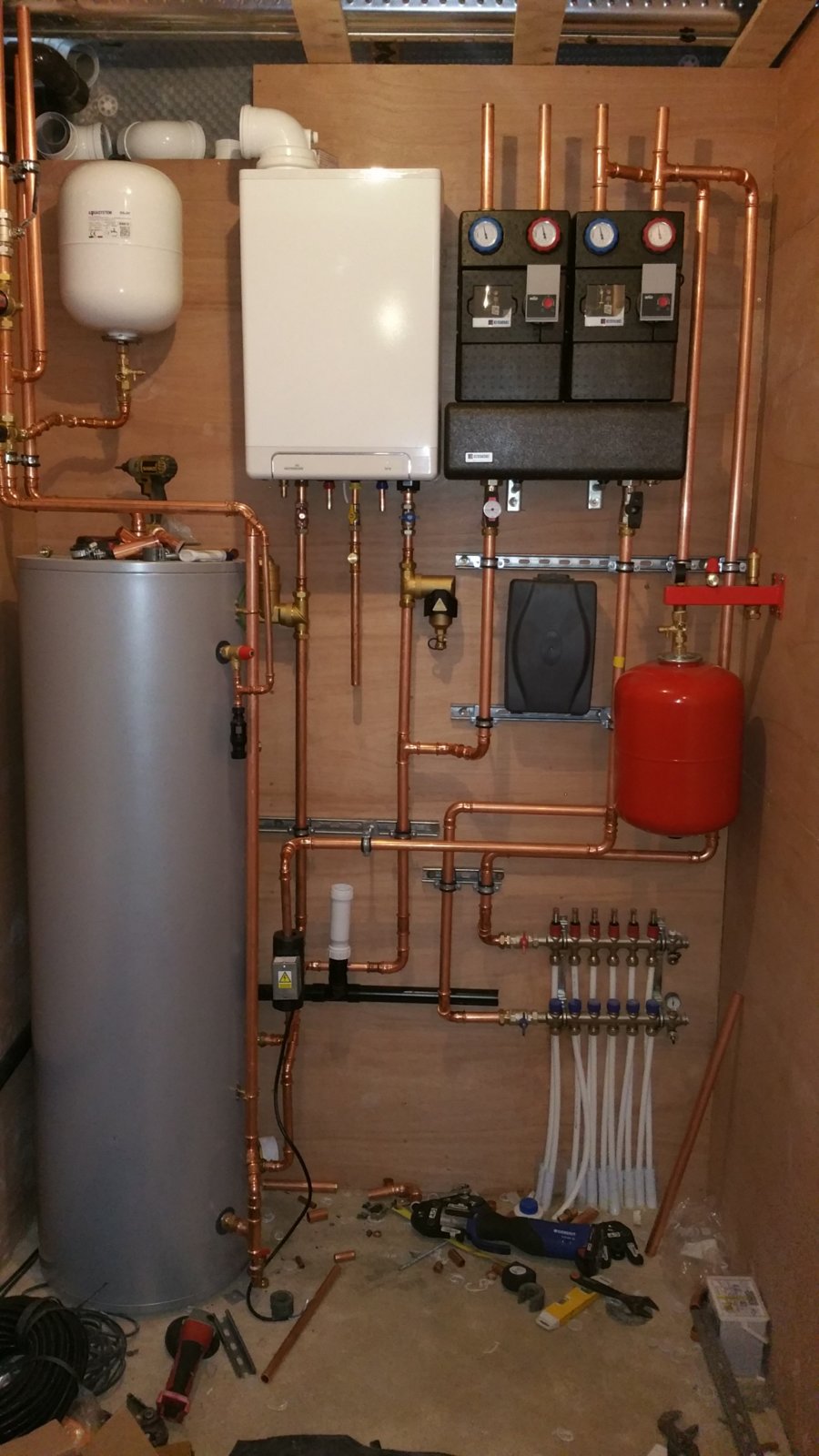

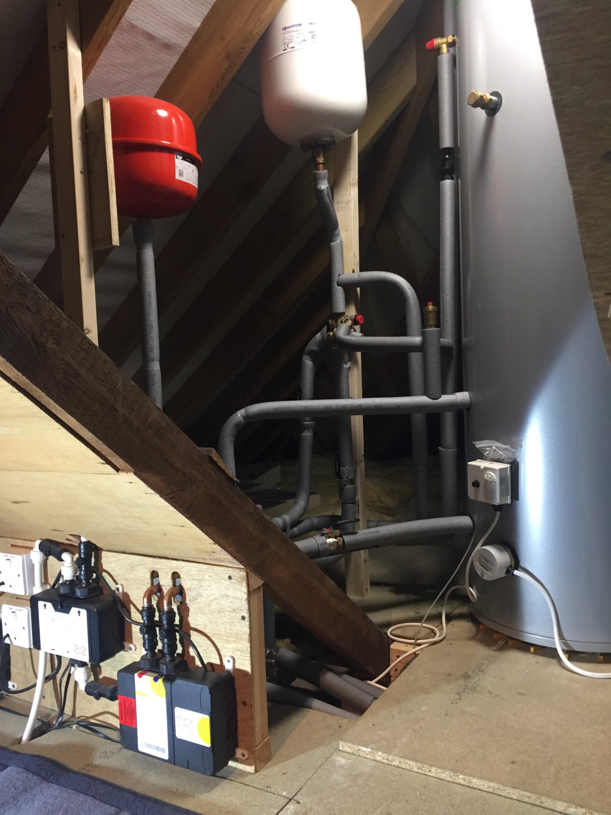

The OCD in me loves those installations.
Do you leave them open like that Dan or do you put insulation on afterwards like dilalio?
I leave it up to the end user. If they want to pay me to insulate it then happy days :D
