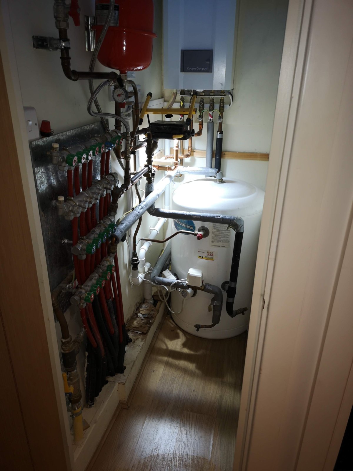

Unvented pressure release into sink waste pipe - smelly
OK, this is what he did for us :-
Pressurised the heating system
Replaced our vented system with an unvented cylinder
Apart from the smell all seems to be working well without issue.
Just a thought - was we supposed to receive a certificate of some kind ?
Yes, the cylinder needs to be registered with Building Control and you should receive a compliance certificate. It also needs registering with the manufacturer for the warranty
ok, registered for warranty but didnt get any BC certificate. Looks like another plumber on the scrap heap ffs. I guess I should get a proper G3 plumber in to check it all over and get it registered ?
However, is not true that if the plumber is G3 then BC is not required ?

So I guess all is cool and I should simply get him back to fix the smelly pipework / tundish.
No. His G3 registration allows him to self-certify with Building Control without a BC inspector coming to assess the work. The installation still needs to be registered
