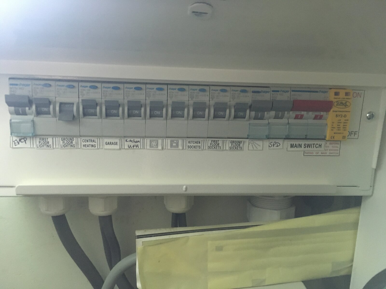

In terms of the cable, we had new 10mm ran to the bathroom when we had a full house re-wire 3-4 years back, in anticipation of eventually upgrading the shower one day, so that's no problem, however from what I can tell, we only appear to have a 32a RCBO in the CU for the shower? I'm guessing this was deemed more appropriate by the electrician for the shower we already had.
Anyhow, is this something I can change myself or is it notifiable?
In my head, I'm thinking purchase a like-for-like Hager 50amp type B RCBO, flick the big red main switch on the CU, and literally just swap it out like-for-like, and it will be a 2-minute, easy job.

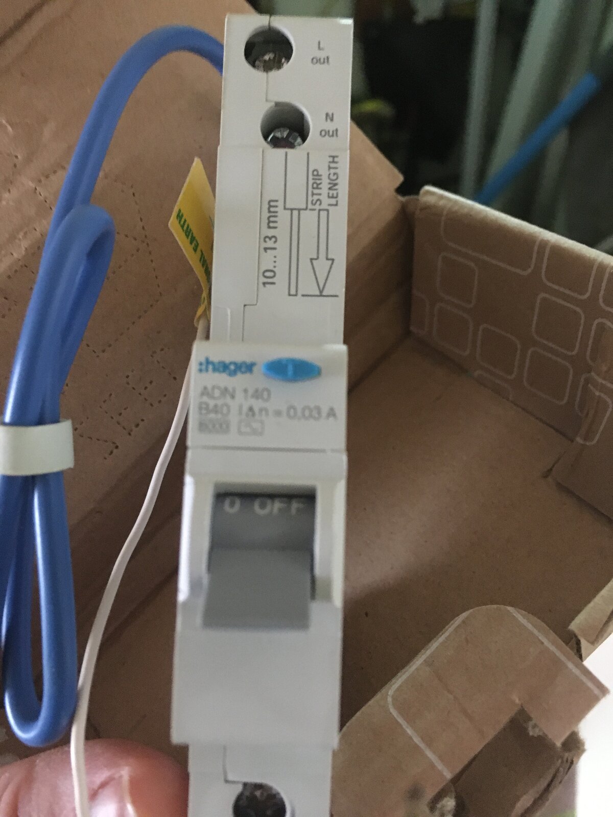

Also, just to make decision-making that little bit harder, there is a brand new, spare Hager 40a RCBO in a little box box sat on top of the CU. I'm guessing this still wouldn't be enough for a 10.5kw shower, but it's making me wonder if it was left there when the CU was installed, just in case I eventually decided to one day upgrade to a 9.5kw shower (as opposed to the 10.5kw one I'm looking at right now).
So am thinking, maybe I should just use this spare 40a RCBO, and install a new, lower-powered 9.5kw shower (presumably which will still be better than what we have now.... although I've read reviews of people buying modern showers, complaining that the flow wasn't as good as their older, previous models of the same KW rating?) or instead go with the 10.5kw shower (presumably even better still) and just get myself a brand new 50a RCBO?

Yes, 40A will only allow you 9.5kW, so may as well get a 50A as you have the cable for it (assuming it was installed correctly).

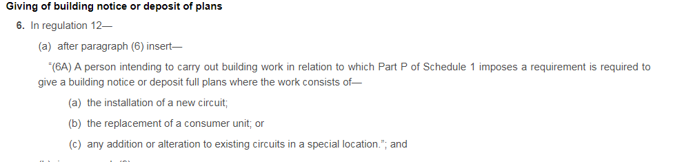

This is what I found online....
Notifiable electrical work
Because of the safety risks associated with electrical work, the following areas all count as notifiable work, under Part P regulations in England:
- installation of a new consumer unit (fuse box)
- installation of a new circuit
- circuit alteration or addition in a bathroom or shower room (specifically in the area around the bath or shower), or in a room with a swimming pool or sauna
- a full rewire
- a partial rewire
- a full new electrical installation.
Is swapping out a 32a RCBO to a 50a RCBO considered circuit "alteration"?
Where I'm going with this is..... would that mean that I could happily swap one 32A RCBO for another 32A RCBO (not notifiable) but swapping a 32a RCBO for a 50a RCBO would be notifiable??

That is not correct - either out of date or wrong.
This is all there is now in England:
Special location is within the bathroom zones.
Is your wiring within the bathroom zones?
Make up your own mind within the required conditions.
If not within the bathroom zones - i.e. lighting circuit more than 2.25m from the finished floor level then it doesn't matter.

Says who / what? It would only be notifiable if it were regarded as "installation of a new circuit", and I really don't think it qualifies as that, hence I would personally have to say that it's not notifiable..
, but can't seem to get clarification if changing from one RCBO to another is notifiable or not, as it's not actually changing the protective device of the actual circuit...but then I'm not an electrician, so I can't say this with absolute certainty! :)
.... even further from being "installation of a new circuit" - so, in my opinion, definitely not notifiable.

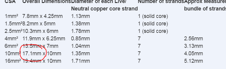

Whilst I do not believe that the change of RCBO would be notifiable, it would only be acceptable to make the change you propose if the cable of the circuit is suitable (sufficiently large) to be adequately protected by a 50A RCBO - and since it is currently a 32A circuit, it's quite probable that such may not be the case - in which case it would obviously become a much bigger job (replacing the wiring).
Do you know what size cable is currently being used for the circuit?
Kind Regards, John
Thought I’d quickly double-check to put my mind at ease. This is a photo of the cable currently running up in the loft across to the bathroom…
