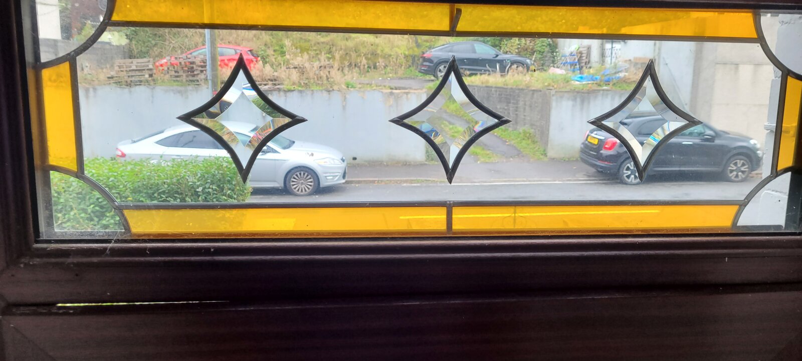

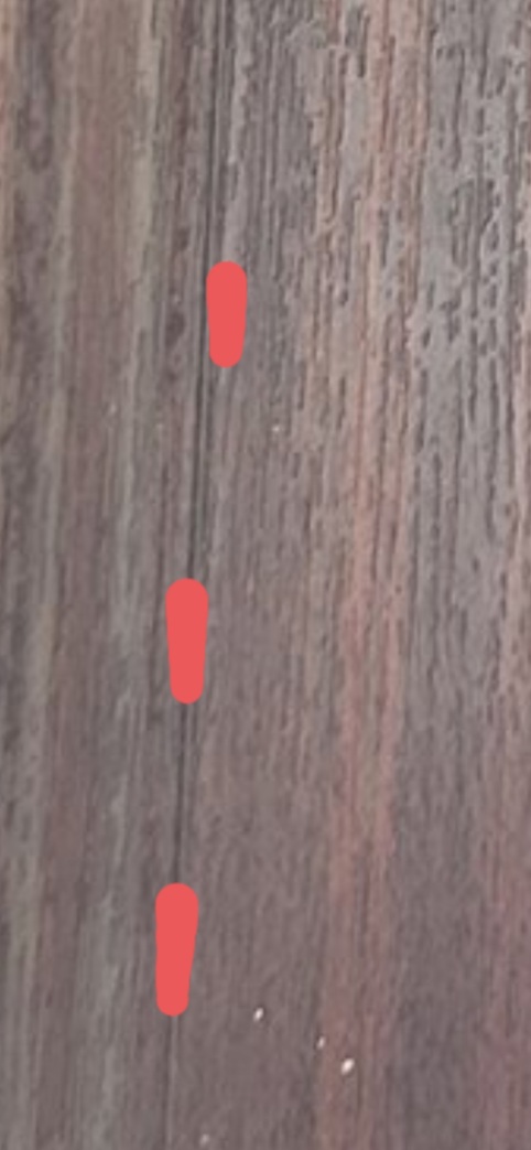

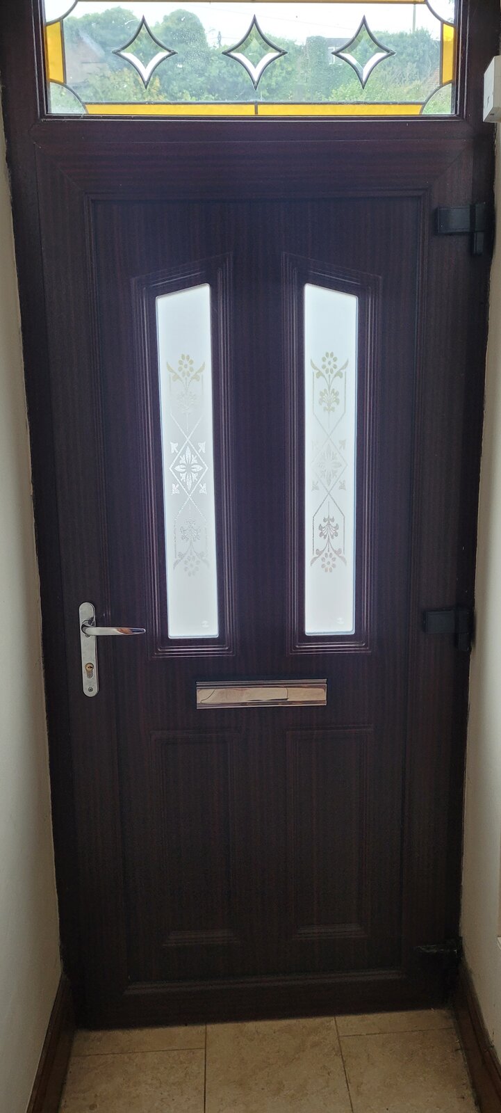

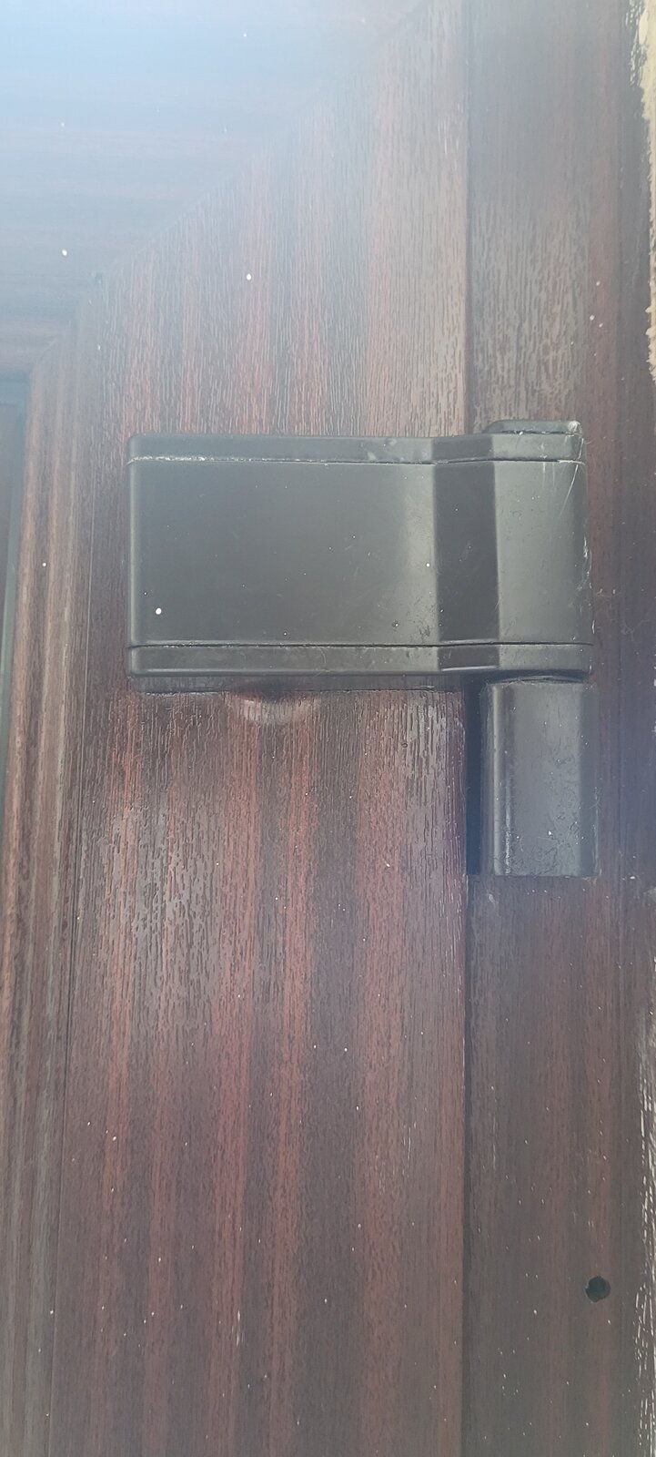

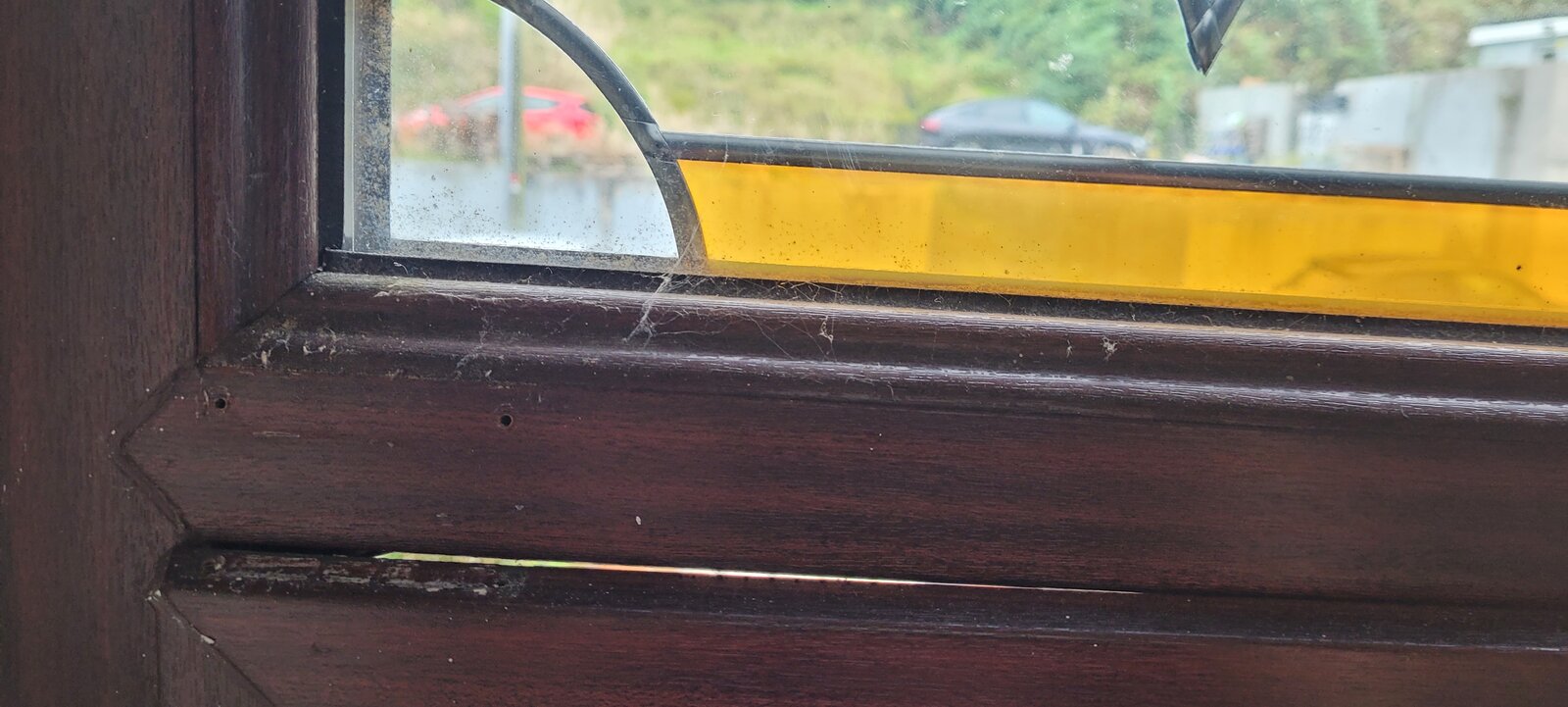

The main front door is sagging on one side (the side opposite the hinges). It leaves a big crack at the top where you can see in/out and leaves a huge gap for cold air to enter the house. There are 3 hinges (not sure what type or what they are called?!).
Any suggestions on how to fix this?
I've attached photos of the door, the hinges, and the gap for reference.

Have a search for "heel and toeing" on YouTube - example here...
Your hinges (and door surface) look like they have suffered a little from the door sag - they may need some adjustment, once you get the door back to square.

I have looked up some of this, but they all seemed to be on full glazed panels. This door looks like virtually the entire door is a 'panel'. Does this mean I'd need to take out the entire door to do this?
And does this only raise the one side then, as the other side seems fine?
You don't need to remove the door.
Your door is similar to the ones you've seen - instead of a glazed panel in the middle of your door, you have a 'solid' one.
The beading holding the panel on, comes off in the same way (along this joint line)..
You should be able to adjust the hinges
I'm afraid that won't cure this problem, although it could lessen the symptoms!
A proper heel and toe should sort it out.
