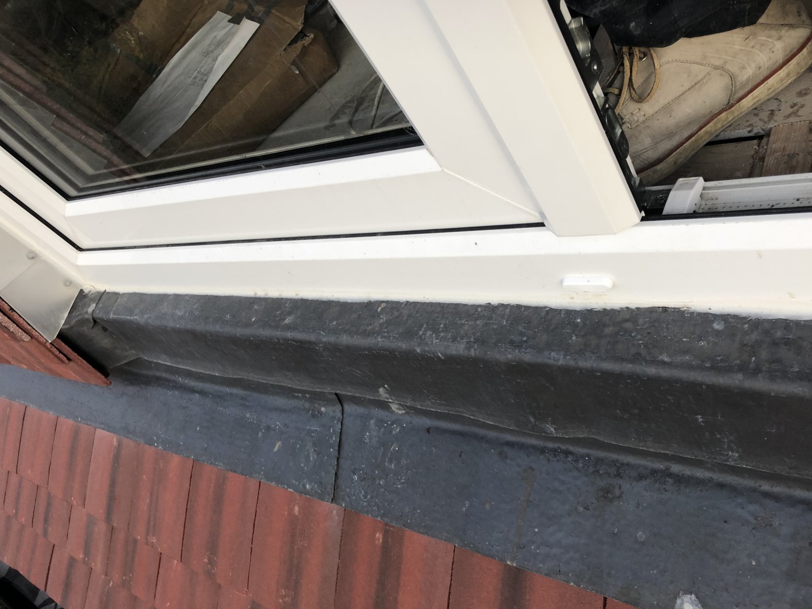

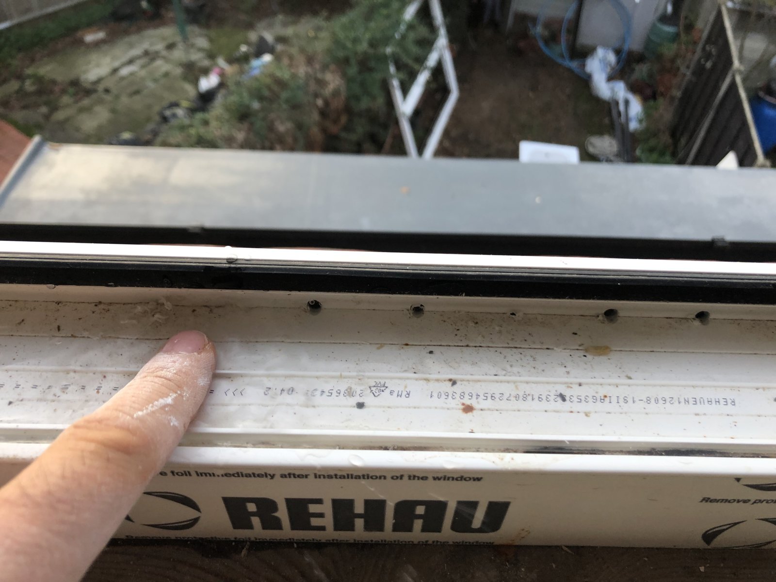

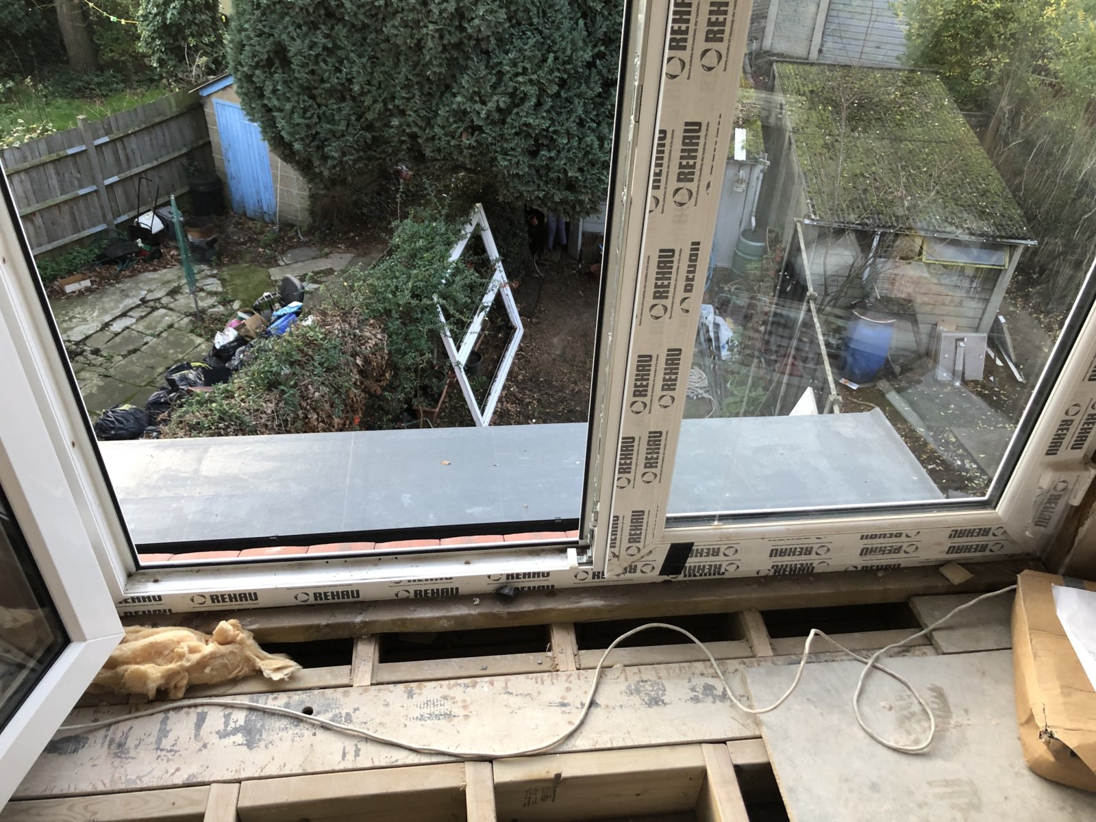

The water gets blocked inside The trim overflows and ends up in the house and doesn’t drain away outside.
How can I rectify this problem? Can I simply fill in these drainage holes with sealant and drill some new ones to the outside face?
Manufacturers are being incredibly unhelpful and unresponsive, the frame profile is Rehau.
Any advice or pointers on how I can rectify this without removing them would be much appreciated.
