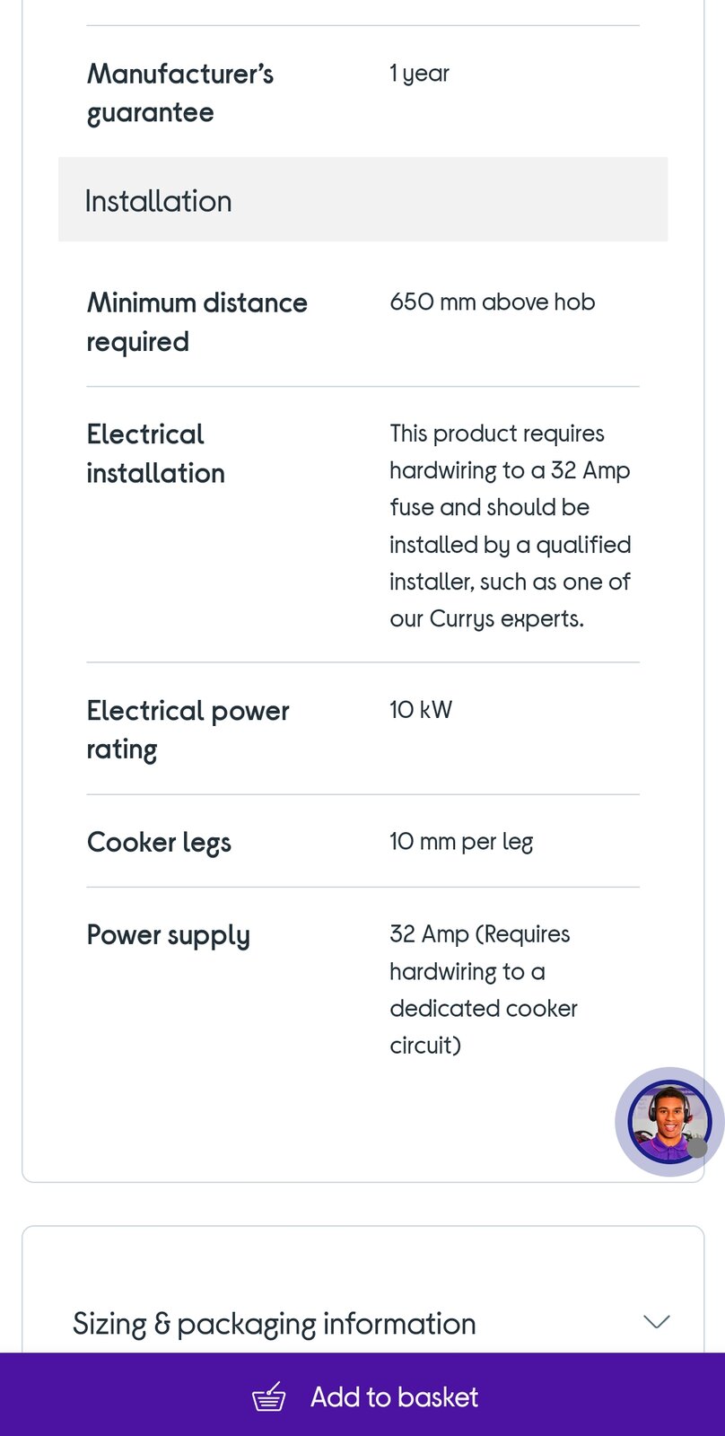

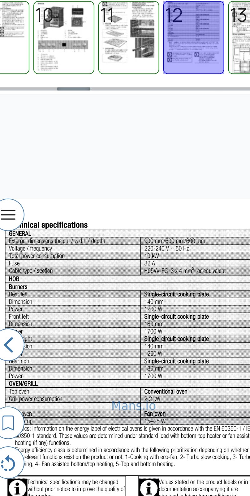

Due to move into a new place but currently have electricians doing some work . We have had a new cooker delivered and asked the electrician to fit it so it's all under the electrical cert .
House has 6mm cable on a 32amp fuse from the fuse box to the cooker switch and the distance is less than 6m.
The cooker is a freestanding 10kw(max load ) 32 amp cooker . Manufacturer states a min 4mm cable to be used .model number of cooker is beko XDC663sm.
This electrician has seen its a 10kw cooker and straight away said the cooker circuit needs rewiring to 10mm cable and 40amp fuse.
Spoke to other electricians who have said due to diversity ( no idea what that is ) the existing cooker circuit is more than adequate especially as the cooker control switch IS NOT over 20m away from consumer unit .
Any advice and thoughts would be apreciated.

The standard 32A circuits is perfectly fine for the cooker.
The only wire needed is a length of 4mm² HO7 flex between the outlet plate and the cooker.

A 32A circuit with 6mm² cable (which is actually larger than necessary) is adequate for any domestic cooking appliance likely to be purchased.
Really apreciate you explaining it in simple terms to me im going to have to speak to the electrician tomorrow , then speak with the landlord who found the electrician and raise some concerns.
In case you are interested, the general rule for diversity for cookers is the first 10A, then 30% of anything above that, and add 5A if the cooker switch has a built in socket.
10kw is 10000/230 = 43.48A
Take off 10A and 30% of rest is (43.48-10)*0.3 = 33.48*0.3 = 10.04A
10A plus 10.04A from above + 5A assuming you have a socket outlet on the switch is 10+10.04A+5A=25.04A
So in reality a 25A cooker circuit (which would probably only need 4mm given typical domestic installation methods) would be sufficient, so there is no issue with your standard 32A/6mm cooker circuit :)
