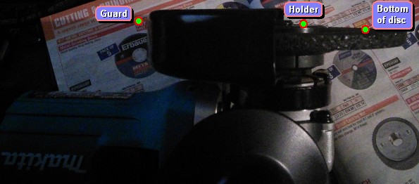

When I connect everything up and put the disc on, the metal centre holder protrudes out of the bottom - it's about 5mm lower than the underside of the disk - so it seems that I must use it at an angle.
Likewise the guard of the angle grinder is about 10mm lower than the bottom of the disc, so there'd be no way that I could do what the guy in the video was doing.
Am I missing something?
Is there a way that I can use my angle grinder as a sander, but on the level - like, at an angle of 0 degrees, rather than the 15 degrees the manual says?
Can you buy a special disc that enables any angle grinder to become a sander that you can operate level / flat?
I could remove the guard, but that doesn't seem sensible!?! But I'd still be left with a disc that is higher from the surface than the centre holder is.

You are using a flat grinding wheel, presumably....whereas a depressed centre or dished wheel would do what you want.
Mind you, anyone who can use an angle grinder as a sander must be a bloody genius!
A sanding grit disc, complete with a plastic backing disc, would be better, but If its largely filler you need to remove, why not use an orbital sander?

The discs I've bought were the only stone grinding option in Screwfix. Item 61431... Erbauer. I wanted the flexovit ones that I saw in my version of the catalogue, but when I got to store they were not in the catalogue there. I couldn't see anything else that seemed applicable.
The discs do have a depression in the centre, for sure, but they're not what I'd describe as conical in any way.
The ridges I want to get rid of are the original column, not filler, you're correct that the sander works fine for the filler... this stuff, I presume, is concrete. If I grind it away, I expect I'm going to want to sand it smooth(er) later.
Maybe I should have bought the Grinding Cup, 58310, for £23... it's in my version of the catalogue, not sure that I saw it in store and it's next day anyway. Says it is good for rapid removal of concrete. Looks more conical than what I have, for sure.

I'm going to head over to Toolstation later this morning and try to pick up one of item 62515 or 36681...
http://www.toolstation.com/shop/Pow...te+Grinding+Disc+100+x+22mm+Single+Row/p36681
...unless anyone helpful on here decides to warn me against it... it's what was returned when I searched for "grinding cup" so I'm hoping it is higher than the discs I have, although there are no dimensions for height provided - I'm assuming 100mm is outer diameter and 22mm is the inner diameter?
It says "For the rapid removal of concrete..." and I'm hoping I can use it 'on the level' so to speak.
