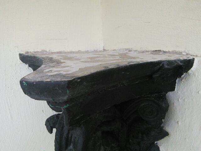

I've returned from Toolstation and I bought the double row blue concrete disc / cup... it fits much better on my new angle grinder, but the guard is still about 1mm to 2mm 'lower' than the bottom of the disc. Maybe I can remove the guard for sanding type activities?
Anyway, the good thing is that the centre metal holder no longer protrudes out of the bottom further than the bottom of the disc... so this means it can be used as a form of sander (at least one I'm more familiar with) without doing the 'angle' thing.
I'll let you know how it went, if I'm not in hospital later.
P.S. - and I thought angle grinder was 'cos you mostly held it at an angle! Dufus.
Yes the guard is normally removed for this operation. Seems strange to say that in these days of H&S but that's the way I've always seen it done so goggles and masks are essential.
I've memories of our plant manager cursing the masons when they would return a grinder minus it's guard that they had used for spinning and had put the guard down " somewhere" :D
OK, so I've made good progress...
It's not perfect but I'm quite happy with this. I did not enjoy using the angle grinder, though. I am really, really glad I - for once - followed safety advice and wore goggles and a face mask and some gloves... the amount of fragments of stuff flying off would've easily had my eye out.
The amount of dust I've created is totally disappointing, in cleaning terms.
What I appear to have ended up with is something where the ridges are gone, and it looks quite level, I may just need to actually do a bit more filling-in with car body filler (which I know I can then sand down fine).
