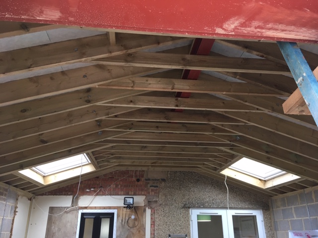

Use insulated board or battens, insulation between then PB
Ive done a couple (PIR between and under) without using counter battens and had no issues with screws popping or cracking, can’t see the point. If there is a bit of rafter movement and someone fat walks on the roof then the screws are gonna pop whether or not you’ve got additional battens
Up to the velux windows is 400 centres, last 2m evenly spaced. Last week I ordered 75mm pb screws (ideally be 65mm really) and got some 36mm tile backer/insulation washers coming from ebay to hold up the insulation (defacing 2p's how very dare you) also 100m foil tape for joints to make it the VCL. Hopefully it will all arrive before lockdown is all over! Not ordered the plasterboard as yet Hmm shall I go 9.5 or 12.5mm
The "counterbattening to stop potential cracking" idea is a nonsense. No need at all, there should be no cracking.
Floors and ceilings are not counterbattened in millions of homes as standard.
12.5mm all day. Like wot he said^^^
9.5 is for amateurs or shallow tolerances. Ok for doubling up though.
