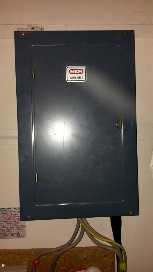

First problem...there is only a single board...looks like a MEM industrial unit and you can select which phase you connect to by selecting specific RCB slots.
It is also a PME installation...which as I understand it gives me concerns re neutral continuity.

I would be minded to go with the earlier suggestion of adding an 'essential services board' fed via a changeover from either the generator or the current board and move the two circuits concerned and perhaps some small lighting circuits over. If the current board is MEM then HRC fuse carriers should be (perhaps were*) available. If you were to feed the new board via a 45A BS88 fuse and kept your final circuits at 16A or under then hopefully that would eliminate discrimination issues
* MEM has a tendency to change their range over ten years or so and make it incompable with the previous. The current is Memshield 3. Do you know what your is?
Outdated by the look. It is a Memshield...no number...dated 1979!
As it happens I have a spare board....but I suspect complete replacement is overdue.
Is the PME installation an issue? It seems that neutral continuity is important??
I might be mistaken but I don't think the memshield boards go back as far as 1979... mem were all aout the memway hrc fuseboards back then (and probably the ones wit rewireable fuses in as well - just)

Does it look like this from the outside: https://www.google.co.uk/search?q=m...m=isch&q=memshield+1+db&imgrc=UCFiDRGAa9RJeM:
Definitely MEM... definitely 1979!
All many thanks for advice. On reflection, and given that this house has NO rcd protection of any kind, I have decided best course of action is to install two new rcbo cu, one on one phase for majority of services, and one on another phase for essential services. Genny will then supply second cu via changeover switch when required.
