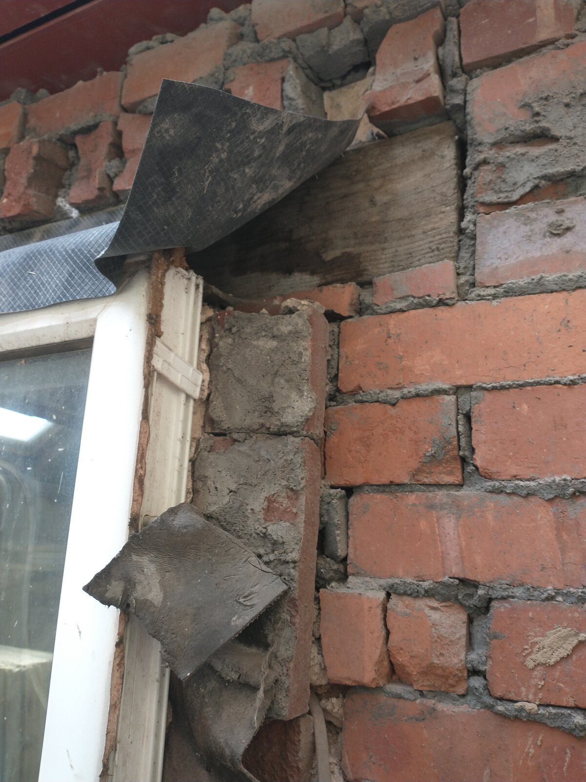

We don't bother with fancy lintels round here, inner skin has a lump of 8x2 and the outer just has a soldier course built off the uPVC window frame - it soon stops sagging when it settles on the glass.
