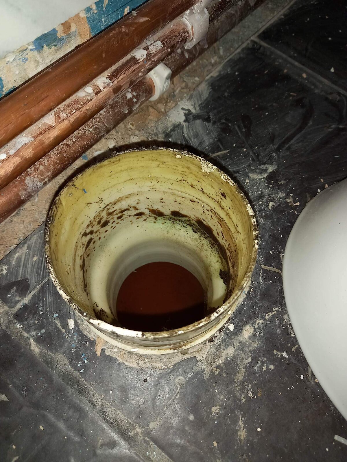

What connection is in the floor? Picture?
It is a plastic pipe that appears to sit directly above a buried clay sewer pipe. The new connector I assume, would squish into this pipe?
It’ll more than likely block on a regular basis.

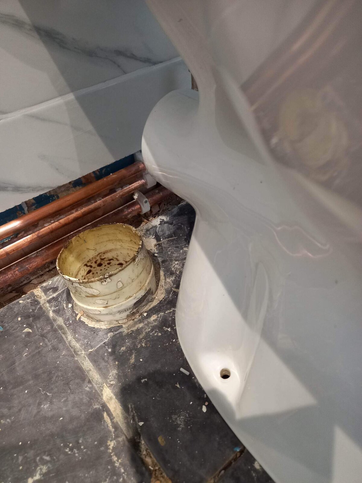

Been researching more into this. Can I use a 90 bend out of the hole in the ground and a 90 bend from the back of the loo? Presumably it is possible to join two connectors together? I also need to plumb in the basin waste into the wc pipe.
Here's the situation as it is (see pics)
I've tried the flexi pipe but it is not tight enough unfortunately.
Any thoughts,?
