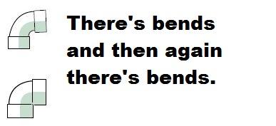

Assuming the "bends" as you call them are in fact elbows, I would say most unlikely!

Cheers for that Tony, yes I meant elbows, and since it's solvent weld I mean 32mm not 40mm pipe... not doing well today!
