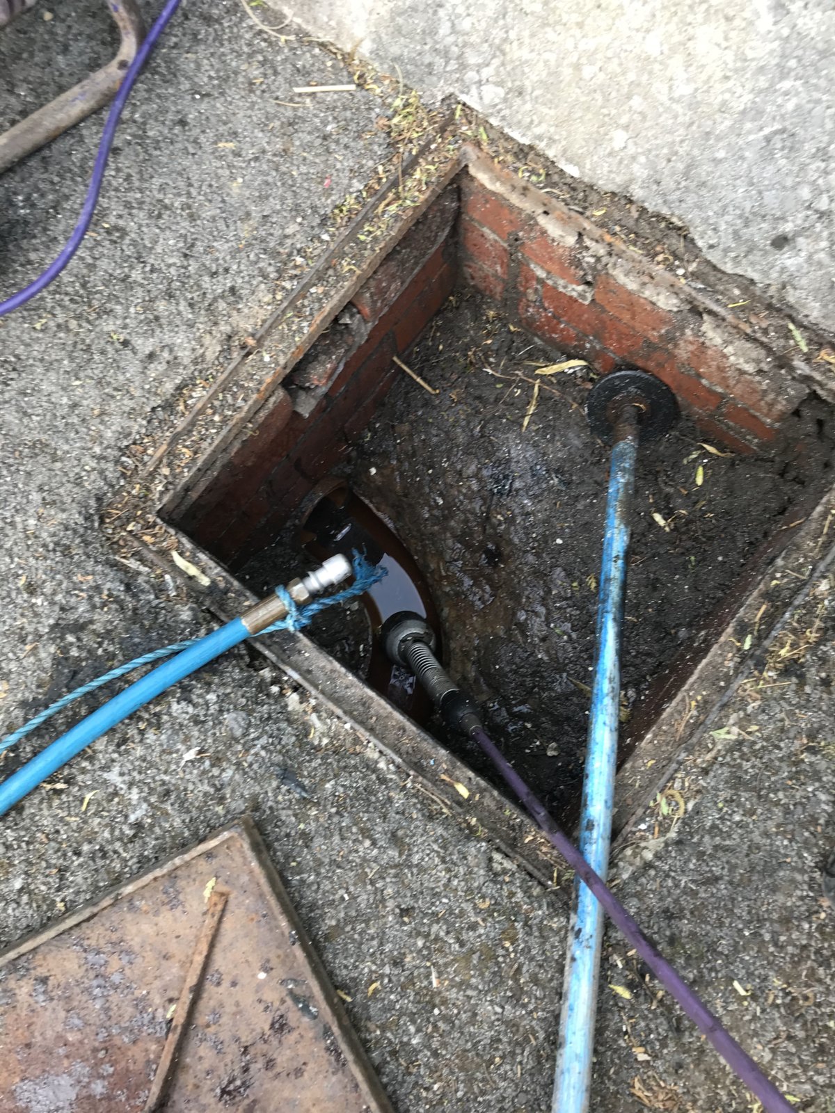

How to unblock a gully without manhole access?

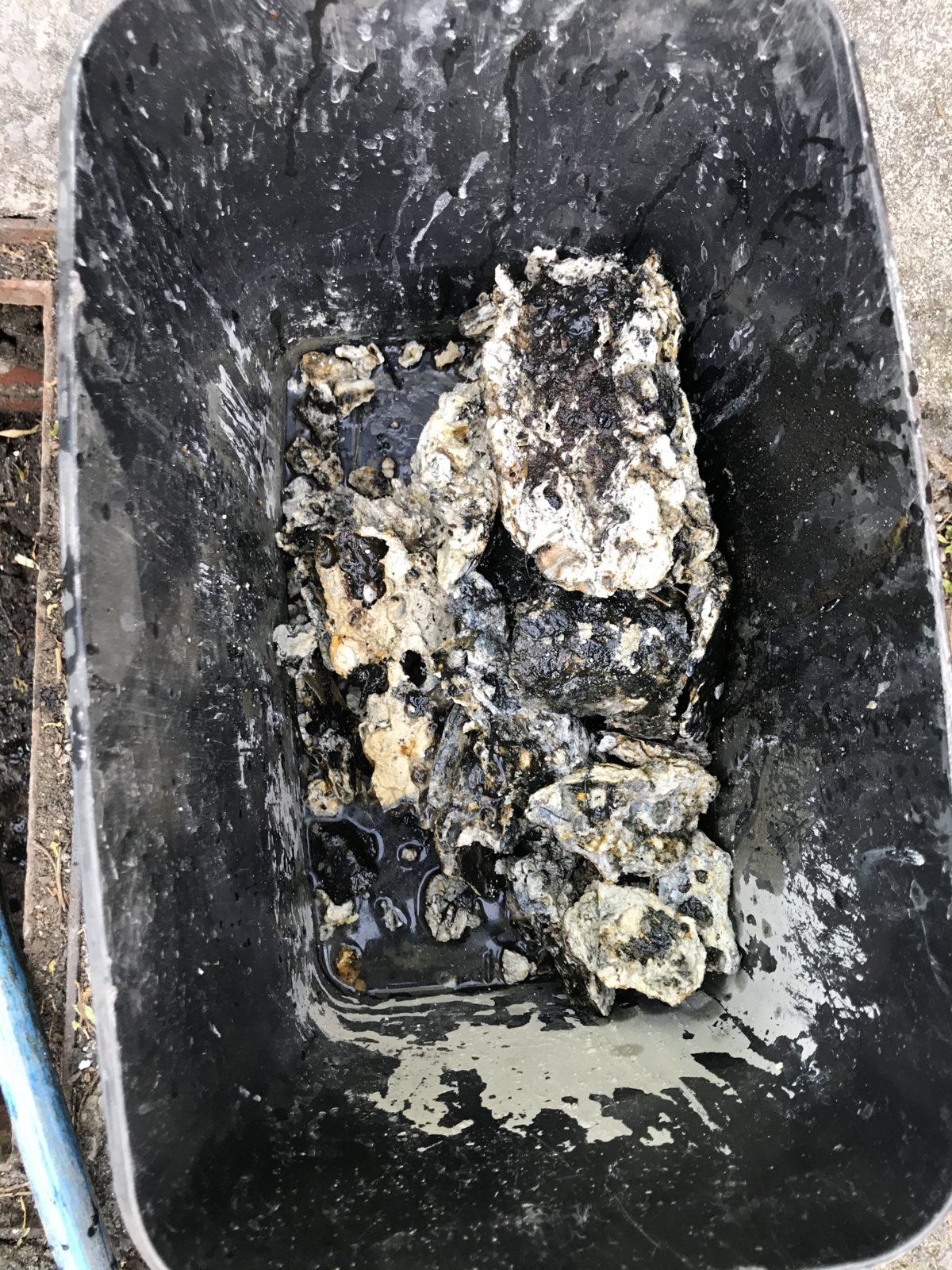

If there is a manhole downstream a decent drain guy could use a rope to pull his jetter up the junction to the gully. I did one a couple of weeks ago and pulled out this lot:
The downstream manhole should be in the neighbours patio, although I cannot see it; I have access to the the upstream manhole (which is in my patio)
Unfortunately the pipe from the gully meets the sewage between the two manholes
It’s a shame you can’t see it, it would be pretty easy to guide the jet head up a junction if you were going upstream.
