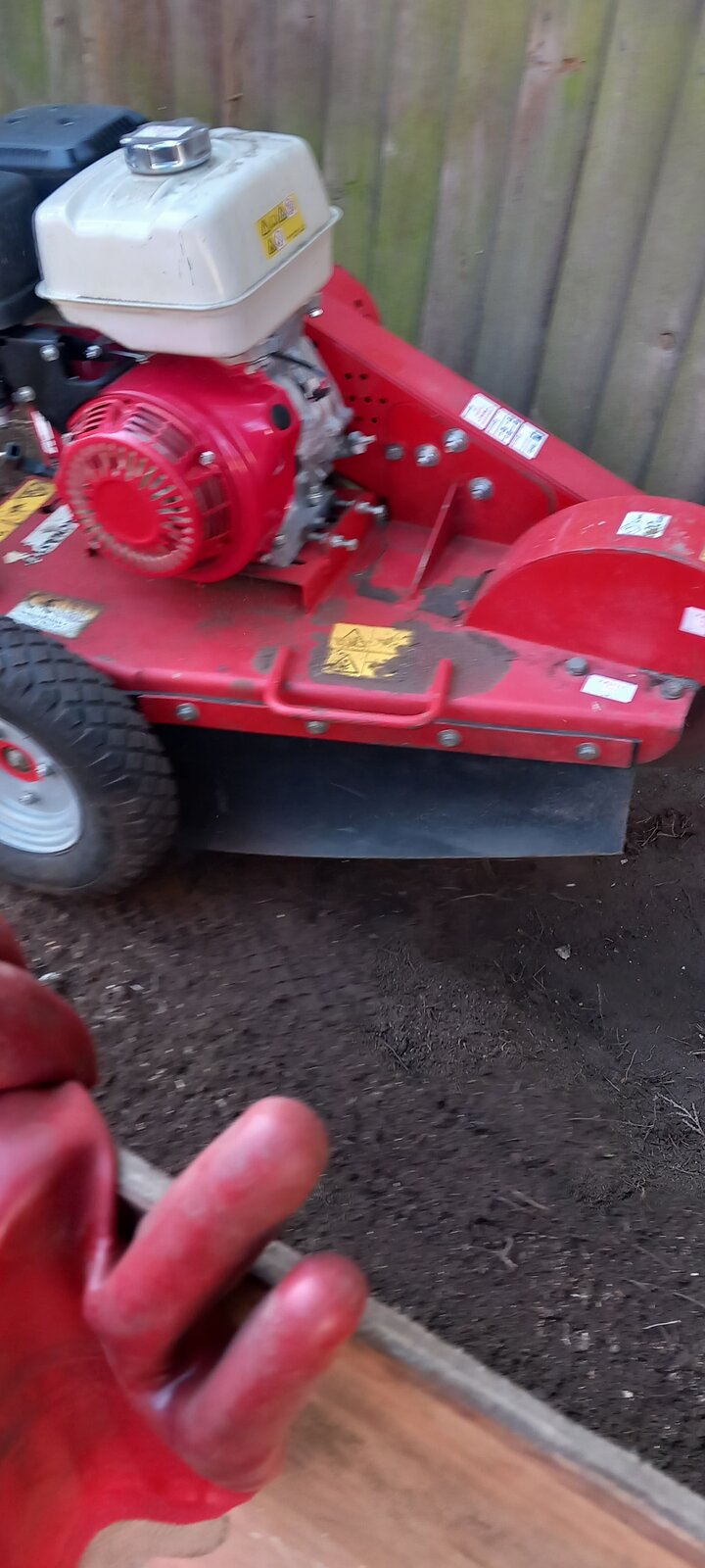

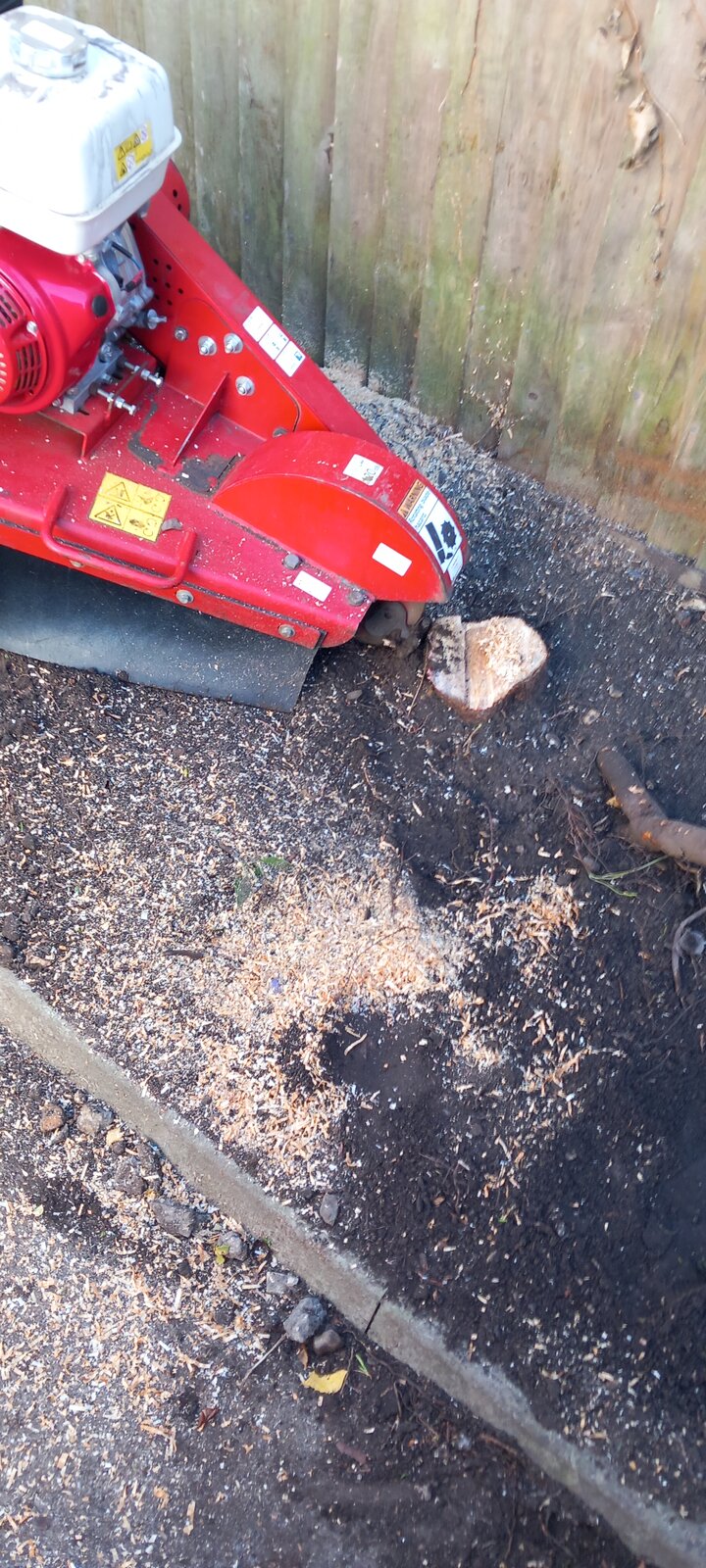

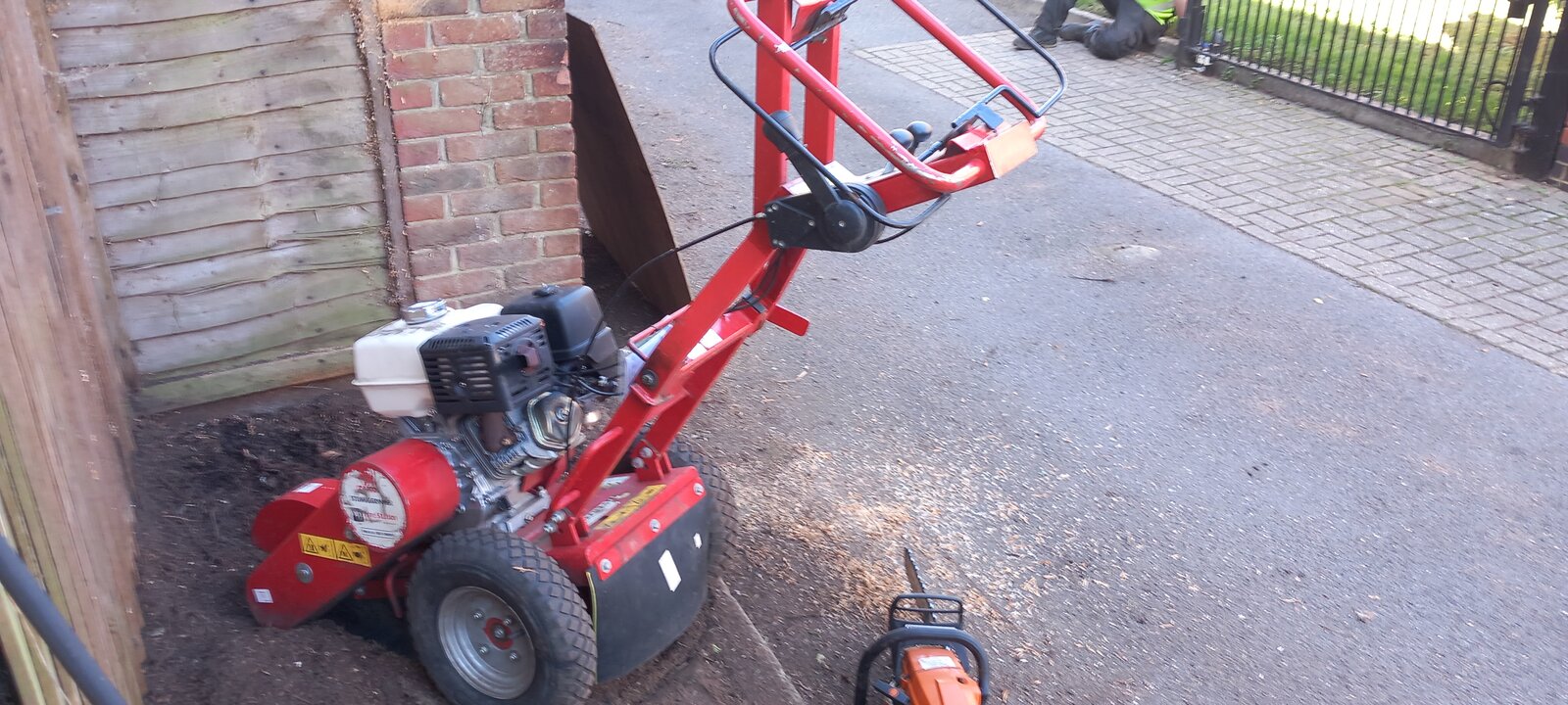

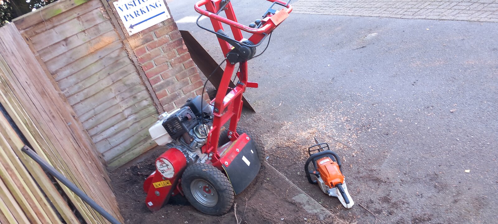

Mate hired a stump grinder for approx 9 inch diameter stumps from old hedge. Small grinder I guess. Removed the stones around then went at it sliding from left to right through soil and stump. Piece of ply next to it for flying debris and helmet with visor.
Any safety advice appreciated

Sounds like you have it covered.
I always wear safety specs if wearing a mesh visor, things can always ricochet up.
Check for utilities underground.
Looks like a public area, cones around the work area and a 2nd person watching out for people and traffic. They would probably give it a wide berth though, if they had any sense.
So no sudden kick backs with these machines? Just things flying back into face. Stumps only grind down 9 inches or so, how could u hit utilities at this depth?
Tree surgeons helmet and visor to be on safe side.
There should be no kick back if operated correctly, the self weight of the machine sees to this especially as the disc rotates towards the operator (IIRC) there would be kick forward if anything. They are incredibly good at removing stumps, but do check for utilities. When I hired one I found the gas pipe about 12" below he surface with the conifer roots wrapped around it. It may have a 9" depth but it goes lower the more of the stump you remove.

So if you're standing behind could push ypu back. Luckily blade is in the front. What do you mean by stance?
Always assume it's gonna kick back or whatever, use your body weight to help, don't use it in a such a way that if it does kick back you can't keep hold of it etc.
Defintaly don't bank on it though, if it were me I'd be easing off when anyone walks past, just pressure washing the drive people would seemingly happily walk through a haze of dirty water mist.
If the cutting wheel snags, the front jumps up and the handle slams downwards, which can deliver a painful whack to the hips or legs.
Also if the stump is deeper you are operating the machine on the edge of a hole, it's possible to lose control and have the machine tip forward or roll into the hole.
