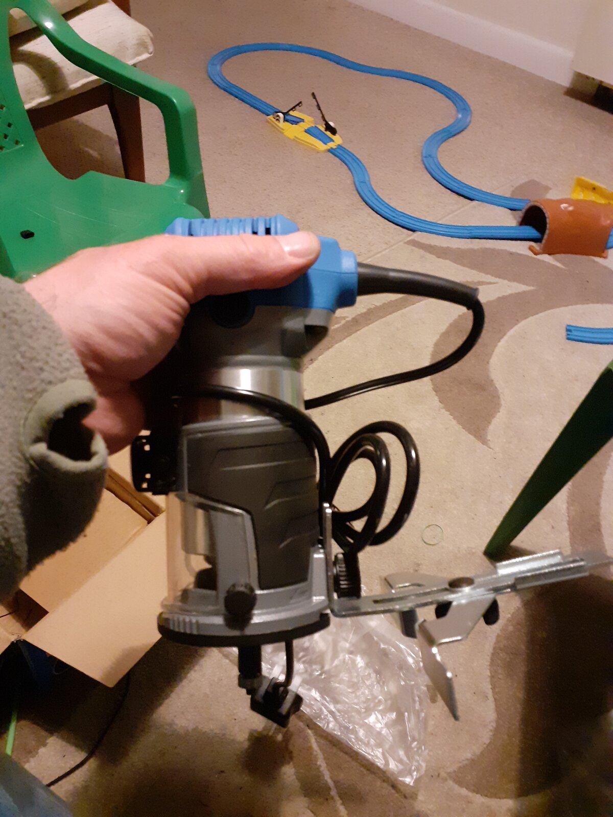

The guide which fits on the trimmer/router is too far away to use for hinges on doors. How do you set that up when cutting for hinges?
What bit would I use for cutting a groove and for hinges? I think the 1/4 inch one I have in is wrong. I guess they wont take 1/2 inch bits.

You don't do hinge recesses with a guide fence at all. When hanging one off doors I generally mark out the recesses (combi square, pencil then a sharp chisel to mark rhe edges) and hog away the bulk of the waste with a straight cutter, something like a 10 or 12mm diameter cutter (on a 1/4 in shank), don't go bigger than 12mm. These cutters must NOT be fitted with a guide bearing like the one you illustrate - that is a template routing bit and has a completely different function. The last bit of remaining wood into the corners and edges is cleaned out with a sharp chisel, ideally 25mm wide or wider, working to the lines that you originally cut with the chisel after you'd set out the hinge positions.
An alternative, which is only really worthwhile if you are doing multiple doors, is to make up a routing template and to use the router with a guide bush installed in the base. Youdo not need a plunge base to do this,although a larger sub base than the rather small one you are supplied with is advisable. As you don't yet understand fences or routing I am a tad reluctant to go through that process here at this moment
The roller guide fence is solely for use when trimming laminates and requires practice to become proficient. I would not recommend its' use for beginners
The straight fence is for forming edges (profiling, rebating, chsmfering, etc) using cutters which do not have a guide bearing mounted directly on the cutter. It can handle grooves, v-cuts, etc near to the edge, but the range is not very great

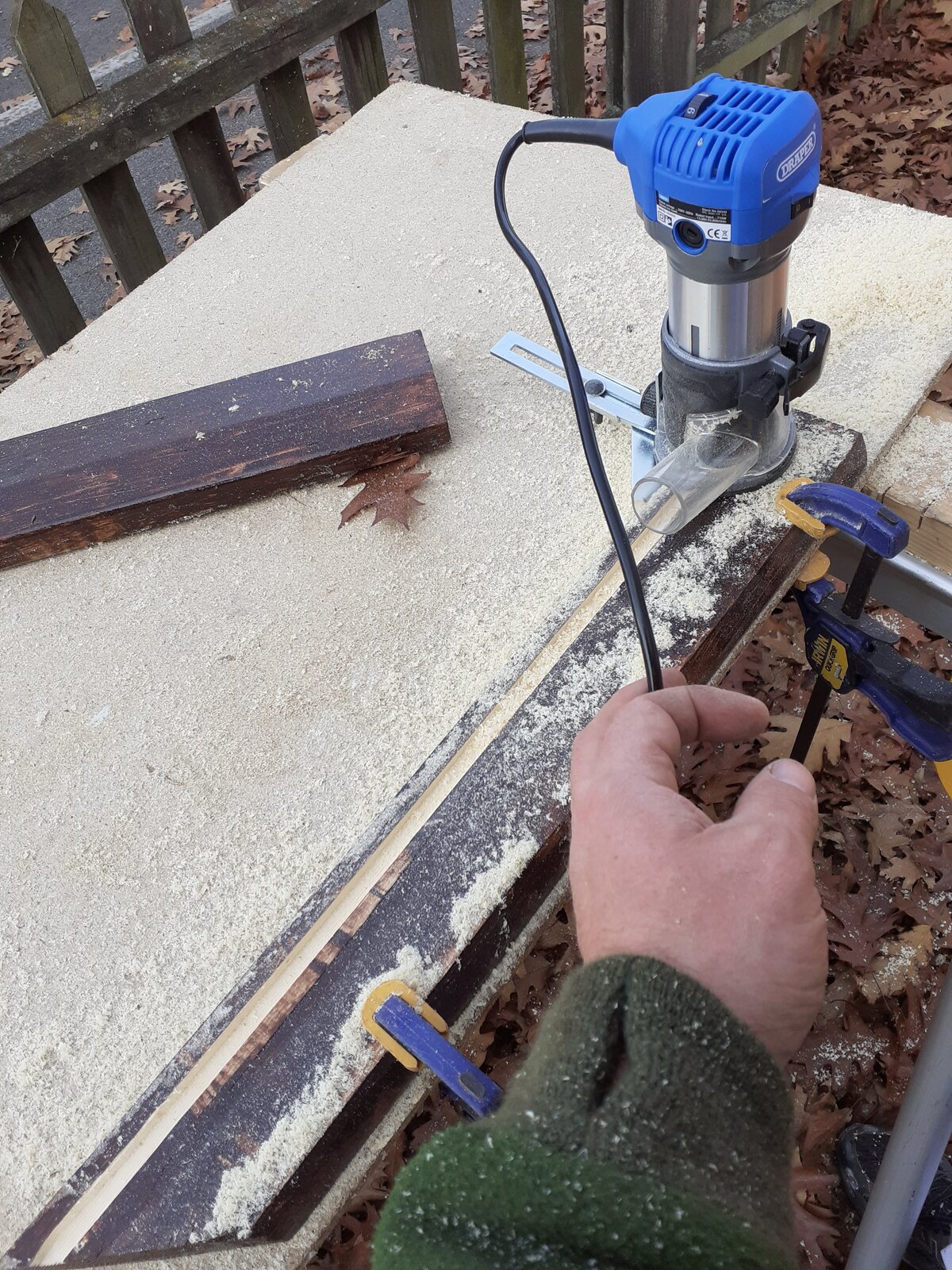

As the trimmer was around the other way I went from right to left. One hand on top and that was it. Very small drop in depth. As I brought it into wood it went a bit scuwith but good enough. These things dont kick back or fly into u do they?
with a baton you do NOT use the fence
the baton is clamped so the edge off the router base rubs against it
you could use the fence against the work peice edge but not both

its looks like the sawdust may be confusing me ??
what looks like a fence on a baton is actually the workpeice but not so clear at the buisiness end :D
So better to use a piece of baton for the fence not the one on the router
you cant use a baton for hinges
use off batons when well away from the edge
