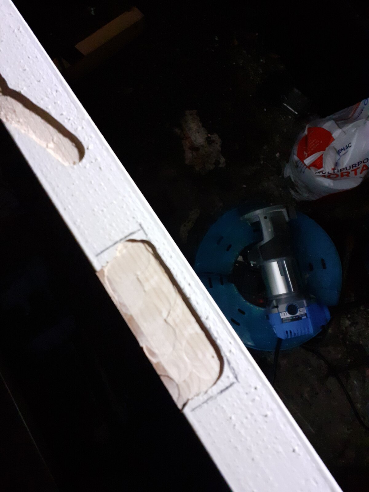

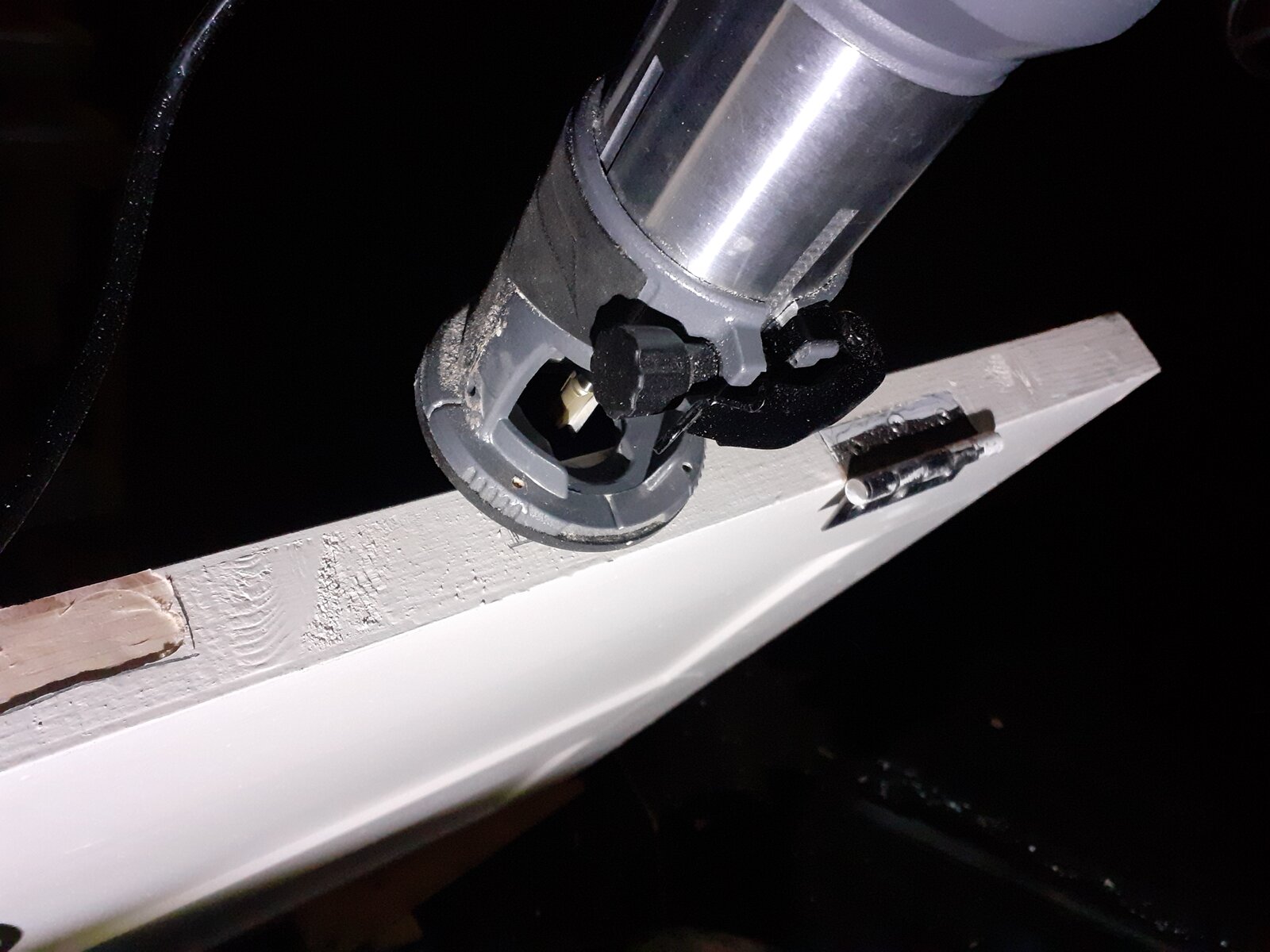

Had a practice freehanding on an old door in my garage. Took off the vac casing thing off my trimmer/router to I could see into where it was cutting and see the hinge line while I moved it about. (This isn't a plunge router.)
Pushed it into the door then to the left away from myself like you advised (material to the right). Wasn't perfect cut. Went slowly. Seemed ok. No feeling it would fly off or jolt in the wrong direction. Few circles rather than perfectly flat which needs improving. Mostly it's finishing the job without hurting myself which is always most important thing for me.
thats because you are leaning the router [not dead flat ]
it also looks too deep
you need a 2mm gap so unless your hinge leaves are 2+mm apart your pockets need to be less than the leave thickness otherwords you will get less than 2mm gap
I didn't set the depth exactly to the hinges. It was more just a practice. So I need to keep the machine perfectly vertical no tilting
yes if you think off it if you exaggerate the angle to say 10 degrees with the cutter at an angle it will hit the timber a few mm before the dead centre off the cutter and because the base is at a 10 degree angle it will continue to climb at that angle until the back off the base hits the top off the surface or you level of tip the router the other way
apart from the front edge where you can get the mm or two deeper the deepest it can go is what its set at any lean will lift the cutter as you now making space between base and work
Yes. Not doing that could lead to an accident.
