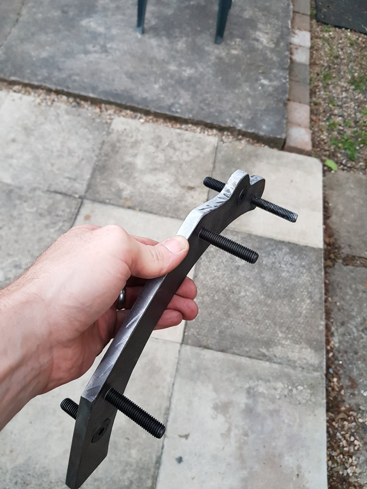

Using an angle grinder safe
I would remove the bracket from the wood and clamp it to cut it - I don't think an angle grinder and any kind of wood is a safe combination myself.
Not sure what you mean? Assuming the wood isn't being reused, I don't see a problem? You will set fire to your clothes long before the wood catches.
I'd generally be concerned about the blade snagging in the wood, not about it catching fire.

Indeed, a dangerous but very useful machine.
You have the work well secured which is essential and on those pieces cut from top to bottom. You need to avoid the blade digging into the work but in this situation it's unlikely.
Always use two hands and keep the guard on.

When u say from top to bottom I guess you mean bring the saw towards you?
Yes, that's correct....it means that the cutting wheel cant dig in and accelerate across the material to be cut.
For what its worth I think you have created a good, safe working environment there, particularly in the absence of a vice - and if the wheel cuts into the timber it won't do any harm at all.

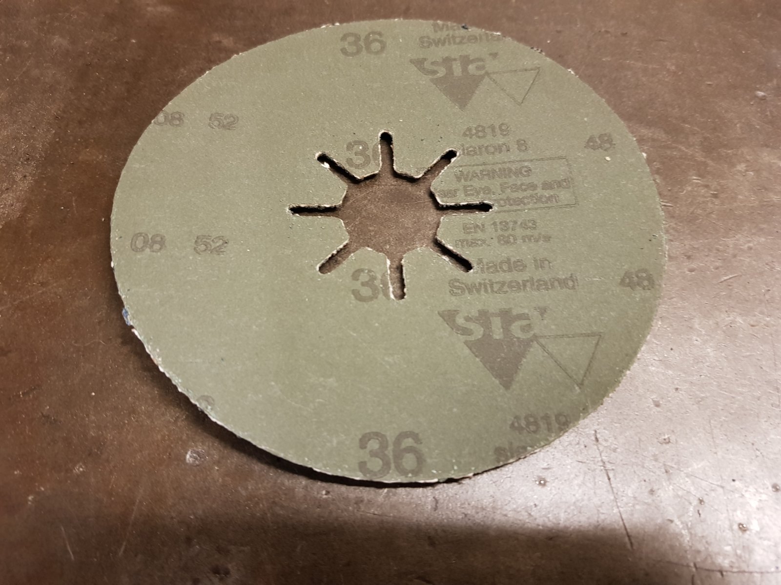

I don't know if you have discovered the thin (1mm) slitting discs that are available - an absolute godsend for cutting. I've used over 50 this year so far (y)

I've been working on some 10mm steel recently and and the 1mm cutting discs go through it like a knife through butter!. (Bosch disks from Screwfix).

Found some flexible flap sanding disks the other day, gave a great finish and easy to round of curves.
