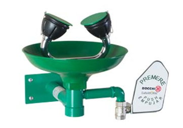

The medical advise is flush the eyes with 20 litres of water at 7.0pH. Then check the pH of the eyes. If it is not in a normal range, repeat flushing.
That is why emergency eye washing facilities have running water.

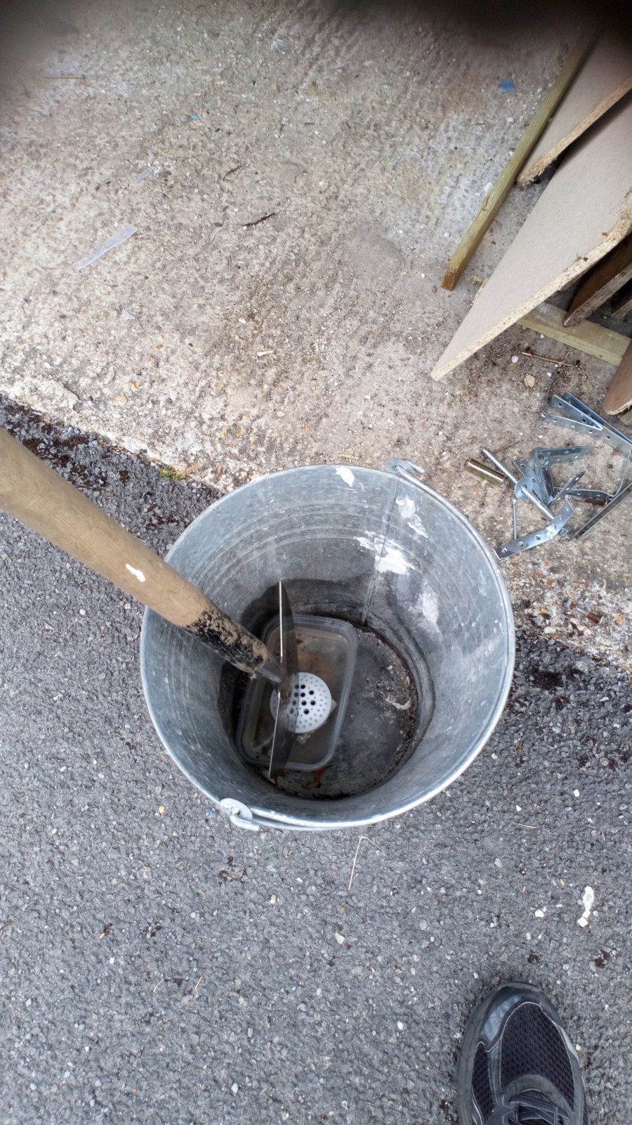

After spilling on garage floor put plastic container in metal bucket with tool to weigh it under.

You say replace the metal hose on this cos' of legionnaires. Surely put it in boiling water for 5mins. That would kill anything
