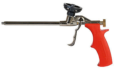

You ARE using an application gun and not just the aerosol type foam? If not - go buy a gun and use foam with the screw-on canisters. If you are already using a gun and still getting it everywhere, go buy a better gun with better control.
Nah, it’s the aerosol can types I’m using, typically I’ll have some odds n sods job now and again where I need to fill a gap and I’ll just buy a can of soudal (or equal) fr expanding foam.
My main issue is with the excess that releases after you’ve press the trigger getting dragged from the work area and going all over the place… the squirting little amounts at a time suggestion rings true … I have tendency to hold the trigger till it appears at the top of the opening.
save up for a foam fun
this is the Fischer I use
less than £20
and you can adjust the flow
buy at least one can of gun cleaner and don't neglect it or it will be junked.
