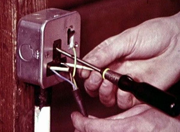

Low-cost adapters are widely available
This shows them being used with a UK socket, but the method is the same for any type, easier in fact for unshuttered ones
Do I have to say that the above is a joke, not a serious suggestion?
