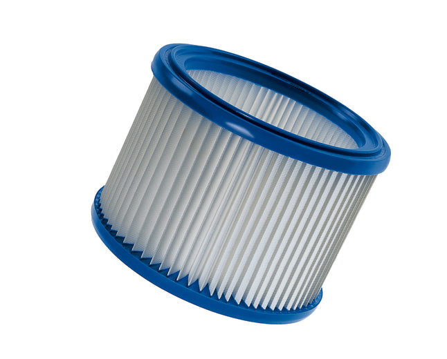

Can the same filter be used Dry and Wet
now say M filter grade - have to look that up - i have HEPA bags for Henry
DIY vacuums need HEPA bags to filter the fine dust. Especially if you using on MDF or Silica dust as its the biggest risk after asbestos.
Suck in dust that isn't caught by bag then kills the vacuum motor and blows out the back and pollutes the air.
If you buy a cheap vacuum then don't skimp on the bag..

Some sites say that the filter supplied with the one at CPC is a HEPA filter.
A true M class machine is supposed to monitor the airflow. Some will automatically "tap" the bag or filter to help maintain the airflow.
As per @Wayners ' post, I guess that many have the same bags and filters used in L class machines. I am only guessing though.
