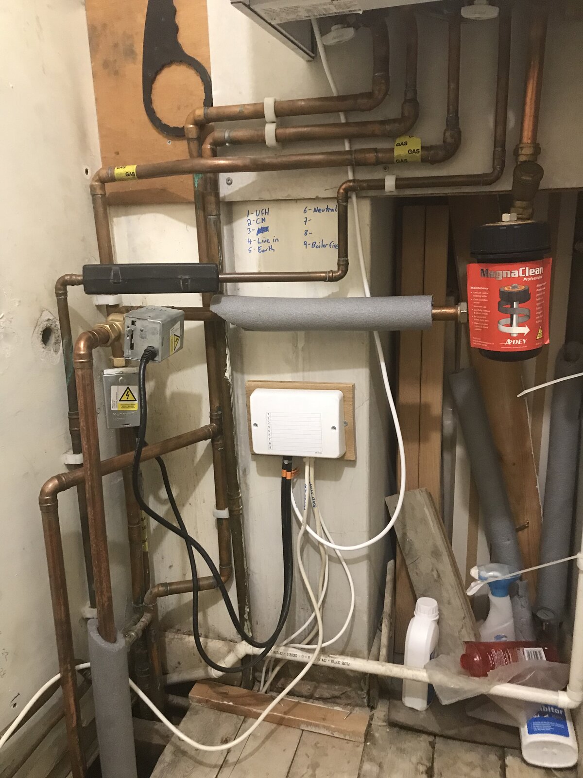

If it were the bypass, then the boiler return would be hot underneath. I’m thinking that there’s a valve closed off somewhere too. I was thinking at the boiler, hence me asking.
The bypass is built in to the boiler - I think it bypasses without using the flow and return under the boiler?

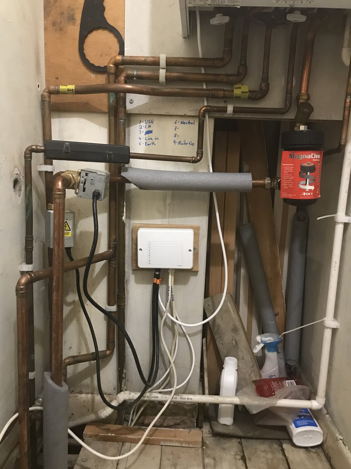

Can you post some clear pictures of motorised valves and pipework to underfloor/boiler. If I read your first post correctly the zone valves are on the return? That's not normal method!

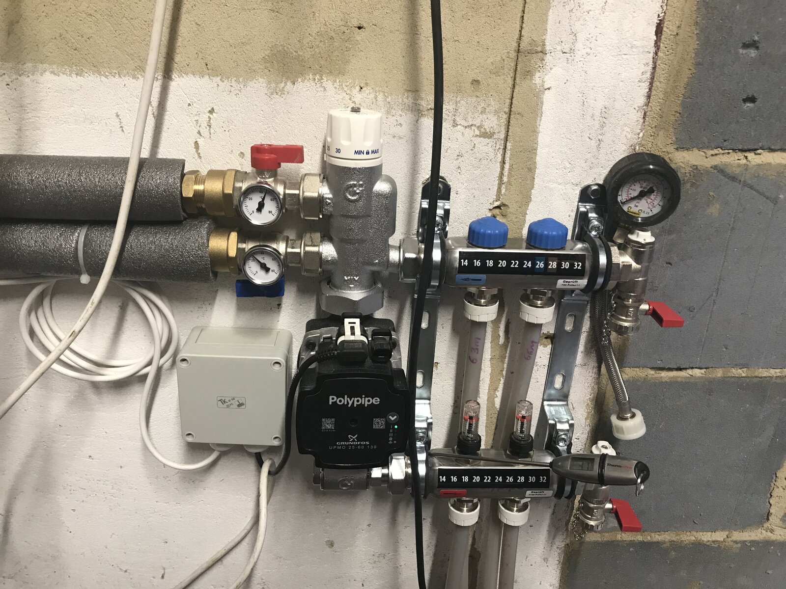

I checked the manuals and only the 3 way valves state not to install it on the return. Apparently it doesn't matter with the two ports? The radiators are working fine. Just appears the UFH manifold is very restricting and causing the boiler to bypass and then cycle.
How accurate should the blending valve be? Mine seems to jump about a fair bit. The input temp is jumping from 40 to 60 degrees but the output temp from the blending valve doesn't seem consistent?
I didn't get any real instructions with the manifold so I probably don't have it setup correctly at all!
I will post some pictures in a bit...
Can you help with the basic manifold settings?
I have two loops 63 and 66m. What settings should I use for the flow adjustment and pump speed (I,II, Rad or UFH)
What flow rate should I be getting on the gauges? They are only marked Min and Max...

Hi, they are free moving. The caps are lightly screwed on and not pushing the pins down.
When I turn the pump to II the flow shows near max with the flow restrictor set to 30
The 2 blue caps remove them and make sure actuator pins are moving freely.
