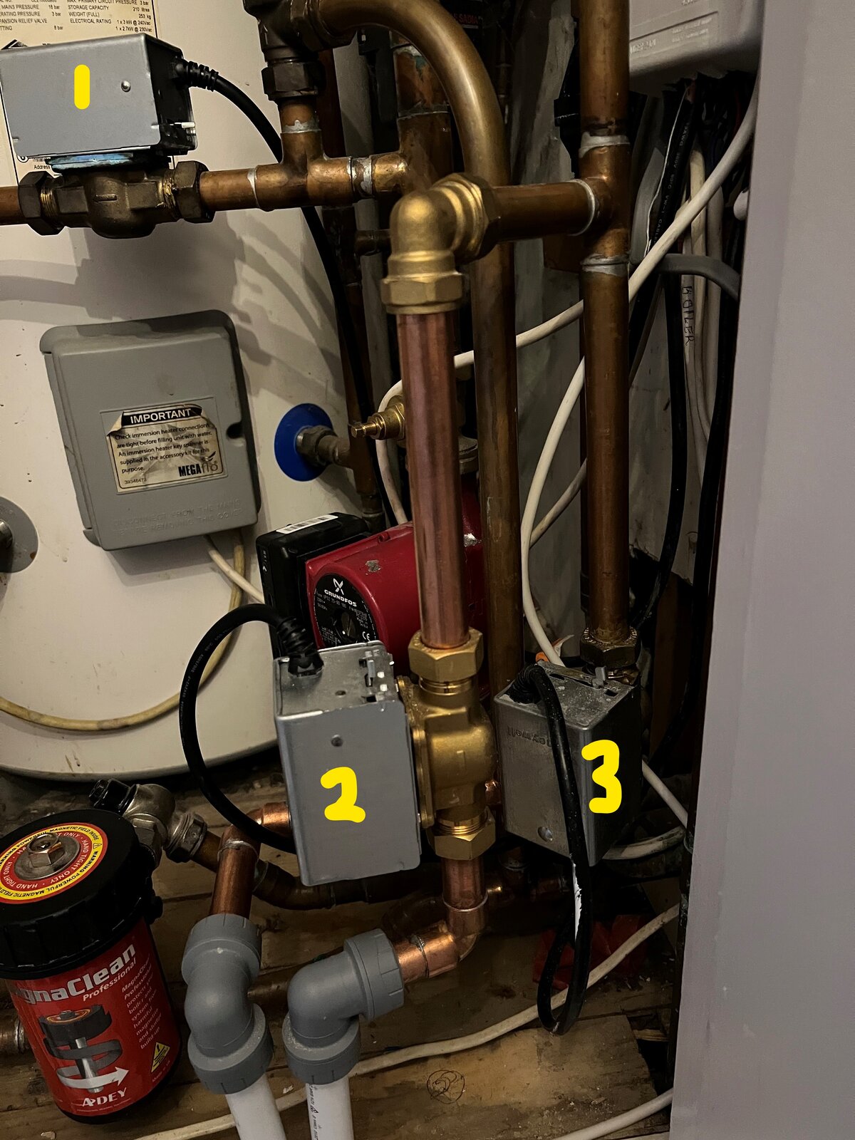

Vaillant boiler cycling when using Underfloor Heating
5 Nov 2009
161
6
Berkshire
Apologies if this has already been answered before but I recently had installed a wet Underfloor Heating (UFH) system to a newly built orangery 6m x 4m). The rest of the house is a wet central heating (CH) system containing 21 radiators. I have a Vaillant ecoTec Plus 438 condensing boiler (around 13 years old) that powers the CH system, Hot Water (HW) and UFH.
The boiler is in the garage, the individal zone valves (one for CH, one for HW, one for UFH - shown in attached photo & labelled 1, 2, 3) together with a Grundfos UPS2 25-80 pump, and Megaflo cylinder are all positioned in a landing cupboard. I have attached another photo showing the zone valves but also the position of an automatic bypass valve (highlighted by the yellow arrow).
When I have both, the CH and UFH systems turned on, the boiler works happily away and both, CH and UFH heat up nicely the radiators and orangery respectively. However, the problem I have is that if I just want to turn on the UFH only, the boiler is continually cycling. From what I have researched, this is due to demand of the UFH being less than the boiler minimum output. The Vaillant boiler is not modulating properly. The boiler comes on for around 2 mins but then turns off for 5-6 mins.
The pipework around the UFH manifold is not really getting hot and I just feel that with the continuous cycling of the boiler, this is both, causing wear & tear on the boiler and using excess energy.
Is there a resolution this? I am thinking that when the cold winter sets in and I wish to initally turn on the UFH in the orangery (since UFH takes longer to heat up compared to radiators - the orangery comprises of screed flooring with porcelain tiles), the orangery is going to remain cold as the UFH is not heating up properly due to the continuous bioler cycling.
Since my existing Vaillant boiler is not as efficient as the latest boilers, I am not against having a new boiler installed that can modulate down effectively but I do not want to find that by changing the boiler, I still have the same problem.

thanks @jeff the gasman. The boiler is currently set to a maximum heat output of 20kW (by setting d.00 on the boiler to 20). Even with this setting, the boiler is continuously cycling when only the UFH is on. If the boiler is 'down rated' any further, will this not be insufficient to cater for 21 rads and UFH at the same time?
I don't know what the following setting actually means. I'm just flagging this up in the hope that somebody else can advise if it helps. Please don't make any changes as I have no experience of a system like yours!
d.17 = Heating flow/return regulation change over - 0 = flow, 1 = return (factory setting: 0). When connecting underfloor heating or wall heating to the appliance which does not have its own temperature regulation, the temperature regulation mode can be changed from flow temperature regulation (factory setting) to return temperature regulation
The other thing is, have you done some basic diagnostics to see why it might be cutting out? Have you monitored the flow temperature reading (or perhaps return temperature, depending on d.17) on the boiler display to see what temperature it is at when the boiler cuts out. And how that relates to the set flow temperature.

Thanks everyone. I have a system boiler and does not have a d.17 setting.
Are you sure there's no d.17? I think I have the right installation manual now for your boiler, which says there is. (I can upload, or provide a link if you want to check it is the right one.)
I've also now found this thread from 2011, from somebody who seems to have a similar problem with the same series boiler, and they fixed it by changing d.17 - post #82.
https://www.diynot.com/diy/threads/does-balancing-increase-efficiency.266773/page-6
I seem to have now resolved the 'short-cycling' issue I had by changing d.17 to 1 - This changes from flow 'regulation' to return regulation according to the instructions.
