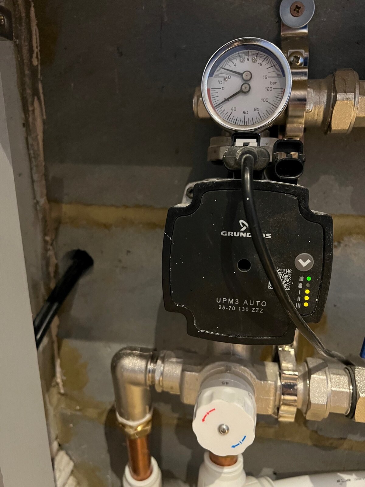

I just noticed on the UFH manifold pump (see attached) that the green light is displayed on the first light which has the symbol of a 'radiator'. The second light, which is not lit, appears to show the symbol of an UFH system. Should the pump setting be on the 'UFH' symbol instead of the 'radiator' symbol?
The UFH manifold pump is also on the setting III - would this be the right setting?
