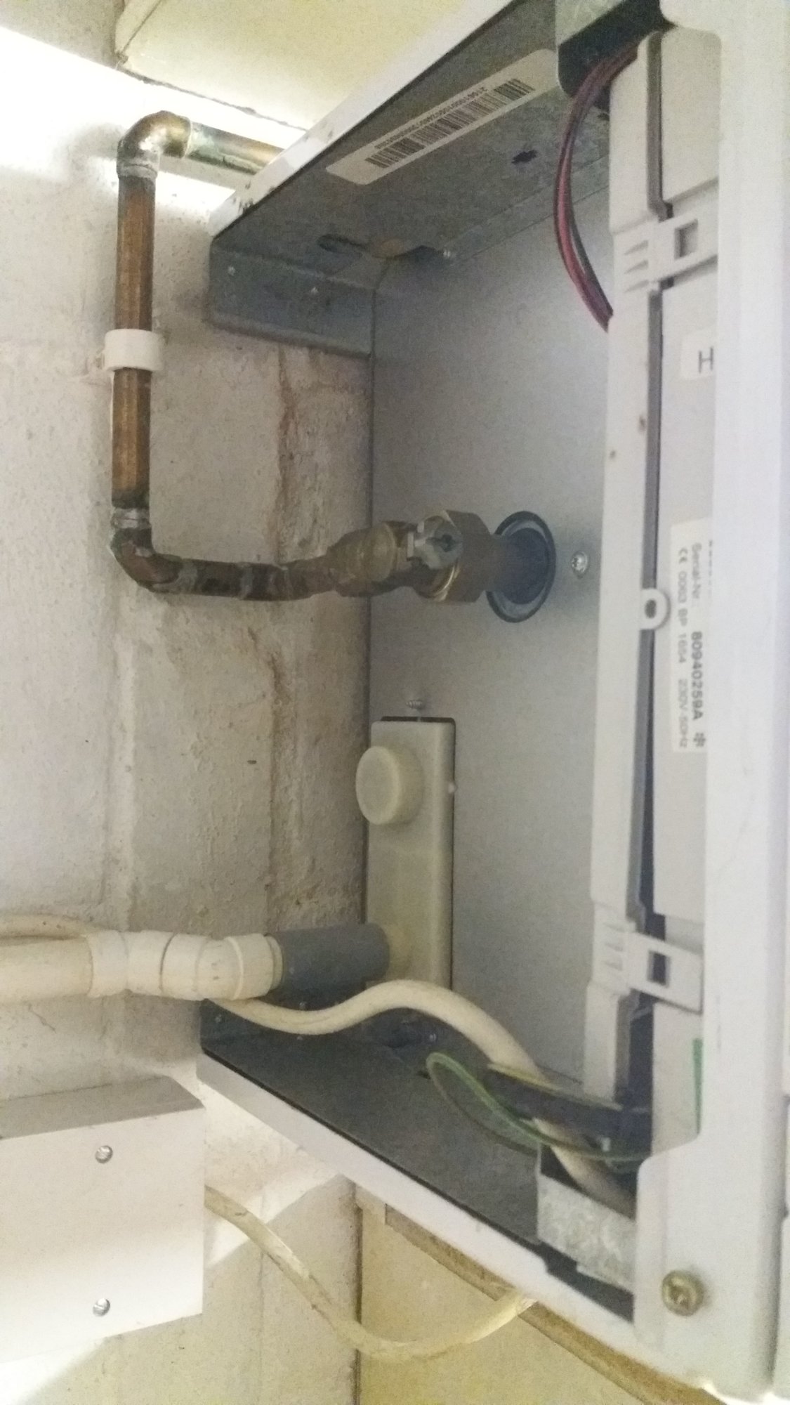

Evening,
Having some trouble with my Vaillant Ecotec Plus 418, which is showing a F22 error code - low water pressure. Sadly there isn't a filling loop that allows me to repressurise it.
Does anyone know how I might get around this? When I reset it, it starts up but then winds down quite quickly. No noticeable problems in airing cupboard.
Thanks!
Do you have a HW Cylinder somewhere? is there a small expansion vessel (usually red) if there is your filling loop will be there
This can also be caused by a faulty pump or air in the system
Thanks for the replies. Hoping the fault is the water pump so will be examining it more closely tomorrow.
