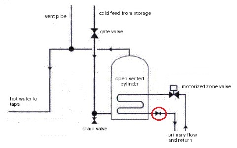

Hi all the vaillant ecotec 438 is overheating when HW is on
HW only - If flow set to 60c it goes up to 80c
It's fine on CH
When both CH and HW on together it will go up an extra 10c

Is It a sealed or open vented system, if sealed, check pressure is 1 bar cold, minimum, if OV, check that feed and expansion cistern in the attic is "full", around a 1/3rd or so.

If it's working ok for CH but not HW to me that suggests that there may be is insufficient water flow when the HW only is on.
Is there a restriction in the HW circuit. Usually there is a balancing valve on the HW return, has it inadvertently been closed too much?
Anything happen just before the problem occurred, any work being done elsewhere, anything been changed?
Nothing at all
