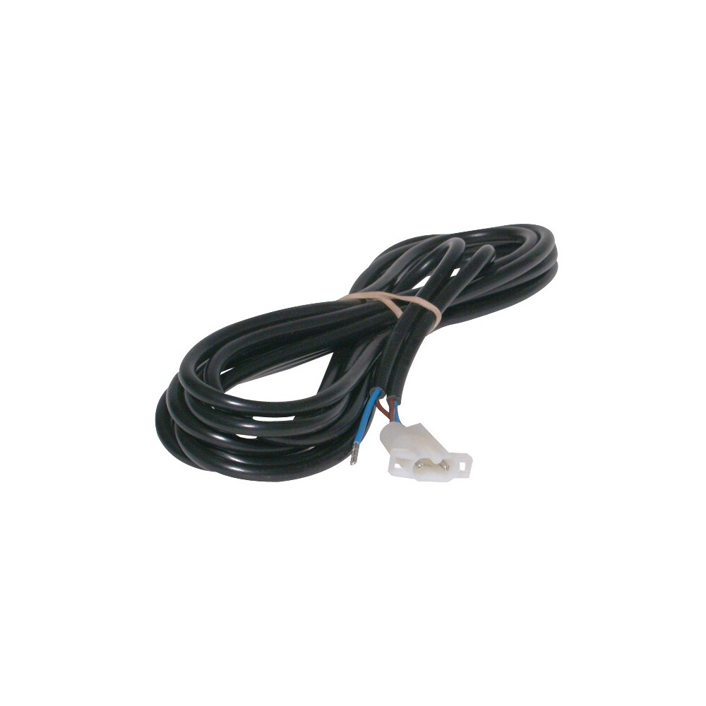

SUCCESS!!!
scw24489 you are an absolute legend. Your recommendation WORKS, I have just wired the cylinder's call for heat to the appropriate connector inside the boiler and voila' the boiler reads correctly the separate calls for heat/cylinder. No need for a VR66 or annoying extra wiring / eBUS.
I have bought Vaillant cable 089419, which is a "C1/C2 Connection line". It looks like it has exactly the right connector to go into my C1/C2 contact. I want everything to look as official as possible since my boiler is under warranty and cutting things is a sure-fire way to show that I have put my hands into it :)
I can confirm that Vaillant cable 089419 is indeed the correct one to connect to the C1/C2 port inside the boiler.

Sorry to ressurect an old thread but just wanted to thank everybody in this thread for the advice.
I've got a Vaillant 637 system boiler with underfloor heating controlled by Heatmiser wired stats and heatmiser wiring centres. I wanted to have 2 flow temps - 1 low for the underfloor and a higher one for my non-Vaillant cylinder. I bought the C1/C2 cable as mentioned and it really was an easy job to connect it to the boiler wiring harness. I discovered (Accidentally!) that even touching the 2 wires on the cable together fires the boiler into hot water mode.
I simply connected the 2 wires to the orange and grey outputs from the 2 port valve that connects to my heatmiser wall stat (run in timer mode for hot water) and it works perfectly. Once the timer (and cylinder stat) tell the 2 port to switch on, the orange and grey wires tell the boiler to fire in hot water mode at the higher temp. Once the cylinder stat is satisfied it tells the whole thing to turn off again. A very quick,easy and cheap solution and you don't have to mess with any of the heatmiser controls or install any extra Vaillant wiring centres.
