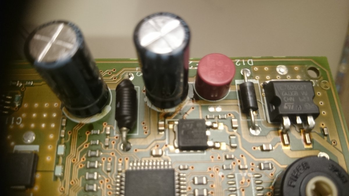

I've been experiencing the exact same problem with F27 and F62 errors occurring. To remedy the problem i simply pressed the resent button and normally cures it. However, last Friday even that didn't work and after reading you post tried the hairdryer trick and it worked.
I suspected the problem to be the pcb and after changing it it worked with no problem. On further examination of the old pcb my suspicious were correct as one of the capacitors was leaking and smelt odd.
I've taken a picture and you can just see the brown staining at the base of the capacitor.

Red thingy to the right of said capacitor as well as the black component right top corner of PCB has similar staining:whistle:
How do you know the red thing is not the cause of it.
If I am correct, as this item is similar to those used on other boards, is know as a fuse:rolleyes:
Well it could be. I just had another look and although it's difficult to see in the photo there is more staining round the base of the capacitor. In fact, there's slight staining around the identical capacitor on the left. Whatever caused the fault I wouldn't trust the job done by only replacing the component in case the IC's are damaged. Who's knows an 'unstable' capacity maybe causing the IC to be erratic.

Emu did you meter the capacitor to see if the value matches the markings?
When you are diagnosing faults, it is a logic based process, not based on assumption
I didn't check the capacitor rating and my logic was based on the fact that the brief application of the hairdyer on the pcb fixed it.
I still have the old pcb and will check the capacitor and get back to you.
