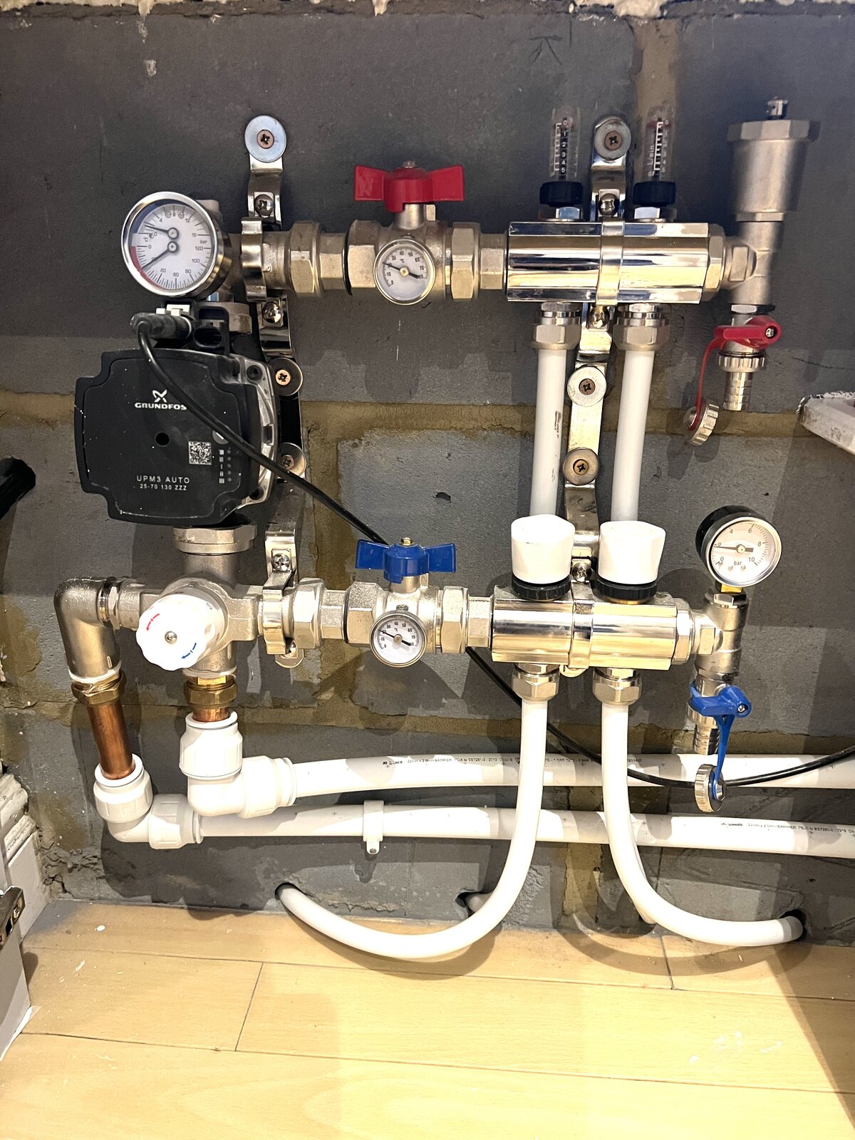

When I had the UFH system installed last year in a newlt built orangery room, I found that whenever I tuned on the UFH only, the boiler would continually cycle (modulate) even though the heat demand was enough to warrant continuous firing of the boiler. The way I would only be able to get around this was to turn on the CH so that the boiler would continuously fire and the UFH would remain on. I do not know whether this is the case that the heat demand (when only the UFH was on) is less than the minimum the boiler can deliver.

@ScotchGas, @Johntheo5, @ianmcd - I was in discussion with another heating engineer around the issue I have where my existing boiler continuously short cycles when I just have the UFH on. I was under the impression this was done to an issue with the boiler. His response was
that the boiler isn't the issue really, to a short cycling issue, it's how the system is split up. A boiler can only deliver a set min load. If the system isn't big enough to absorb the heat the boiler manages this by shutdown.
He has asked how many loops on the UFH have room thermostats and actuators, and how many radiator have TRV's? He said all make a system smaller. For every 6kW of heat delivered from a boiler, you need approx 50L of water engaged to stop short cycling.
If you want to operate on small circuits you need a buffer cylinder in the return of the CH circuit.
I mentioned that I do not have any TRVs on the 4 towel radiators, and I have TRVs on all the 17 radiators. I sent him the attached photo of my UFH manifold along with associated components. I am awaiting a response from him.
Would you say I need a buffer cylinder to get round the issue I am having with the UFH when operating on its own?

Your UFH has 2 loops, if you assume 45C/37C manifold flow/return temps and each loop circulating 3LPM then the UFH output is 3.35kw and if the boiler flow temp is 70C then the flow rate through the boiler will only be 1.45LPM at a dT of 33C, the dT will probably give a S53 status, if you reduce the boiler flow temp to 60C then the flowrate is 2.09LPM at dT of 23C so probably no S53 but might be difficult for the boiler to get away after cycling as the flowrate of 2.09LPM is quite low and the boiler fires up at ~ 60% (~ 23kw) of its rated output (38kw) despite being range rated to 24kw.
You might note the flowrates of each UFH loop and the manifold flow and return temperatures some time to enable more accurate calculations.
You must know the design flow and return temperatures for the UFH and its output and then run it, even with the CH, and note the manifolds flowrate(s) and the manifold flow and return temperatures.
The work was carried out by the builder’s heating engineer so no design work was carried out
You can just run it then, the flow temperature, depending on the floor material will be set to a particular temperature with the TMV (thermostatic mixing valve), typicall 35C to 45C, if you do run it, even with some CH, to get it up to temperature then note the flowrates, temperature etc.
Eventually, before you finally select on your new boiler, the minimum output etc can be looked at, some boilers like I think the Viessman Vitodens 200W have a minimum output of 1.9kw, I wouldn't be overly worried even if a cheaper boiler can onl modulate to say 4 or 5kw as long as it can happily cycle. Cycling in itself causes very little loss of efficiency.
Thanks @Johntheo5. Do you think the introduction of a buffer cylinder on the return of the CH circuit will resolve the problem?
The Viessman Vitodens 200W you are suggesting is a system boiler from what I can gather and will have its own internal pump. Would that mean I would need to get rid of the Grundfos 25-80 pump that I only upgraded to last year? Also, the Viessman is around £700-800 more expensive than the Vaillant ecotec plus 430 heat-only boiler I was looking at
The return buffer is interesting, I'd like to see a example of one working with the UFH only on as the UFH return temp can be as low as 27C/30C and will still result in a excessive boiler dT without some form of mixing, your engineer will advise, hopefully. The cost of the buffer can then determine if the Viessman is more cost effective but this would still require some form of mixing to keep the boiler dT < 30C.
The minimum output of the Vaillant is ~ 7kw but the return buffer volume will determine the cycling time. There is more control of the boiler flowrates with the heat only boiler (Grundfos 25-80) so overall the Vaillant may be the best choice.

The biggest problem with whichever boiler is installed will be running the UFH on its own as its only a 2 loop system but ironically, the easiest to see its heat requirement, all thats needed is the flowrates through the loop flow tubes and the manifold dTs.
