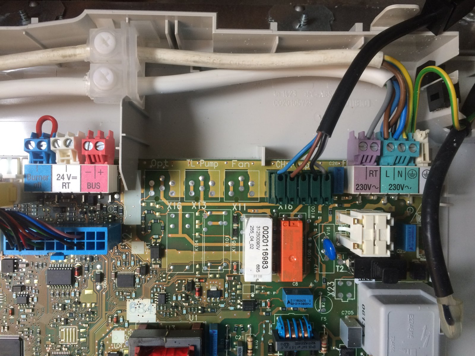

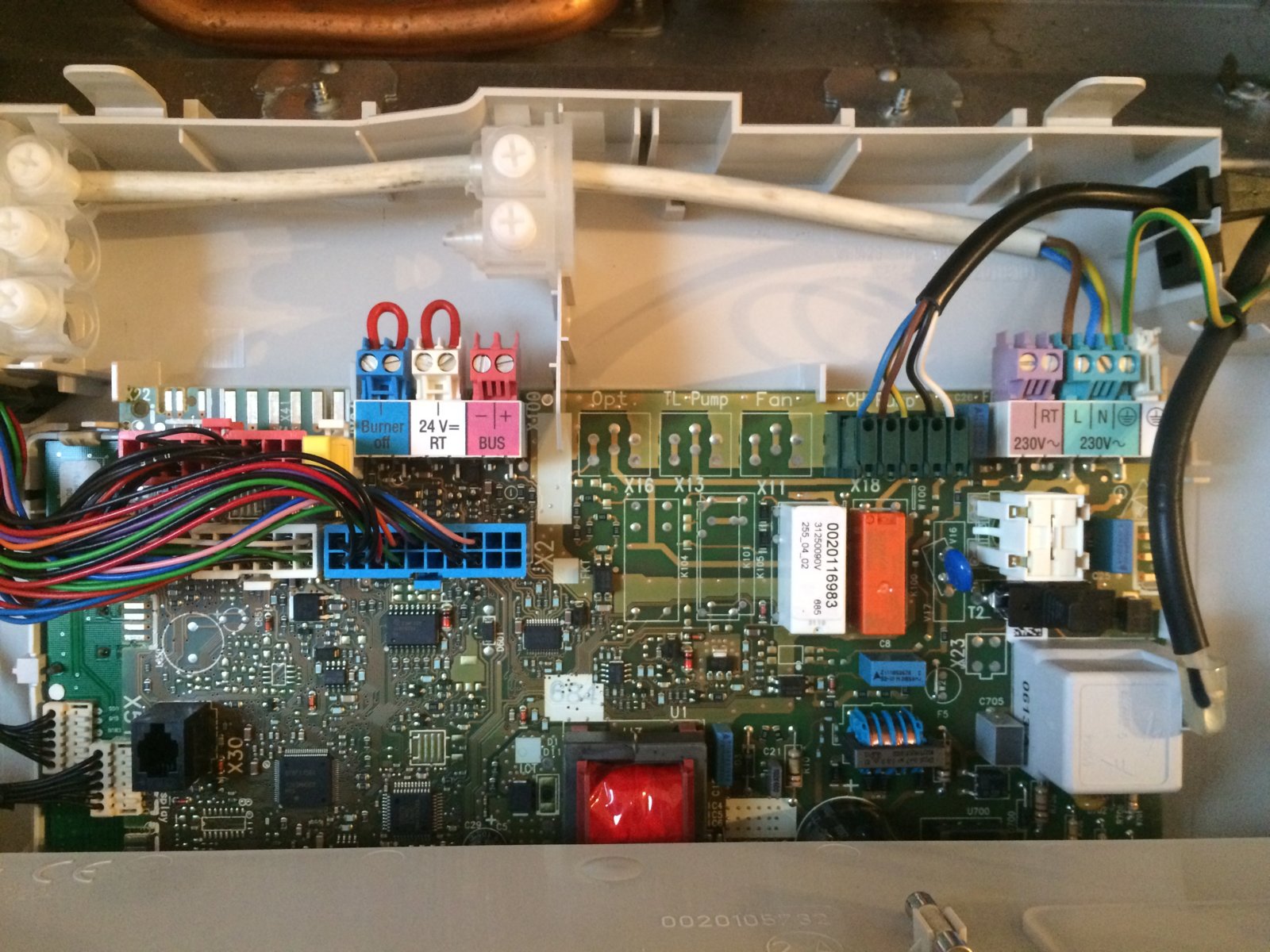

Don't know. I took before and after photos when the installer installed the Hive unit.

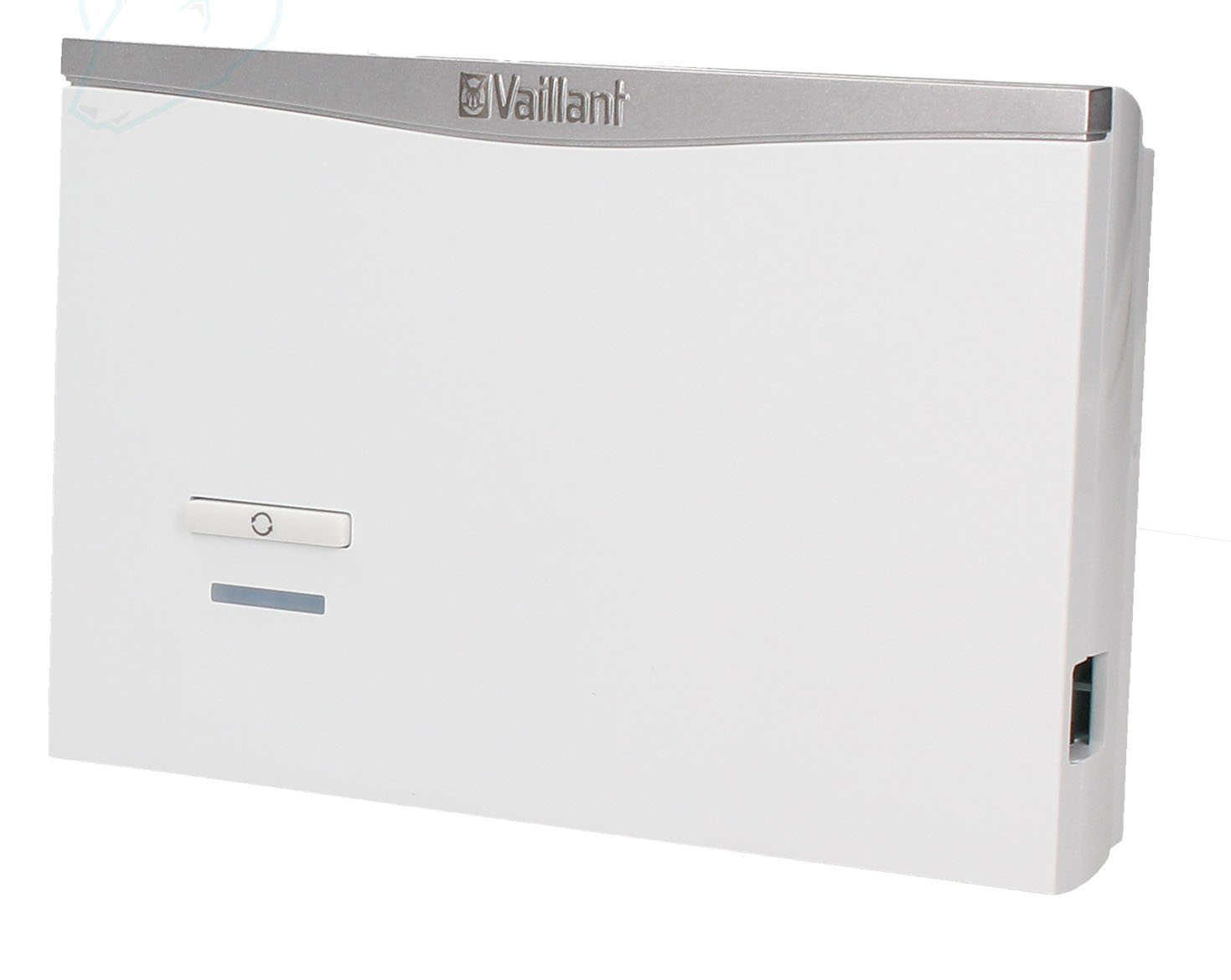

Is the receiver plugged into the front panel? Should have a green light and a button.
Looks like with newer boilers (after 2012) the receiver unit has been incorporated into the main pcb.
Maybe someone here can shed some light on how to check if it's been decommissioned.
It's a plug in one on all of them. If it's fitted and the light is on it will be trying to control the boiler. It can also go in a box mounted externally and connected to the ebus terminals.
I don't know the answer, but I can see that a link wire/jumper is gone from a 24v terminal in your second picture - anyone know if that's ok for the OP?
I'm guessing that's to do with the previous wireless stat if it was connected to the board elsewhere - and the link enabled it?
If you look at the photos I attached earlier, you can see that the pink ebus connector has nothing connected to it. It didn't have anything connected to it before the Hive was installed either.
The receiver light is red. I do recall an option in the Installer Level that the wireless control panel wasn't detected
Pretty sure the 24V link also has be disconnected for 230V thermostat operation and connected for ebus controllers.
That's what I have on the boiler itself. The light is constant red. Used to be green when the remote VRT was used. This is now stored away with the red link cable that was attached to RT 24V.
Just checked and the Option 90,91 and it says that a Digital Regulator is "Recognised" (90), DCF Status has "no reception" (91) if that helps
