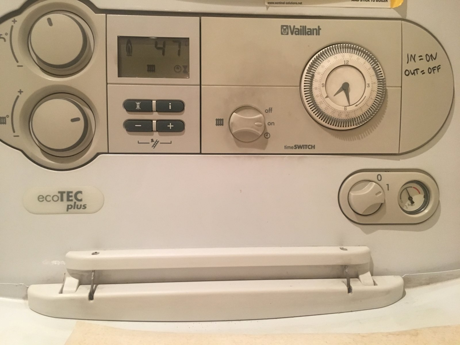

Ecotec Plus 831 HW only luke warm, CH working fine. When running HW, flow pipes do not get warm. Diverter valve has been replaced (probably unnecessarily).
When running HW, burner starts, temperature rises few degrees above setting then burner cuts out, temp falls then burner continues on this on/off cycle. The water doesn’t reach the setting (50 degrees) only lukewarm.
Any ideas?
Cheers, Daljit

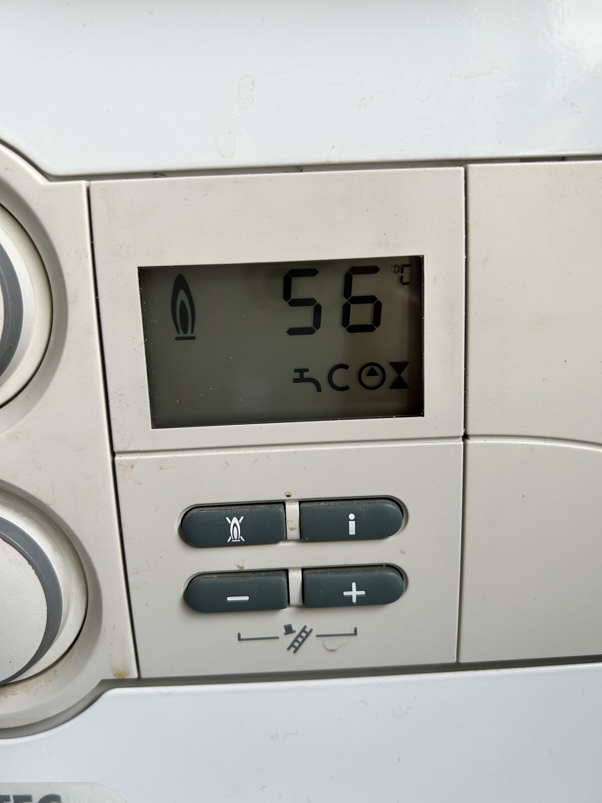

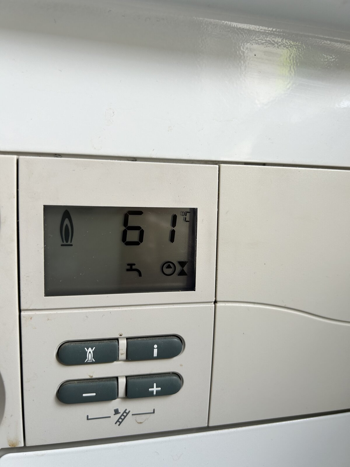

Just ran it to measure flow rate - it’s approx 8.5l/min. The burner stayed on but water was tepid although display fluctuated between 54-61 degrees.

Is the canoe filter just on the primary flow pipe into the heat exchanger, a DHW flowrate of 8.5LPM and a mains temp of (mine, just now) 19C requires 24.91kw to give a flow temp of 61C (and 20.76kw to give 54C) so you are getting a fair whack of heat which doesn't point to a fouled heat exchanger and probably not a blocked canoe filter either?. Its possibly a faulty DHW sensor?.
Can you just run the flowrate at ~ 4.0LPM or so to see if the temp stays steady, also run it again at ~ 8.5LPM and note D.040 (primary flow temp) & D.041(primary return temp) also D.036.

Running at 4.5lpm when HW set at 50 degrees results in temp climbing to over 60, burner cutting out until temp falls, then repeats again and again. As described in OP.
Running at 8.5lpm, d.40 - 55-60, d.41 - 51, d.36 - 4.
Whether running at 4.5 or 8.5lpm, temp no where near 50 degrees. Probably around 20.
So, it does look like a faulty DHW sensor.

You said above that "The burner stayed on but water was tepid although display fluctuated between 54-61 degrees." I assumed this temperature was the DHW (apparent) temperature, the minimum output of the 831 is ~ 8.5kw so if it kept firing even at this minimum output the DHW temperature will still be over 33C. You might also look at D.004 which is the measured value of the HW sensor in deg.C. D.036 (Hot water flow quantity (impeller sensor) In l/min) is only reading 4.0LPM even though you measured the flow at ~ 8.5LPM, did you measure this at a mixer tap or shower/, just wondering if you have a problem with a mixer resulting in this very low 4.0LPM DHW flow which will just about satisfy the min output of 8.5kw.
