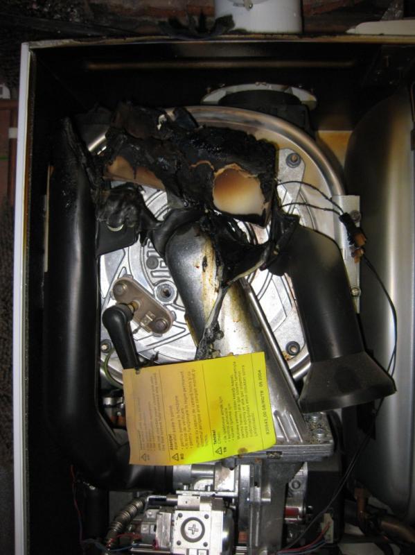

I've had this boiler for about 3 years with no problems. Over the last couple of days the domestic hot water has not heated up properly - i.e. it has only got luke warm.
I watched the display and although the water is set at 60 degrees it only reaches about 46 before the burner cuts out and the temperature then drops to about 42 before the burner ignites again.
On one occasion the water failed to heat at all and there was a fault code F.64 . in the manual this means "Electronics/NTC fault Short-circuit in flow or return NTC or electronics defective"
Any ideas if there is a simple solution or am I in for a hefty repair bill?
ecotec's log the last 10 faults so have a look and see if you have any other codes in addition to F.64
use the i and - buttons to access fault codes then use + to scroll though
and use flame button when finished to reset the boiler display

1 - F64
2 - F22
3 - F22
4 - F22
5 - F22
6 - F75
7 - F75
I don't suppose it's possible to find out when these occured?
I forgot to mention - the top centre of the boiller is REALLY hot and has gone discoloured.
possibly combustion door seal has gone. don't use it and get someone in to replace it ASAP. Has it ever been properly serviced?
this is very bad as it has overheated several time by the sound of things the air duct has possibly melted
GET AN RGI ASAP.
this is a known problem and as said is usually linked to seal failure
It sounds as if the boiler was not registered with the makers for the warrantee as they wrote to most owners with a recall to replace the seals.
Also that it was not serviced by a competent CORGI who would have known that the seals need to be replaced before they fail.
It also seems likely that you had noticed the boiler was overheating and chose to ignore that too until it stopped working !
Now you have the problem that your neglect has apparently caused considerable damage and that is likely to be quite a significant repair cost if the metal components of the combustion chamber have deformed.

I got the installing company round who said 'yeah it's broke' and told me it needed a new seal, a sensor, plastic air intake and front cover and charged me 60 quid for the privellage. He then went off and ordered the parts.
An independent plumber then advised me to ring Vaillant direct, so I did.
They sent an engineer round to look at it who said it was beyond economical repair.
2 days later they sent me a new boiller in the morning and an engineer came and fitted it the same afternoon
All at no cost to me.
HOW GOOD Is THAT!
