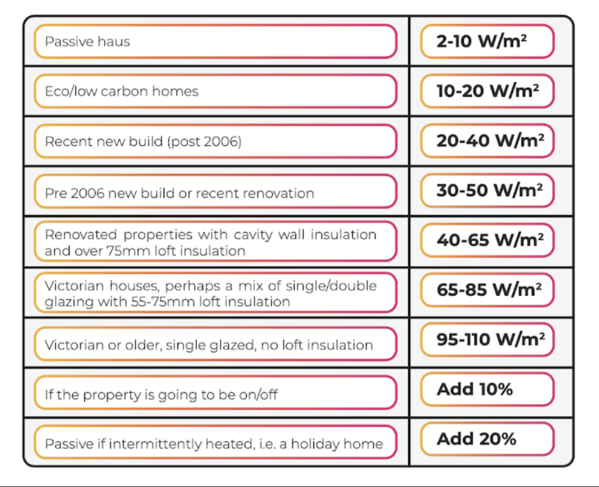

Sorry but there's absolutely no way you need a 30kW boiler in a house that size unless it has no insulation and single glazed sash windows with no draught proofing. It'll just be massively inefficient to run. You don't need a pump that size either - that pump is designed to push 60kW around a very high resistance system, and will cope with loads in excess of 200kW on lower resistance systems.
Here's a handy "quick check" guide to what size boiler you actually need...
30kW for a 200m² property is 150w/m² which is beyond the worst end of the chart
