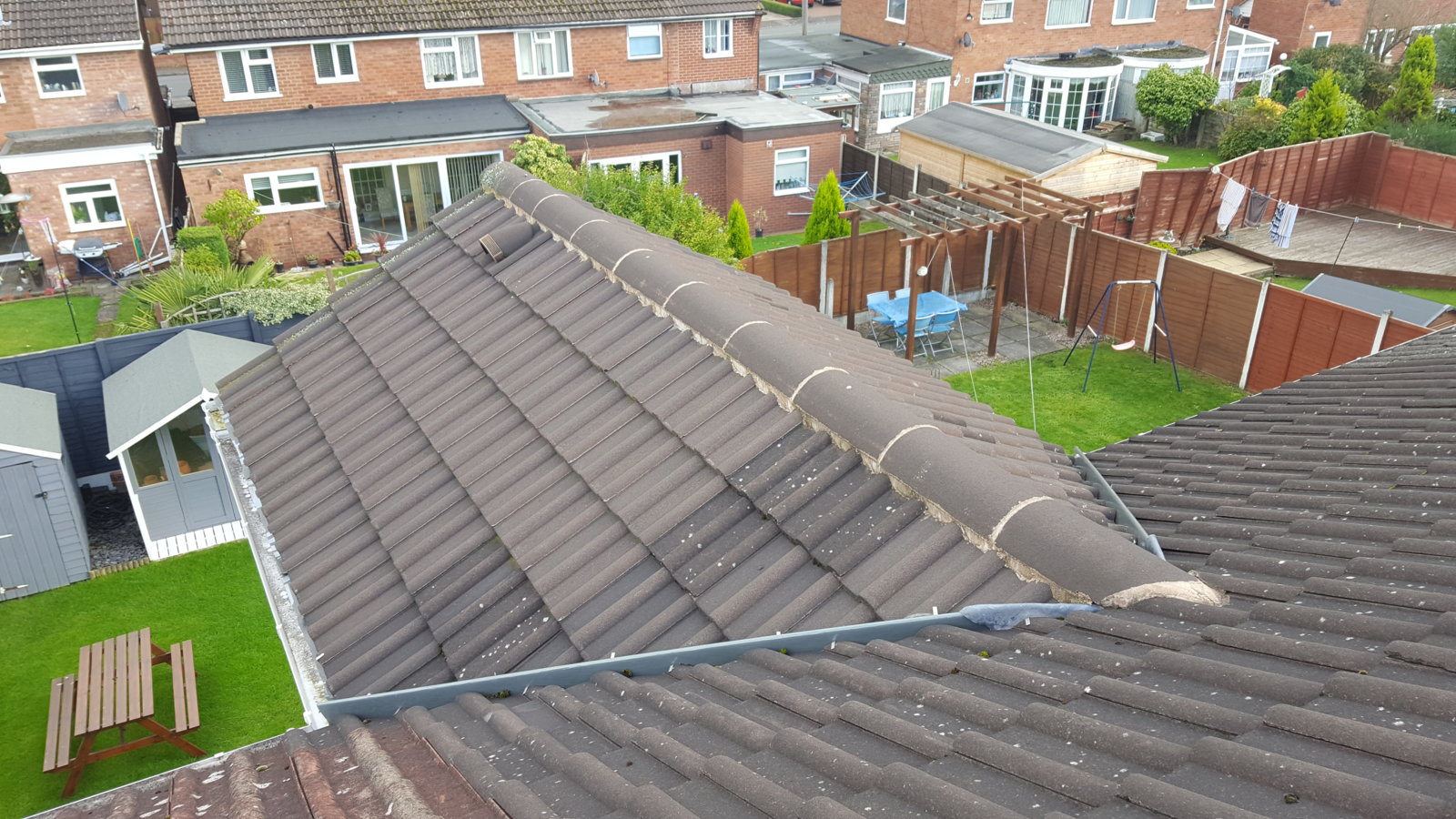

Valley help! Urgent

Thanks guys. I had to leave the valleys and concentrate on other bits so I am still looking into it. My main thing though is my valley isnt intended to go all the way down to the facia / gutter....
BC inspector had a look today and he happy with a 3 inch wide lead valley as it's only short so I'm good to get that done this weekend.
Also need along front of dormer etc overlapping tiles etc . All good.
