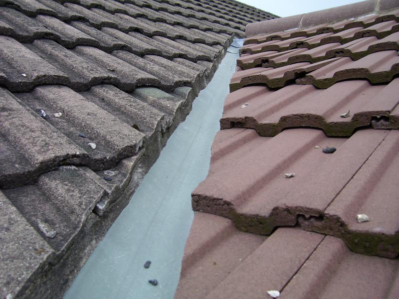

Hi, Im realy looking for some advice before I invite a roofer around as I don't want to get caught again.
I live in a terrace house and the house next door had a two story extension on the back. Almost 3 years ago I decided to do the same and I found out that next door had built right on the boundary line. Before I put the extension on I just had a single storey extension with a flat roof.
The builder I had said we had a problem as because I was so close to next door they had to install a valley between us. I said make sure that you brick up higher than my neighbours roof to ensure that no rain would drain into my home but they said this was not possible. They have installed a 'flat' valley between us and every winter it gets blocked and leaks through my kitchen - I have to getup onto the roof to clean it out. Can someone advise what type I should have as I'm getting quite old and don't want to climb up there for the rest of my life!
The vally is over 5m in lenght and made from lead.
Builders are usless - told me it's all they could have done and just said to keep cleaning it.
Sorry it's a long explanation I'll try an attach pictures if you need them.
Thankyou.

I'm not 100% sure what you mean when you say It's 4m long and has two joints. If you have a single piece of lead 4m long then that's too long, it will crack and leak with the expansion on such a lenght.
One thing , re reading your original post , Im not clear wheather you have a flat or pitched roofs as I can't see how the valley could be wholy on your side if they are pitched.
If you have flat roofs then it should have been possible to tie the roofs together to form one continous roof without the need for a valley. What is the covering if the roofs are flat, felt?
If the roofs are pitched then again the rafters are tied together with horizontal timbers to form you flat valley gutter.
If as you say the valley spans your two wall skins then it's possible that it is very narrow and will block easily with leaves and water is sucking up any joints.

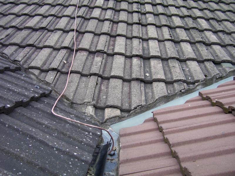

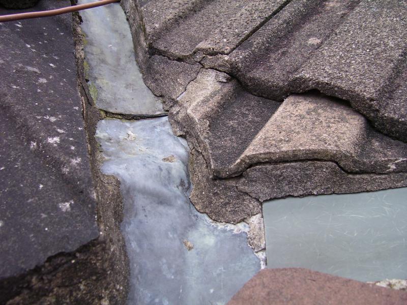

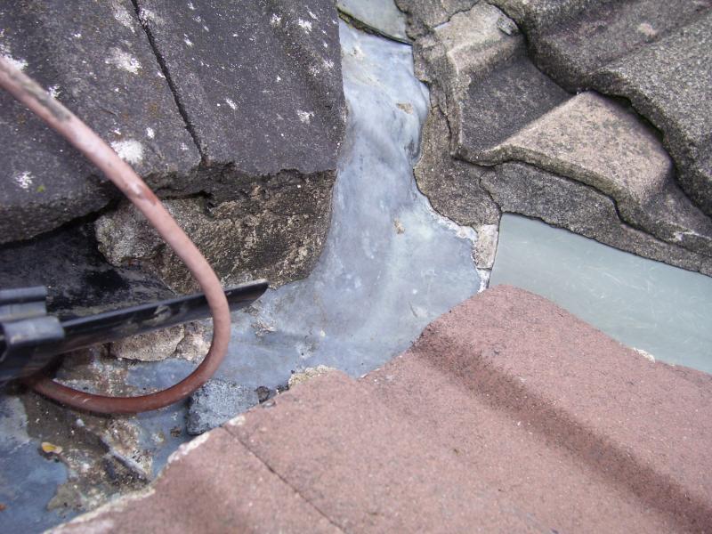

My house is the red tiled one. I think theleak happens where the valley's from the two main roofs meet - this is where al the dirt and devry keeps buliding.

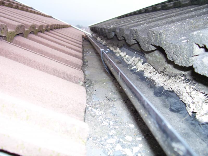

Where you can see my nieghbours gutter is where my extension ends so I think there is a max 3"/4" gap between us. That's why i wanted to go higher than them and have my own gutter above thiers - but thebuilders said this was not possible?

I have to disagree there, but only because I can't believe any proper builder would do a job like this. It's quite frankly an appalling mess!
Firstly one lenght of lead is wrong , it'll crack and split with the expansion.

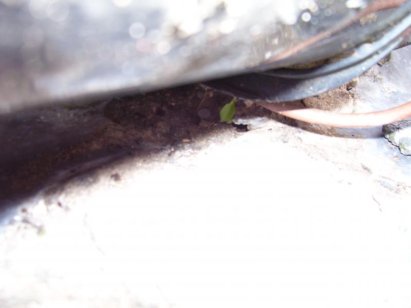

Secondly , how on earth has it been weathered onto your neighbours side? That plastic guttering shouldn't be there, the lead work should be sat onto a flat wooden "platform" or bay that is formed by fixing 3x2s to both yours and your neighbours rafters and boarding. These bays shouldn't really be over 2.5m in lenght and the joint between them is formed by raising the next bay (i.e. away from the downpipe end) upwards by 65mm minimum. This also makes the second bay wider and it will sit higher onto both roofs.
I'm also not impressed with how your tiles are sitting flat onto the lead either there's potential for capillary action to draw water into your roof.I'm also unclear what I'm looking at in the first picture, why can we see the edge of a tile? The whole thing is unfinished.
