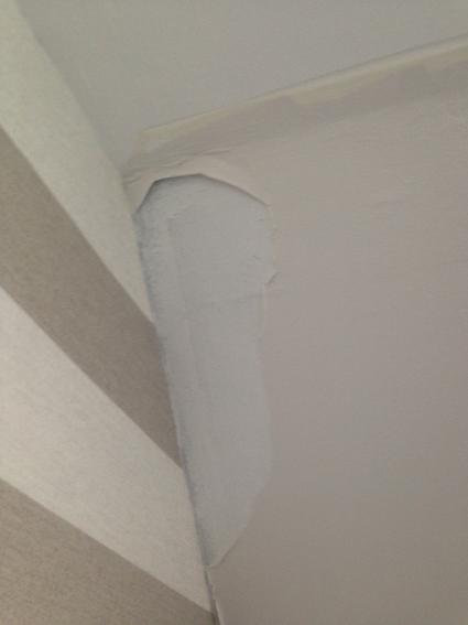

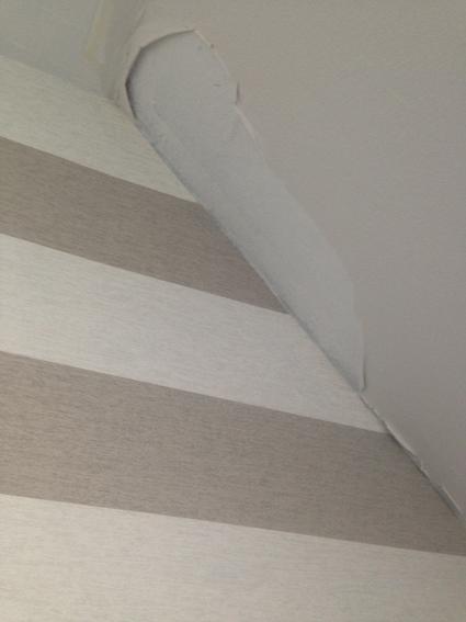

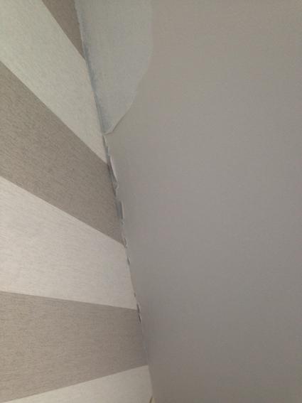

I have an issue with valspapaint which I purchased from my local B&Q. On completing painting a room and allowing the paint to dry over night I removed the masking tape on the edges and a large section of Paint peeled away from the wall. I have used you dulux and Crown and even B&Q own brand successfully in the past and use the same method of masking the edges. The section of valsparpaint the came off had a skin like stretchy texture. Has any one else had these problems? If so what did Valsparpaint do. They told me this was normal...

That maybe so, but that is still no explanation as to why the Valspar paint did not adhere to the wall. I usually use Masking tape and teh result are pretty good. I am a home DIY-er and have used that technique for years with various other paint brands and never had an elastic strip of paint peel away like that. btw the images posted above are all from the very first piece of masking tape I removed.
Also, you're far better off removing masking tape as soon as possible - you don't want to let the paint dry!
I quite agree. using masking tape can cause paint to stick to it and give slightly rough edges if left to dry as I did. But I don't think anyone would expect this quantity of paint to peel when removing masking tape, wet or dry.
As everyone else has said, masking tape isn't the ideal way to get a nice clean edge.
In the US (I've been learning lots about their paints lately), Valspar paint does have a bit of a reputation within the trade for being rubbery and peeling, like in your case, but it is usually the semi gloss version (our vinyl silk) that has the worst problems. This makes me wonder if it's silk that you have used?
That said, it usually boils down to the fact that the finish paint hasn't adhered to the underlying substrate for one of a number of reasons. After all, the silk emulsion is supposed to have a more rubbery consistency than the matt and satin versions.
Looking at your pictures, the white surface looks to be well adhered but is it a dry, powdery or greasy surface, or was it a mist coat that was still damp? As I mentioned above, there is usually a reason why the paint doesn't adhere and it could be for one of those reasons.
If its either of the matt or satin finishes then I'm surprised by how rubbery it appears. :confused:
