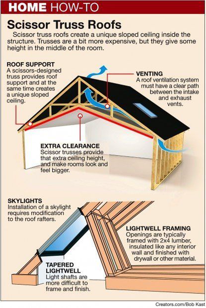

I'm part way through a 2 storey extension. The first floor is gonna be a bedroom and dressing room/en suite. Its basically a 4 meter wide by 7 meter long rectangle room that I'm gonna divide up with stud work.
I'm considering a vaulted ceiling....I've not ordered any trusses yet.
How much more work is involved in having a vaulted ceiling? Will it need to have the roof redesigned by the architect with calcs, or can I just use scissor trusses rather than standard fink trusses?

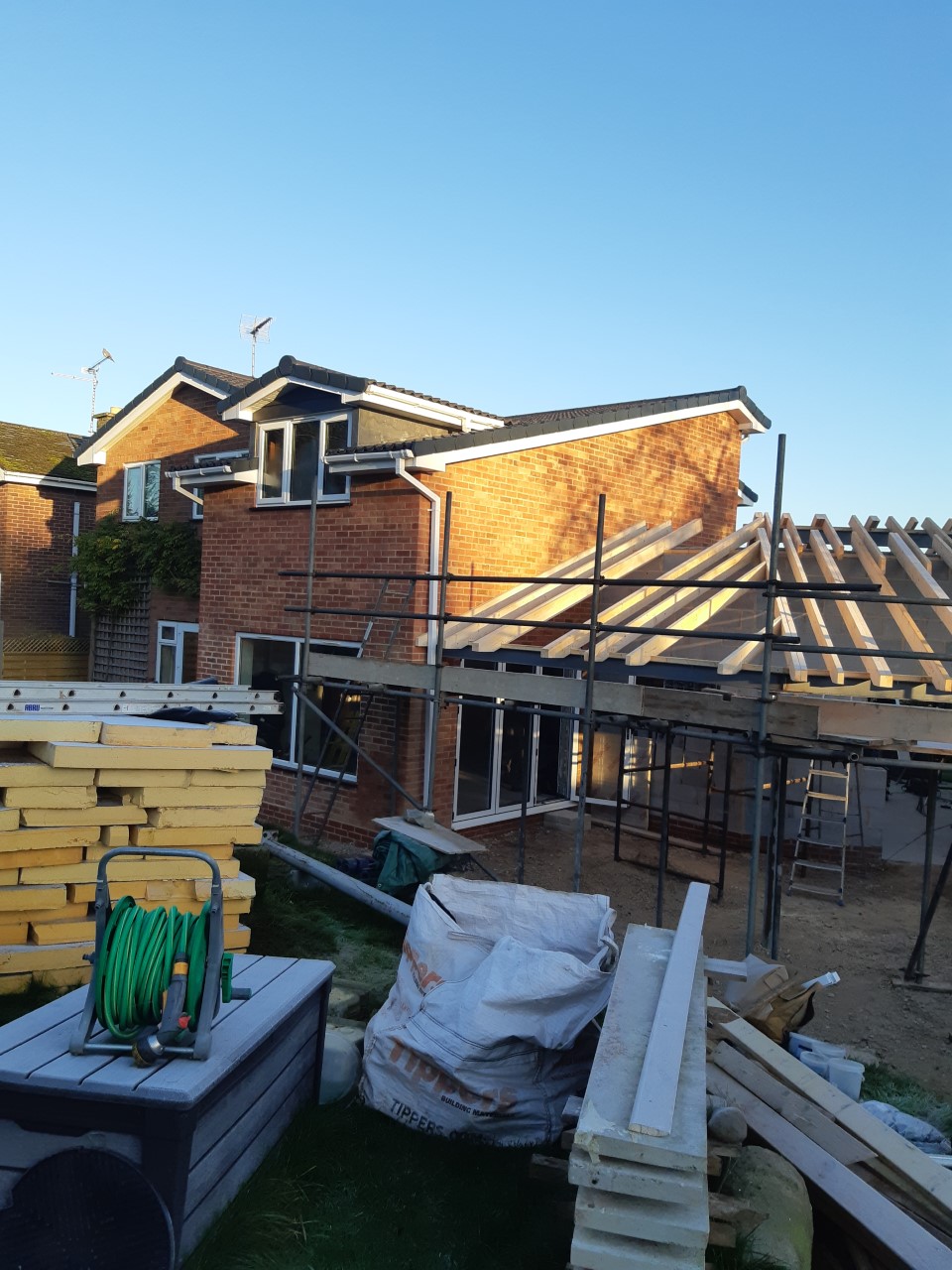

Massive. Its like night and day. It's also exactly what we have just done on our current job. The net difference between the two designs on ours was about £6'000. That was without SE fees. There is the time consuming and costly ceiling/insulation detail to consider also.
You will need to get an SE on board and build it as a cut roof complete with birds-mouths over the support beams etc. We managed to salvage the steels from the previous ground floor extension as it was on the same footprint...
He also requested a vaulted over the garage so that he could include a mezzanine in the tall copious space...
You can see the finished article (vaulted bedroom extension) in the above image complete with lead sided dormer.
Nose all, Out of curiosity Why are some of the rafters doubled up... is this for velux to go in?

A mate of mine had scissors trusses for an extension he had, 5x4m installation went pretty smooth.

The faff was fitting the bracing for wind etc, as access for trusses are not as easy as beams and rafters.
When I initially looked at it - being that its just a 3 sided box thats joining the existing gable wall - I thought surely i could just use scissor trusses instead of standard fink trusses - the idea being that the trusses are designed appropriately to be substitutes for standard finks. On that pic above, it appears that that is the case.
Yes.
Believe it or not, they only arrived yesterday and I spent the morning taking them on site. We'll be fitting them on Monday and finally (sigh) ridding the site of the scaffold.

The vaulted with the dormer over the bedroom was ok but tiling and weathering the bit where all the roofs converged (at the back left of the dormer) was an absolute fekkin nightmare. There was a huge concentration of work in a space where the rafter bottoms were virtually touching and where two valleys converged.
The garage was rather a challenge especially the steel (front and back). The rear 'covered area' roof steels land on a steel post. Because the building is cranked (another nightmare) locating the exact position and height of the post was very time consuming especially as they already had the post, so I had to work backwards.

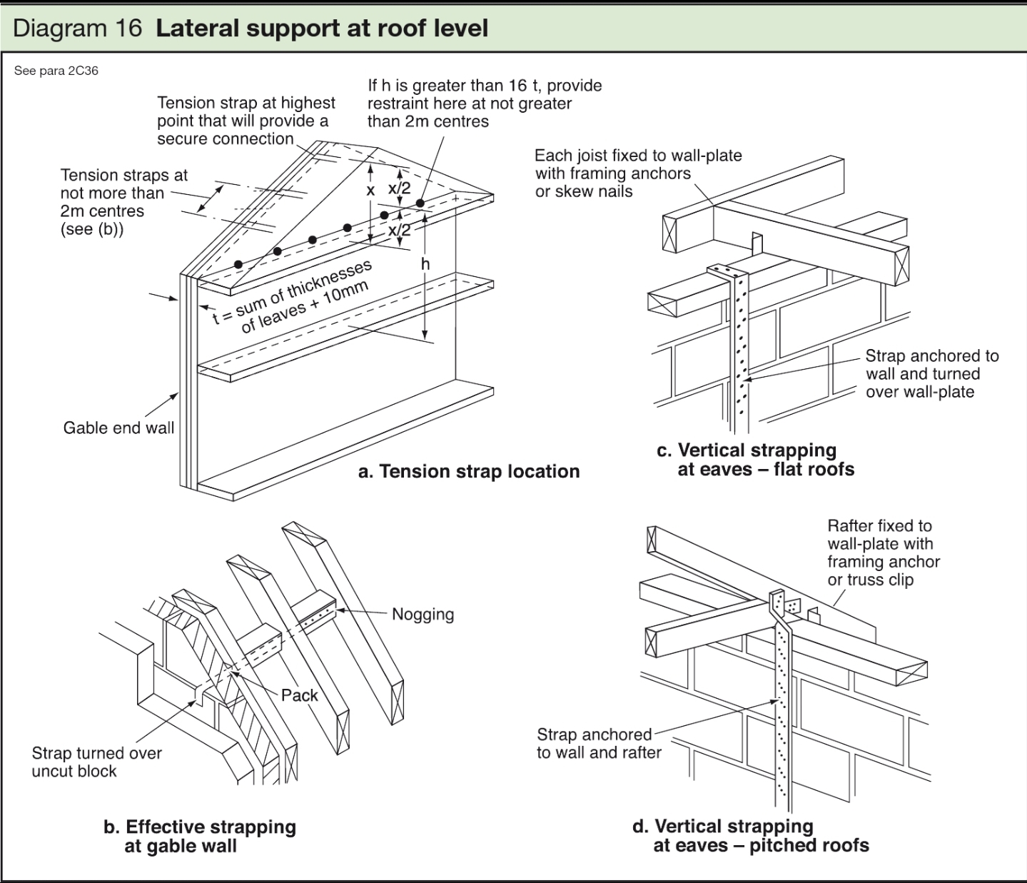

Just thought I'd put an update on this. My builder and my mate who's a private building inspector (previously worked for Trafford Council) both said its fine for me to just use scissor trusses in place of fink trusses because the truss company have produced the calcs and they're happy. But the building inspector who's acting on behalf of my local council has said it needs a windpost..... ie the idea is dead in the water because the gable wall is already built. He said he'd spoken to the engineers at the local council and they've said that the maximum height from 1st floor to ceiling is 2.7m. Apparently they use a calculation that takes two thirds of the thickness of the wall and multiply it by 16 to give a max ceiling height. In my case thats 132mm (2/3 of the 200mm wall thickness - they don't include the cavity void) times by 16.... which is 2.1m. He said this is lower than a normal 2.4m ceiling, but the regs allow this to be pushed to 2.7 meters. He still thinks it would need a post.
So..... I've been looking into this a bit further and was wondering if anyone could assist my understanding of the following diagram..... which is from approved document A and I believe is what the building inspector is referring to.....
At part A it details the requirements for extra restraint. It says that if h is greater than 16 x t, then restraint has to be added where the dots are. Now.... t = sum of thickness of leaves plus 10mm.... ie 210mm. So 16 times 210mm is 3360mm. So I'm wondering why I cant do what I want to do, provided the height below the highest point of the ceiling line is 3.36m.
And.... X is the height from the ceiling joists to the apex. And h is half X. So the above should only apply if I want to vault the ceiling above the halfway point of X. So if I only vault it to half of x, then surely that would be fine too. Either I'm missing something here (very likely) or the building inspector has got it wrong.

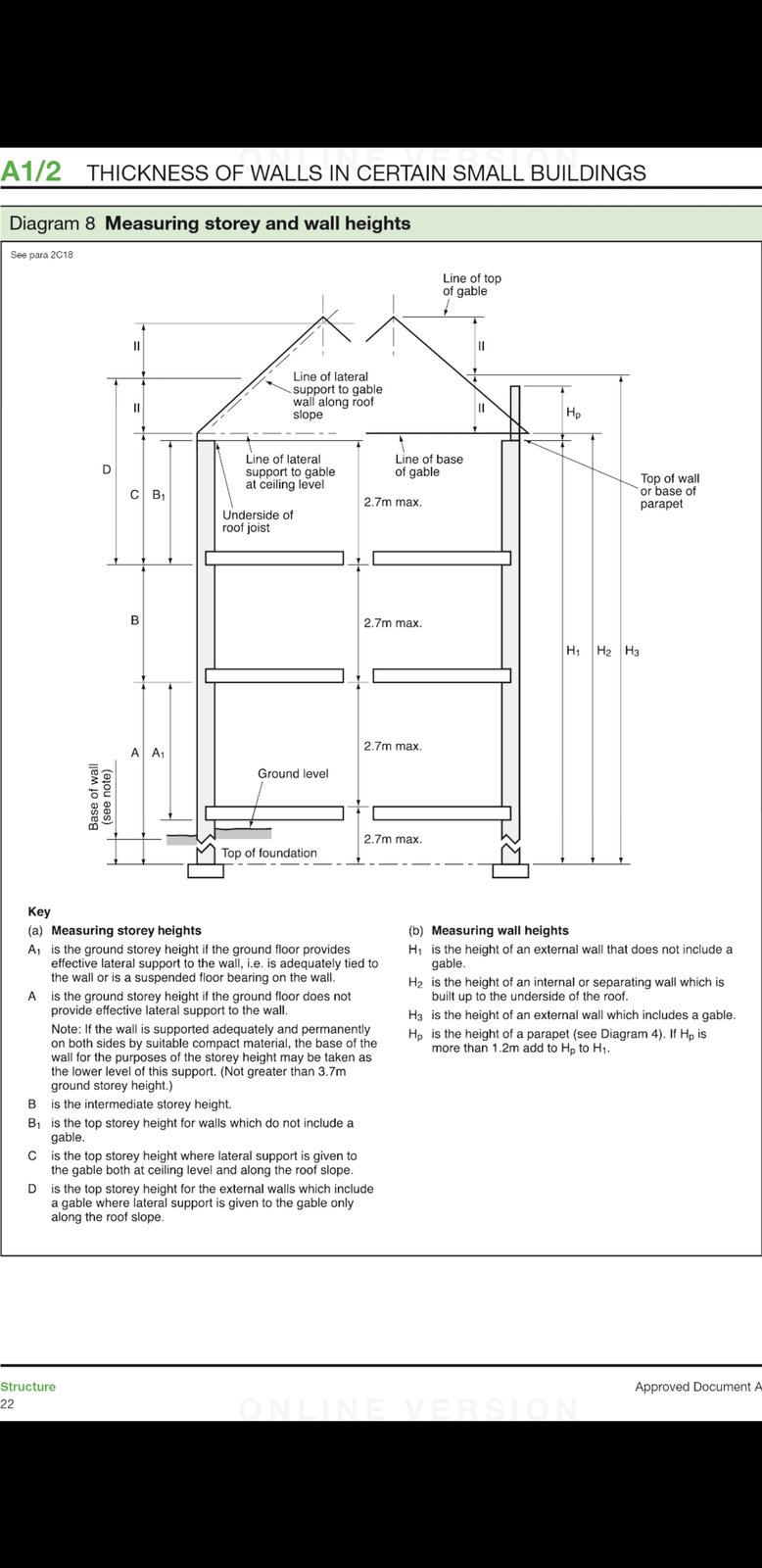

But..... there is another diagram (Diagram 6) that shows maximum storey heights....
I'm confused about point D and C in the above diagram.
