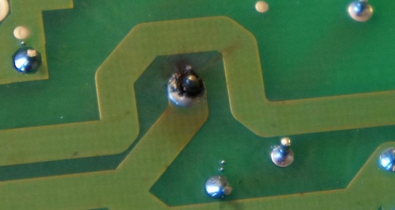

There is a common problem with the 1.7DTi (Y17DT/Y17DTL) which doesn't give any warning or symptoms, is commonly misdiagnosed, and can be fixed with a soldering iron and a tube of silicone sealant. :D

No, it's not a water ingress issue, it's a dry solder joint issue. Usually, it flags up a pump sensor or spill valve error code, which is a red herring, and can results in a garage wanting £1000 to replace the pump. Furthermore, the crank sensors on these protrude into the crankcase, so shouldn't get dirty (unless you really need an oil change!). If it was an immobiliser, you'd have flashing spanner lights I reckon, and no response from the starter.

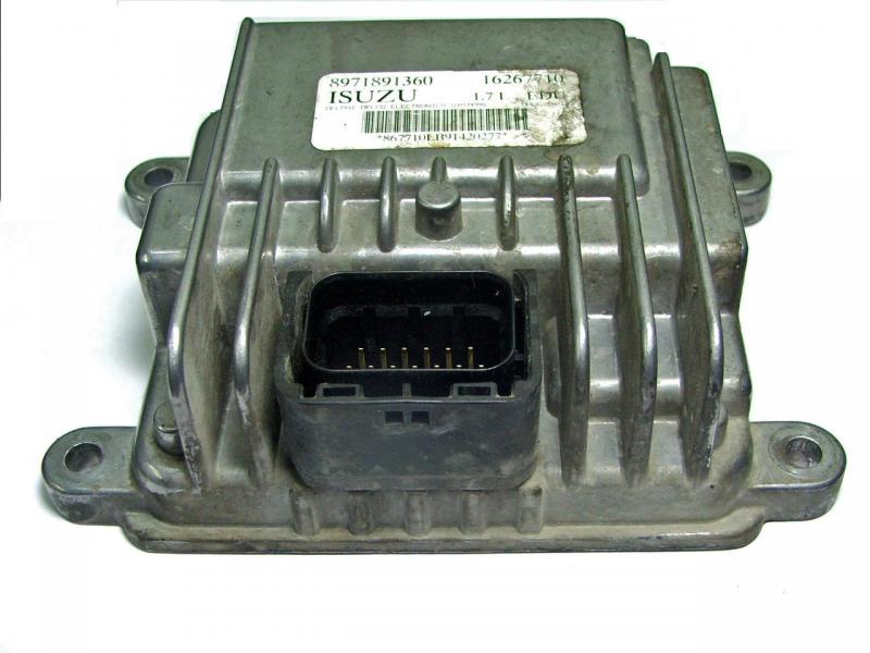

The problem is the 'interface' EDU (between pump and ECU) which sits at the back of the engine, and looks like this.
It can be accessed from underneath, and is fairly easy to take out and swap. A garage will probably charge about £300-£400 to swap it, or you can have a look at it yourself.

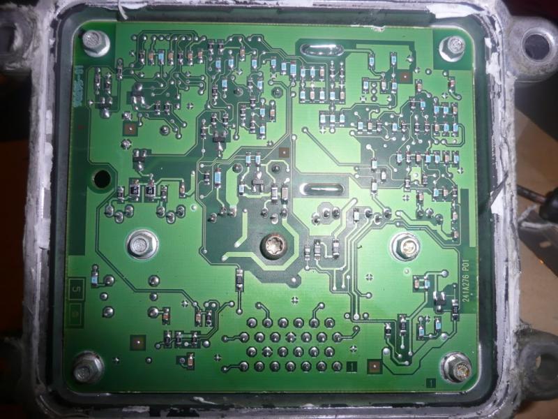

At the back, you can peel away the cover to reveal the PCB:

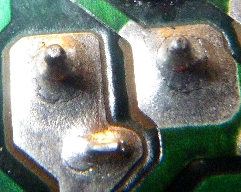

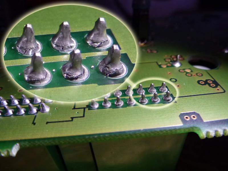

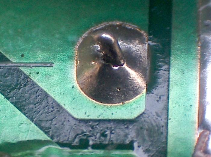

The common failures are dry joints on the components with legs, examples of which I've shown below
Yes, for a lot of them you have to look VERY carefully, as they're never as obvious as that last picture!

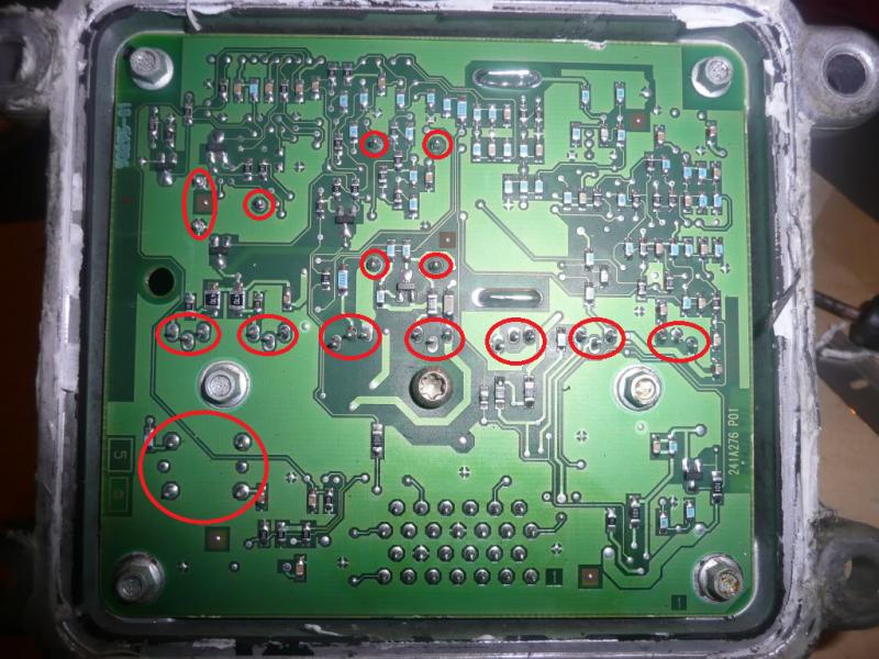

What I would suggest, and with the aid of the photo below, is dab some non-corrosive solder on them (Fry's fluxite is pretty mild) and then go at each with a 25W soldering iron or gun, held for a couple of seconds after the solder has melted.
The silicone is to seal the cover back on afterwards. That should fix the problem, or at least it did on my girlfriend's Corsa after it did the same thing after 150k, cost = £2 of silicone. Again, it was fine after it cooled down, but was dead again once we towed it home, so you're right not to trust it. My Astra did the same after 70k, but the garage fitted a new EDU that time.

I have took the ecu off, i had some trouble getting the back case off, when i did i looked for ages, it was all covered in waterproof jelly type solution. here was a bit of jelly that was squashed. It was right in one of the corners where there was 3 small metal splints going between two points. One looked broke off, it is broke off as i cleared the jelly a bit. Problem is, im wondering if i damaged it popping the plate off or if that is the problem. I will post a pic in a tic and would be grateful for feedback
Right, you have the wrong unit, the unit on top is fine, put it back and don't touch it again. I too have had the cover off those and yes they're filled with Jelly, but the one at the back of the engine, accessed from underneath, doesn't. It also looks like the one in the photo, with only one connector. The cover also seemed to come off a lot easier on those.
AA won't really have an intimate knowledge of every car, so won't know what/if an EDU is. But if you have it up on axle stands all will become a lot clearer.
If you want to put a picture online of the ECU, then use the 'upload pictures' link at the top of the thread and add some photos to a new album. Generally speaking though, if the tracks are still intact, you'll be OK. You'd be unlucky to damage any of the tracks with a single pass of the stanley knife. A dented solder joint won't hurt either, just be sure it's not now tracking across to it's neighbour. Otherwise put it back and get the right unit out.
