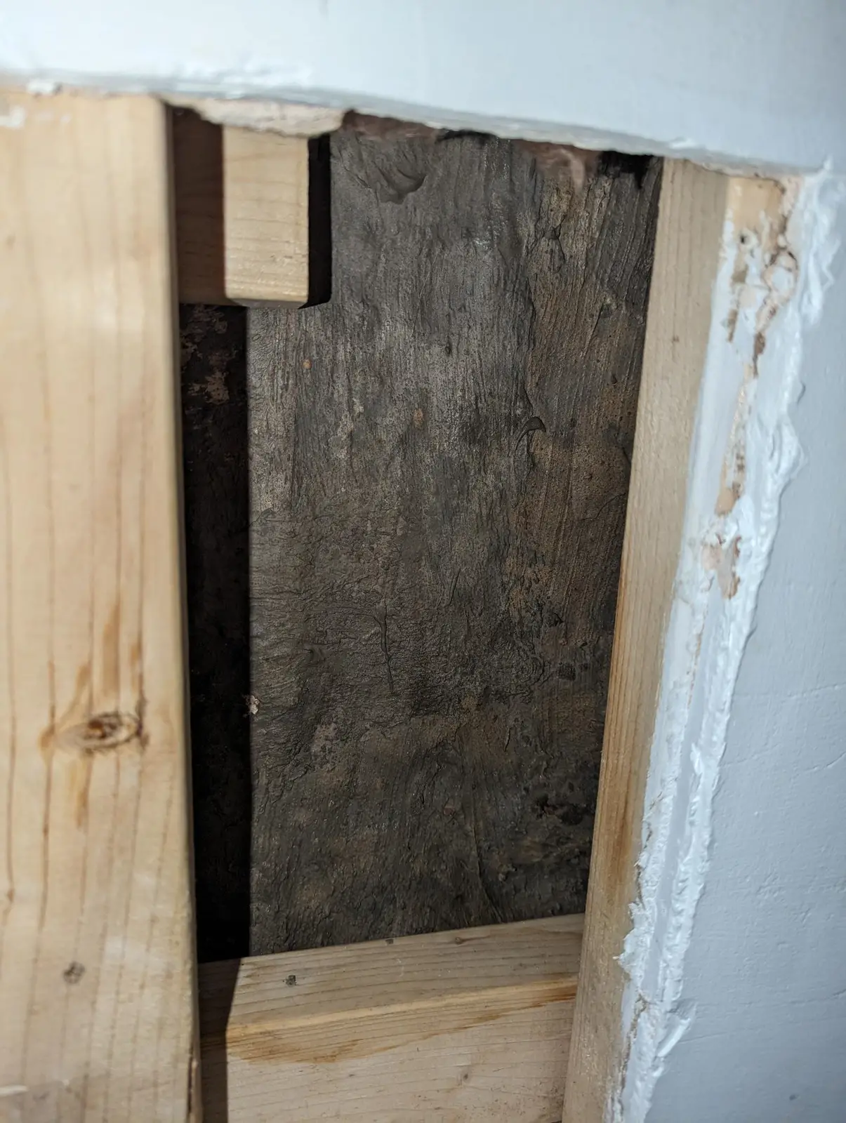

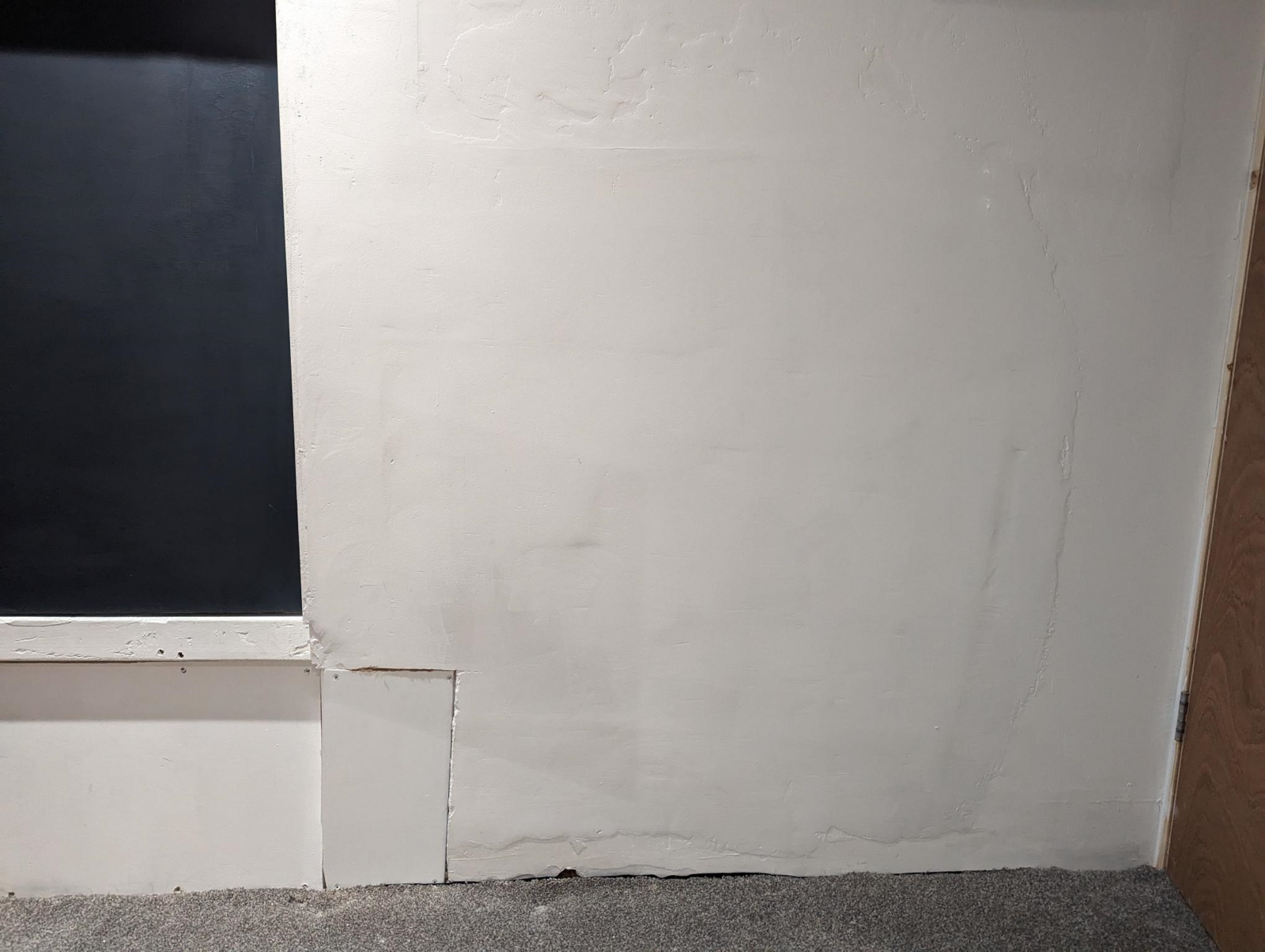

I have a converted cellar, was done in 2020 well before we bought the house but a bit of a DIY job so hasn't had the full waterproof treatment etc. Unfortunately when we moved in July 2022 we had our washing machine leak in the cellar which required me to cut a small hole in the drywall, as seen below, to dry the internal wall and replace the wet insulation. I never got round to skimming the wall to make the cut piece blend in and sort out the rest of the wall as it was behind a cabinet so was not visible.
I got round to starting this week and took the panel and insulation out and noticed the tanked wall behind was moist. Think it is condensation and not a leak or penetrating damp as does not happen further up or lower down the wall and does not seem to drip. I don't think it will ever get to the point it gets so wet it drips down the wall and may just be summer condensation that is causing the issue but how best can I deal with the issue or if it is not causing an issue do I just leave it and keep and eye on the wall for signs of damp/ moisture? At the moment there is no other signs of mold/ dampness in the cellar and don't really want to get an extractor put in as worried that this may cause more issues than it solves. There is a very small window in the cellar and an air brick on the opposite wall.

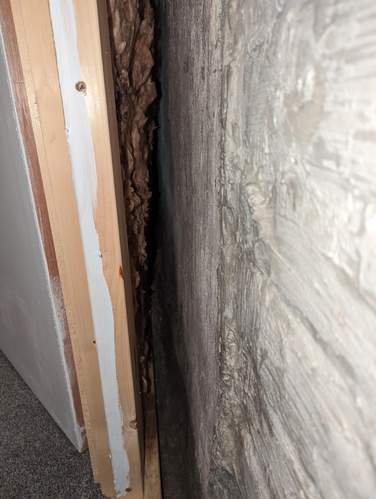

I have tried to push insulation onto the wall to stop warm air contacting the cold wall. It did slow down how quickly the wall got wet but the wall was still getting wet and insulation becoming wet so I removed the insulation off the wall today.
I cannot seal off the wall fully to try and stop air circulation as the cavity wall ends in a small utility room in the cellar which has an open side, as seen in the pictures, as I need access to the water stop tap etc. It does not have a vapour barrier on the other side of the dry wall and without removing the entire wall I wouldn't be able to put one in.
Would adding an air vent onto the cut out section directly in front of the wet part help dry the wall out or would that just introduce further warm air and cause further condensation?
Agreed but how do I ventilate an insulated cavity wall? I can't put air bricks in as the entire cellar is under the ground apart from 1 very small window. I could put an air vent at the bottom and top of the plasterboard where the wall is wet but it would only vent into the main room and not outside so not sure if it would solve the issue or not?
The rest of the wall is bone dry, probably because most of it is not tanked, but I am unable to ventilate the area sufficiently due to the layout to help stop this condensation. As the area in question is only small, just bigger than the cut out piece, would spraying insulation foam directly onto the affected part stop this condensation forming on this small area?
I have one part of an original wall behind plasterboard which is becoming wet due to condensation as you can see by the below picture. The rest of the wall is bone dry, probably because most of it is not tanked, but I am unable to ventilate the area sufficiently due to the layout to help stop this condensation. As the area in question is only small, just bigger than the cut out piece, would spraying insulation foam directly onto the affected part stop this condensation forming on this small area?
I have one part of an original wall behind plasterboard in a converted cellar which is becoming wet due to condensation as you can see by the below picture, the wall had just been wiped so not currently wet. The rest of the wall is bone dry, probably because most of it is not tanked, but I am unable to ventilate the area sufficiently due to the layout to help stop this condensation. As the area in question is only small, just bigger than the cut out piece, would spraying insulation foam directly onto the affected part stop this condensation forming on this small area by stopping air flow to that part of the wall?
