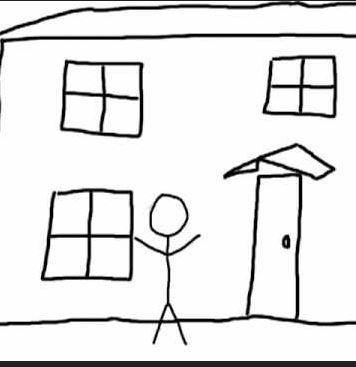

I'll 'acquire' some planning software and upload layout.. may take a little while for me to work out how to use it though.. will post back once I have done so :)
It's a bit like this... but I haven't got a porch..

You do look very warm in that picture but at the same time you roof vent do appear to be working
