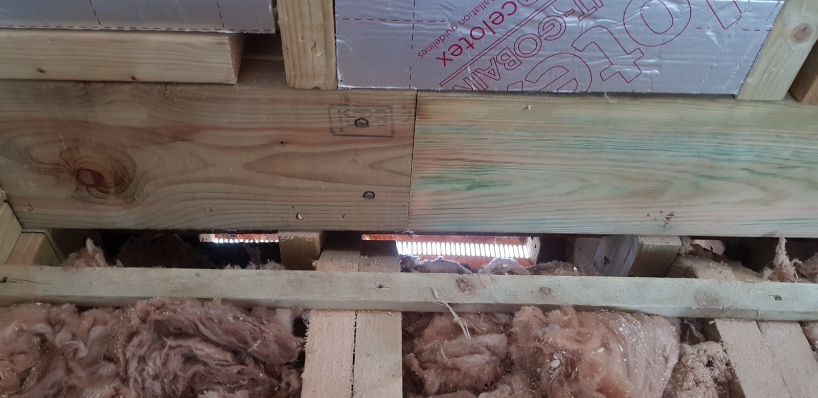

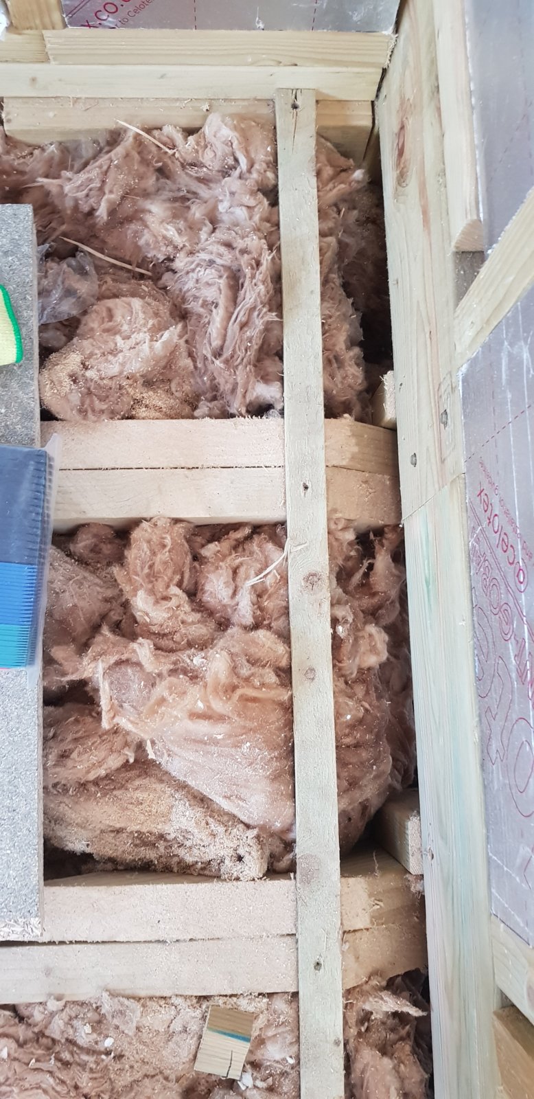

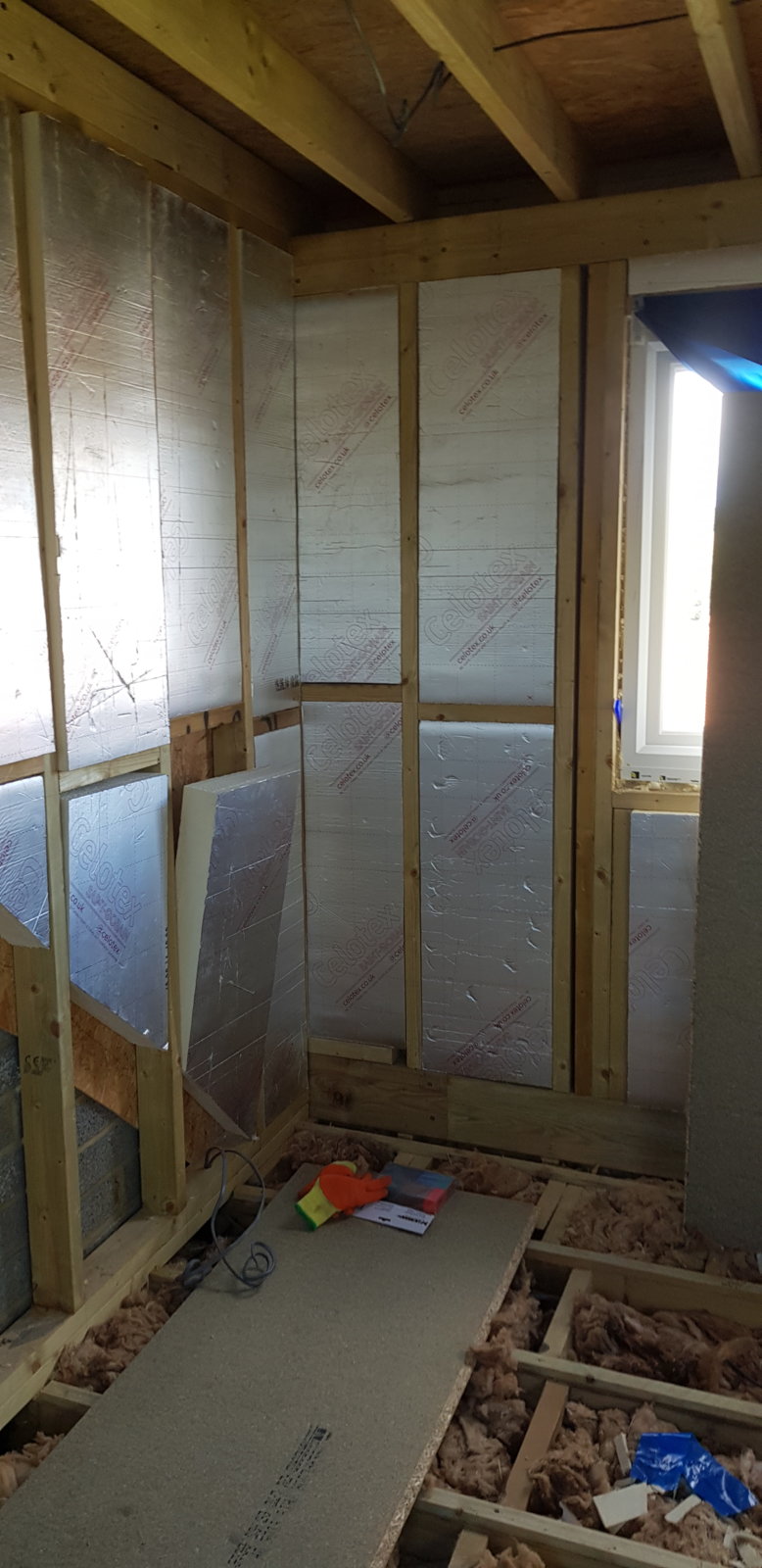

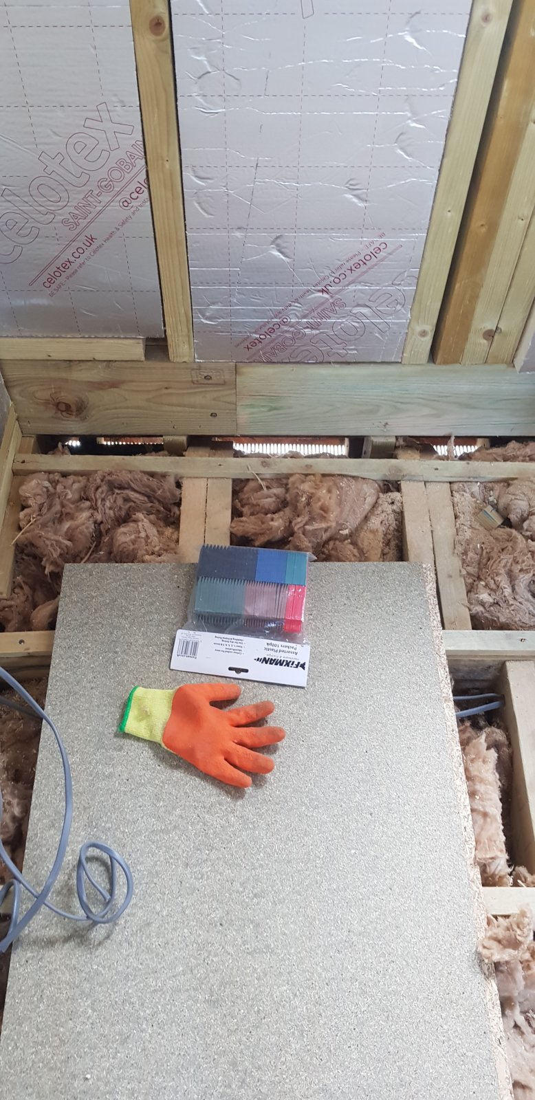

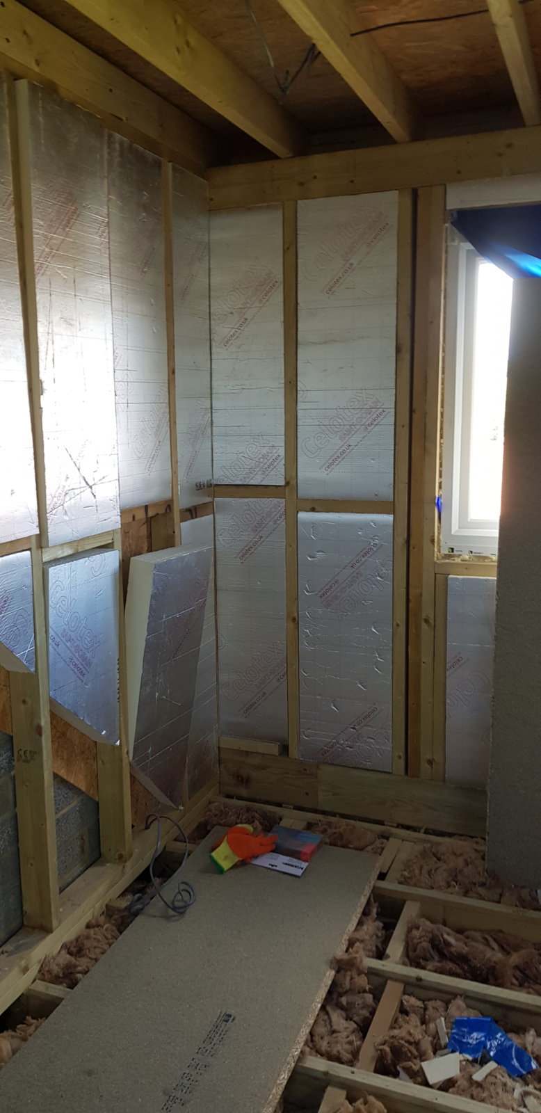

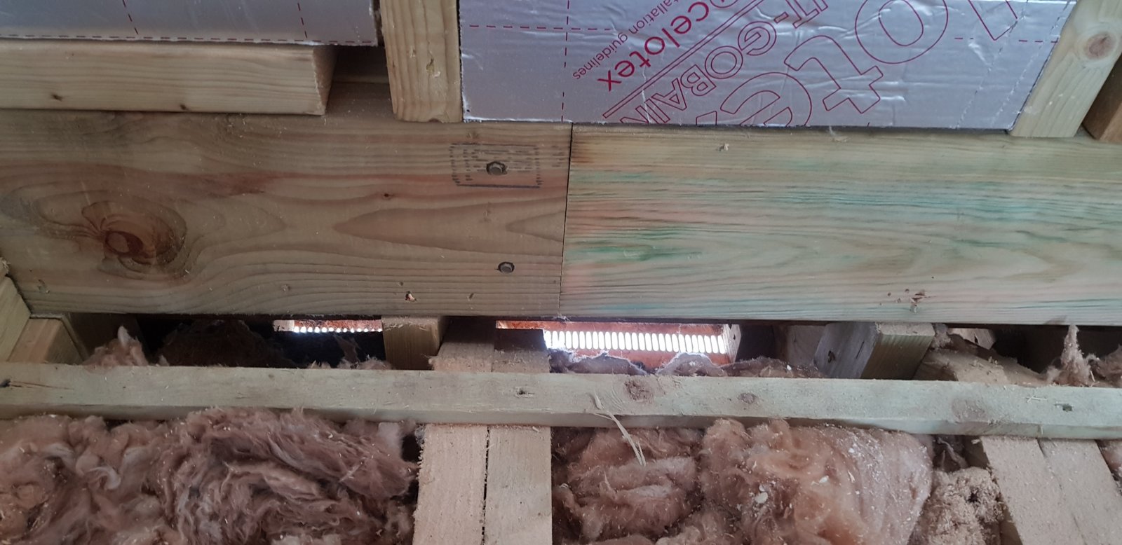

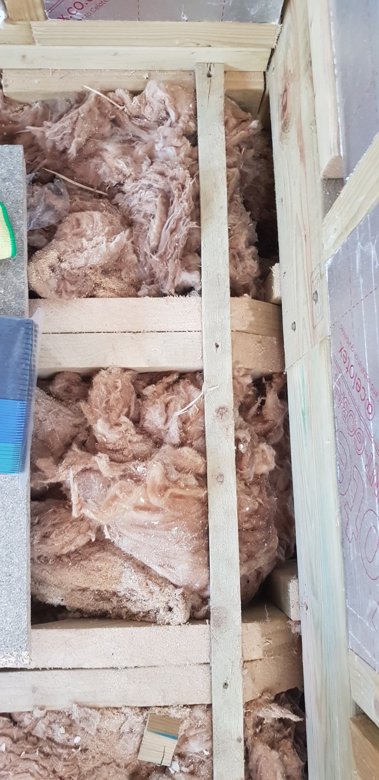

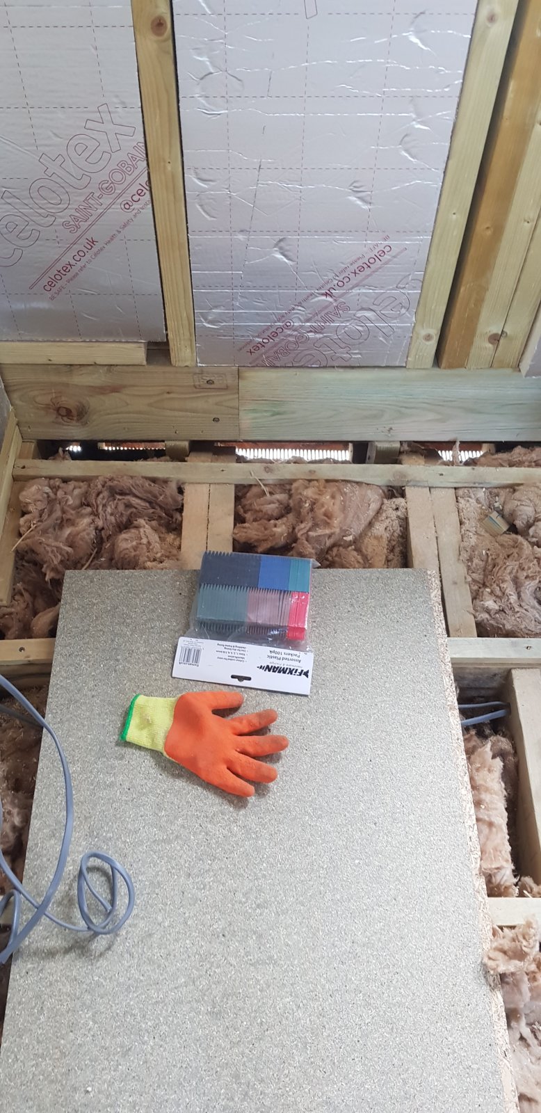

I am about to lay T&G floorboards down for my hip to gable loft conversion with rear dormer and not sure how far I should push the floor insulation roll into the edges of the dormer and eaves?
Read conflicting views when I googled and searched this forum, I can only assume that's because each case is different (ie. Old houses vs new).
My house is only 3 yeears old, the loft walls will have 90mm Celotex, whilst dormer flat roof and pitched roof will have 120mm + 25mm Celotex laid over. Cold roof structure
I've attached an image of what I think is correct - leaving a gap to allow for ventilation. Is this correctoor is there too much gap? I'll be gluing the floorboards down so no room for error really

There is no benefit of the cooler air getting anywhere near the internal floor space. If it is assisting external ventilation then you need to fit a solid plug of Celotex directly below the beam and seal with foil tape or foam.
