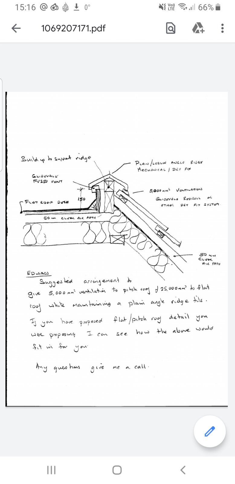

BCO have just sent this drawing, forwarded from Glidevale, and advised this is the solution with the FV250 vents.
Basically that vent will be fitted to the top of the ridge, and an opening made on the inside to allow air to reach the vent, which will then be sealed with lead flashing.
Works in theory if done correctly but a lot of extra work, especially if scaffolding is needed...
