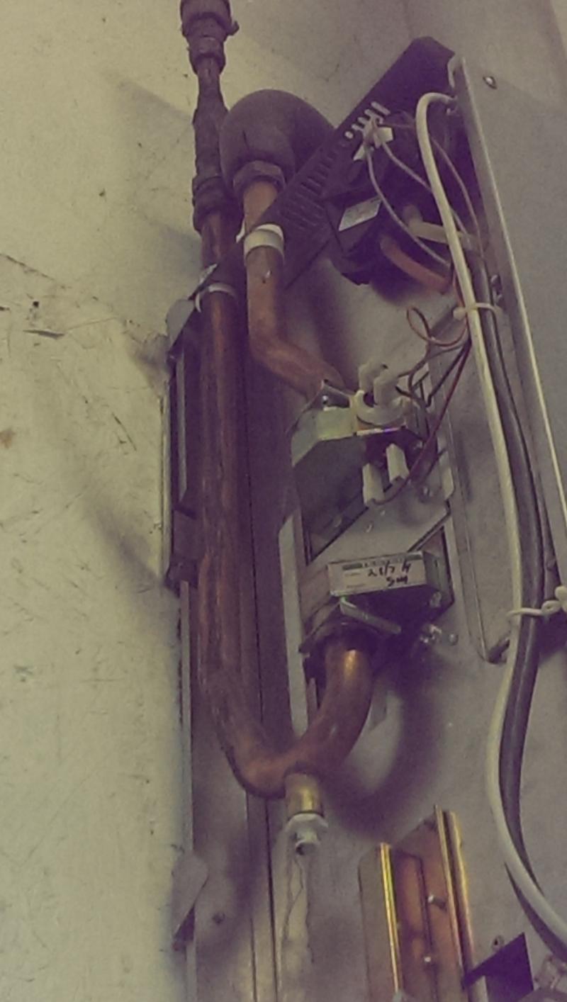

Vertical valve fitted on the return pipe of my 24CBi boiler
8 Feb 2015
6
Middlesex
Can someone tell me what the vertical valve is likely to be that is fitted on the return pipe on my Bosch 24CBi boiler?
The pipework enters the boiler from above and the pipework T's to go down to the return connection on the boiler and up to what looks like a valve of some sort.
I noticed this afternoon that this valve appears to have been leaking pretty significantly at some point over the last 24hrs.
The heating and hot water seems to be working as it always does and there is no current leaking but there is a green mark down the pipework as though it has leaked and the area below the boiler is really quite wet.
I didn't notice the wet area yesterday when I was in that area.
Any pointers as to what this valve is and what might cause a leak would be gratefully received.

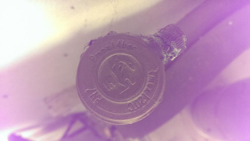

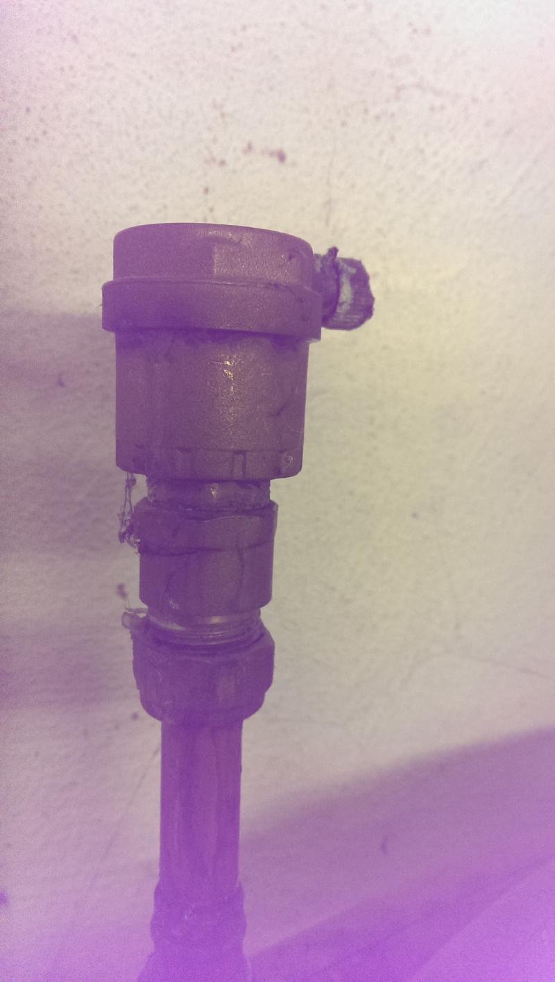

Can anyone point me in the right direction from these photos
As I mentioned in a previous post, there seems to be quite a variation in price - is this largely siren to the max pressure they deal with? (It looks like this one is Pmax 14bar and is that max temperature 120C?)
-FM
Any old 1/2 auto air vent will fit but I'd ditch it and fit a manual air vent...this sort of thing...

Regarding the valve, are there disadvantages to the auto valves, or is it just an expense thing?
-FM
Auto vents always leak or block up and IMHO are a waste of time. If they leak and it's not noticed they can do considerable damage.
Presumerably the flow and return pipes drop down from the boiler (but why they didn't jut rotate the pipes in the first place is a mystery). If you had a leak on the system air could be drawn in through the vent...another reason to ditch it.
